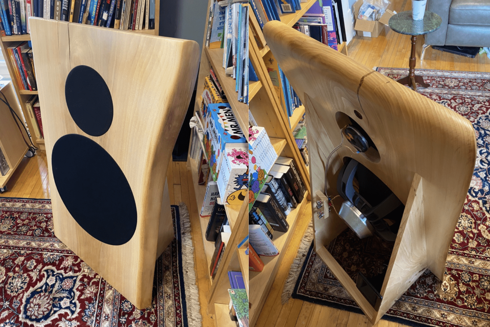

I'm guessing that to jaded OB fanatics the flanagangsters might sound a little boxy. But since only the bottom 1.5 octaves are reflex and the rest is dipole, they sound overwhelmingly like dipoles.
Also - this is pure conjecture on my part - a possible explanation is these are high efficiency snappy woofers with 5mm xmax, and the DSP is carefully sculpted to squeeze every last drop out of the available excursion, with a steep shelf filter below 35Hz, in contrast to what is usually a heavy, rubber surround, low efficiency woofer which often have great specs but sound "thumpy" and not that musical.
I have a pair of 12" Dayton Titanic subs (heavy cones, rubber surrounds, 19mm xmax, 2nd category I just described) in the corners of my room. Small sealed boxes, heavily EQ'd. I have them fitted with accelerometers and motional feedback circuits (using hardware from https://piratelogic.nl/) so they are easily made to go down to 10-15Hz. I have used them with quite a few different OB designs (www.perrymarshall.info/speakers - you can see a whole list with descriptions).
Impressions:
In broad strokes they sound great. I cross them over between 30-60Hz depending on what the satellite speakers are. I have them crossed over to the Bitches Brews at 35Hz at the moment (no high pass on the Bitches Brews, just the stock curve) and you can't tell there are separate subs.
For the Cottonwood Dipoles, I crossed them at 60Hz. If you listen very closely the subs DO sound boxy, there is a slight mismatch between the low bass and the low-mid bass. Only an audiophile would notice. But we're all audiophiles.
My friend Tom Perazella who's written AX articles about multiple sub placement says the problem is not the monopole, he says the problem is the corner placement which he says turns out to be the worst. He says if they were positioned closer to the midpoint of one wall they would sound better.
My room is not conducive to that so I haven't tried it.
If you're a "deep deep bass head" then obviously OB isn't the ideal sub-subwoofer for you, so I think you can cross over to something like the Cottonwood Dipoles at 50-65 Hz, photo below; or the Live Edge Dipoles at 40-45 Hz, and end up pretty happy. Personally I think the trick is the crossover. I would make the acoustic high pass slope of the subs no steeper than 12dB per octave; 6dB if you can manage. (It's counterintuitive but the steeper the slope, the more audible the subwoofer is in my opinion) and I would pay very close attention, experimenting with timing and phase of the satellites relative to the subs.
Impressions:

Thanks for those responses! Particularly interesting is the suggestion to cross over the subs with a very shallow slope. When monopole and dipole subs overlap on the same frequencies, do you tend to get the best of both, the worst of both, or... what happens?
I noticed that you'd done some work with an accelerometer-based servo sub. I believe the Rhythmik amps, when paired with the Rhythmik or GR Research drivers with sensing coils, are position-based and can effectively force the drivers to act differently than their passive parameters. The amps have 2 flavors, OB and monopole. I'm guessing these could mate up well with e.g. the Cottonwoods, as you suggested.
Btw, I've found your comments on the different sounds of materials quite intriguing. In case it's of interest, the GR 12" has a high excursion treated paper cone with the servo coil, and Rhythmik has an 8" paper cone model as well. (I have zero affiliation to either--just looking for deep bass pairing options that might tonally blend well). Building on your bass reflex idea, could a sealed servo sub be integrated into one of your living edge dipoles, especially for those who would have a hard time putting additional speaker/sub placements in a room?
Sure, if you wanted to make the Cottonwood dipoles a foot taller and put a small acoustic suspension box and 2nd woofer on the bottom, that would certainly work. Not terribly different than the Flanagangsters that you see in this thread. Also, you could run a motional feedback subwoofer in a dipole configuration.
The Flanagangsters seems like a great design. I noticed you used the SB Acoustics TN29BNWG Beryllium waveguide tweeter in the live edge beryllium dipoles. I'd like to use the new woofer configuration you invented in the Flanagangsters, but I also want to use the TN29BNWG. Since you have experience working with the drivers, is substituting the tweeter into the Flanagangsters or modifying the live edge berylliums for the new two woofer configuration using the Lavoce woofers the way to go? TIA
The TN29BNWG is far superior to the TW034X0 and I unhesitatingly recommend it. (Much more $ too). You can certainly use it on the Flanagangsters.
If I had to pick between Cottonwood Dipoles vs Flanagangsters with TN29BNWG I’d pick the latter. Much higher low end output capability.
