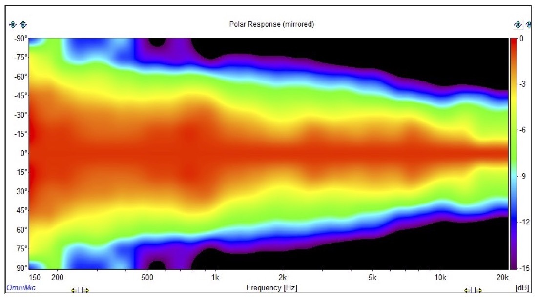

Well it also turns out that if you choose the right horn expansion profile you get Constant Directivity, which basically looks like this:
This of course is the Bitches Brew polar heat map, and everything above 1100Hz is the radiation pattern of the Constant Directivity horn formed by the aperture and the cone.
It turns out that Constant Directivity profile is a huge advantage for stereo imaging because as you move off axis, the level drops evenly and tilts slightly down so if you toe the speakers in, every seat in the house is great. Compare this to a more typical plot that I grabbed off the internet:

Many 2 way speakers advertised as "CD" have no directivity at all below 500Hz and increasing directivity above that. Do those count as CD?

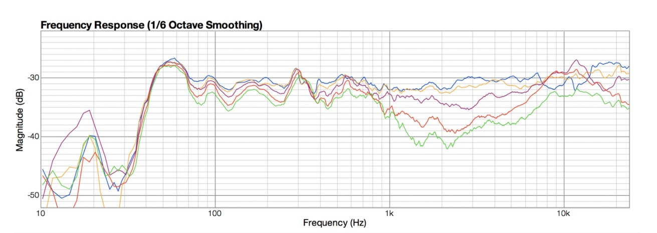

Is it reasonable to label the Faitals as CD given that their directivity also extends below 100Hz?
At 75 degrees off axis the drop in SPL ranges from 5-10dB, up to 6KHz. Above 6K the pattern widens. I published the data for all to see. I acknowledge that it's far from perfect.
How would you categorize it?
I would call it simply "chaotic directivity" design. Just look at that rollercoaster polar response from about 1 kHz up to 20 kHz. The directivity below 1 kHz is constant-like, but have way too wide dispersion compared to the upper midrange-lower treble region and it becomes very wide (too wide, chaotic, diffracted) again from around 6-7 kHz.

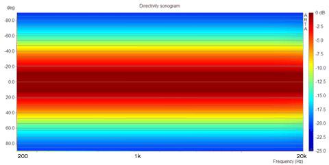

Is there actually a generally understood definition of what constitutes Constant Directivity?
Constant directivity speaker is that which exhibit the same spectral balance to all directions. In real world, it's not easy to create such a speaker from 20 Hz to 20 kHz, hence the more similar the off-axis responses to the on-axis response the more we can call it constant directivity. That's my defiintion, although maybe wrong.
