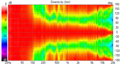

Crossing monopole and dipole woofers (and getting cardioid response around transition) is nothing new. To my knowledge Jorma Salmi of Gradient introduced it in his Gradient 1.2 model and successors. I copied this in my AINOgradients.
John Kreskowsky tells more about this here http://musicanddesign.speakerdesign.net/craw_cross.html

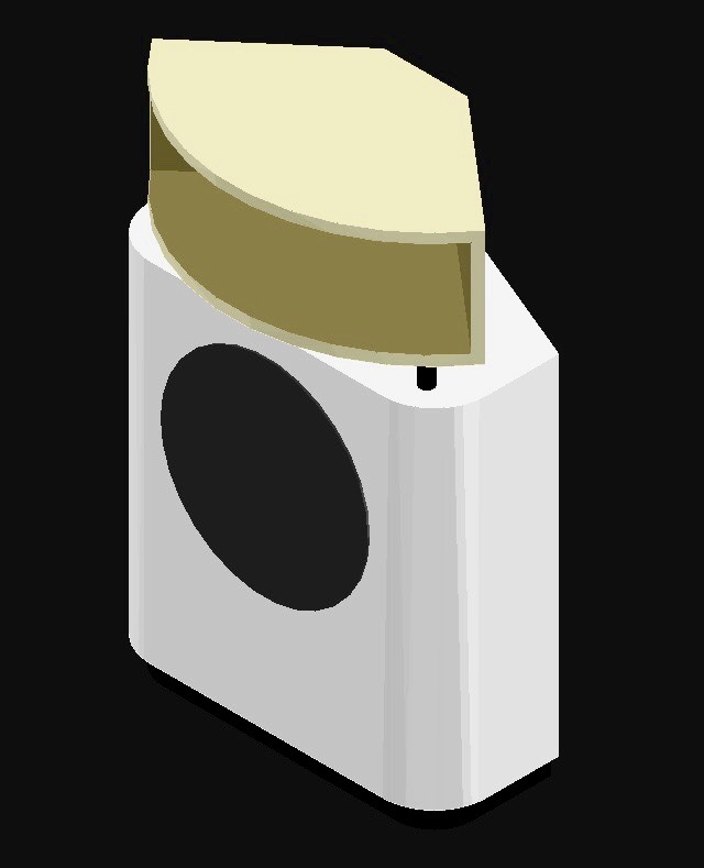

The new open-baffle midsection would retain the 4" radius quarter-rounds, and might have little winglets for structural and visual reasons, but the LF/MF crossover would still fall in the 600 to 800 Hz region, and overall system design would be quite similar. I could save a bit of expense by reserving the Alnico woofer for the upper section, and select a much cheaper ceramic magnet 416 for the closed box (the two versions are otherwise the same).
Here's a drawing of what I have so far, and how an OB midsection might be easily added to it, between the bass bin and the wood horn. From preliminary calculations on a bass bin with less height but more depth (but the same 26" width), the overall system would gain another 8" of height, to accommodate the stacked 16" frames of the GPA/Altec 416 drivers.
Overall sounds like an excellent strategy. I get the basic idea of the 416’s, but I’m not intimately familiar with the history. It doesn’t seem like a driver designed for acoustic suspension and I would be inclined to think that for a subwoofer, a lot of other drivers would be better. What do the Great Plains drivers do that other units don’t?

I'm not sure what to call your new design ... it's very close to a classical 2-way, and not like the bandsplitting of a 3-way at all. Nor is it like a 2.5 way, with bass augmentation for a midbass driver that's come up a bit short in the depth and power department.
It changes the basic character of the midbass driver, freeing it from box coloration, while retaining its power where it matters, below 100 Hz. That's a big deal, a really big deal. And the choice of identical drivers for the entire bass range gets away from the challenging task of tone-matching dissimilar drivers, which is the downfall of so many 3-way systems. Many 3-ways suffer from disjointed sound as playback level is changed. They sound great from 70 to 85 dB average SPL, but come apart above and below that. A good 2-way can get around that, if dynamic range is sufficient.
