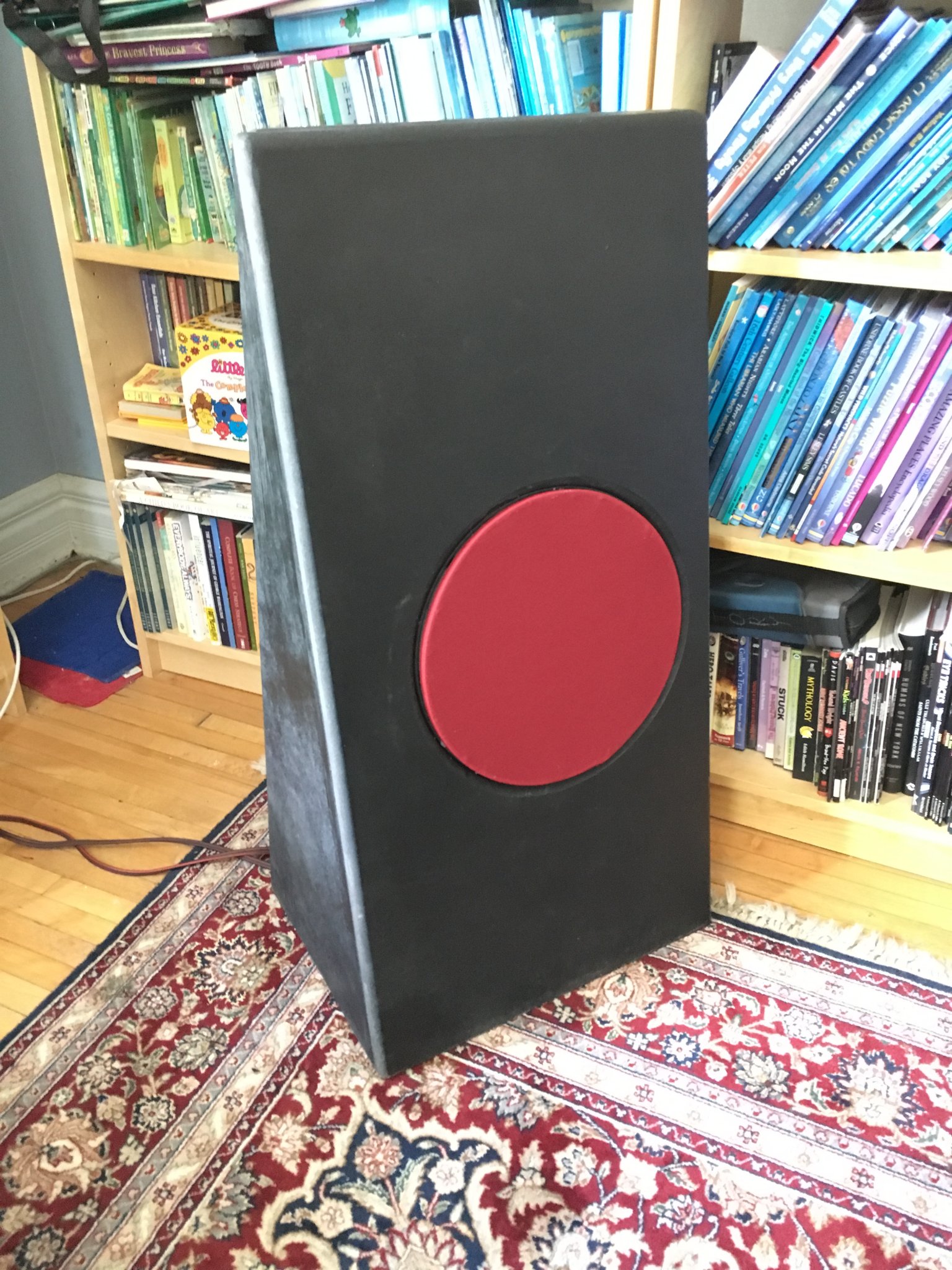

I had Seth Cothron at @studio38designs make them. He did all the woodwork, and a lot of it was done with a CNC. I don't know granular details.Were you able to use a regular router etc or did it require using something more serious.
Awesome. This is very helpful.I had Seth Cothron at @studio38designs make them. He did all the woodwork, and a lot of it was done with a CNC. I don't know granular details.

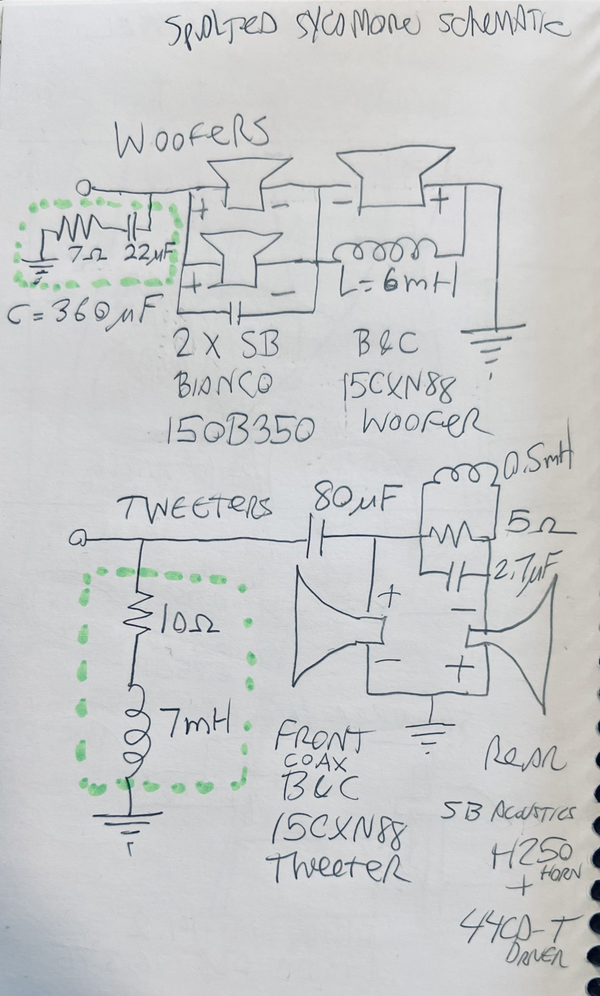

Tech note on the Bitches Brew dipoles - someone watched the Parts Express walk-around video super carefully and saw some components not in the published schematic. I'm publishing the full schematic here. The parts you see in green are the added components.
They are 100% optional, as they are wired in parallel with the drivers, and not in the signal path. But I added them because they flatten the impedance curve.
On the tweeter section, the 7mH inductor and 10 ohm resistor create a flat impedance at low frequencies, compensating for the 80uF capacitor in series with the tweeter (which was necessary to protect it from turn-on transients and accidents). This R-L network is a "low frequency zobel." On the woofer section is a traditional high frequency R-C zobel.
Without the zobel my solid state amp (Adcom) makes a tiny little squeak as the power supply drains, after you turn it off. The zobel on the tweeter section causes the amp to not make any strange noises when you power it down.
This is a reminder that our amps, no matter how good, are NOT just perfect constant voltage ideal sources. They are real world devices with feedback loops, and they do not behave in reality they way we like to think of them.
The impedance compensation also means that cables and other variables interfere with the speakers less.
No matter how good your amp is, it always performs better when it sees an easy resistive load.

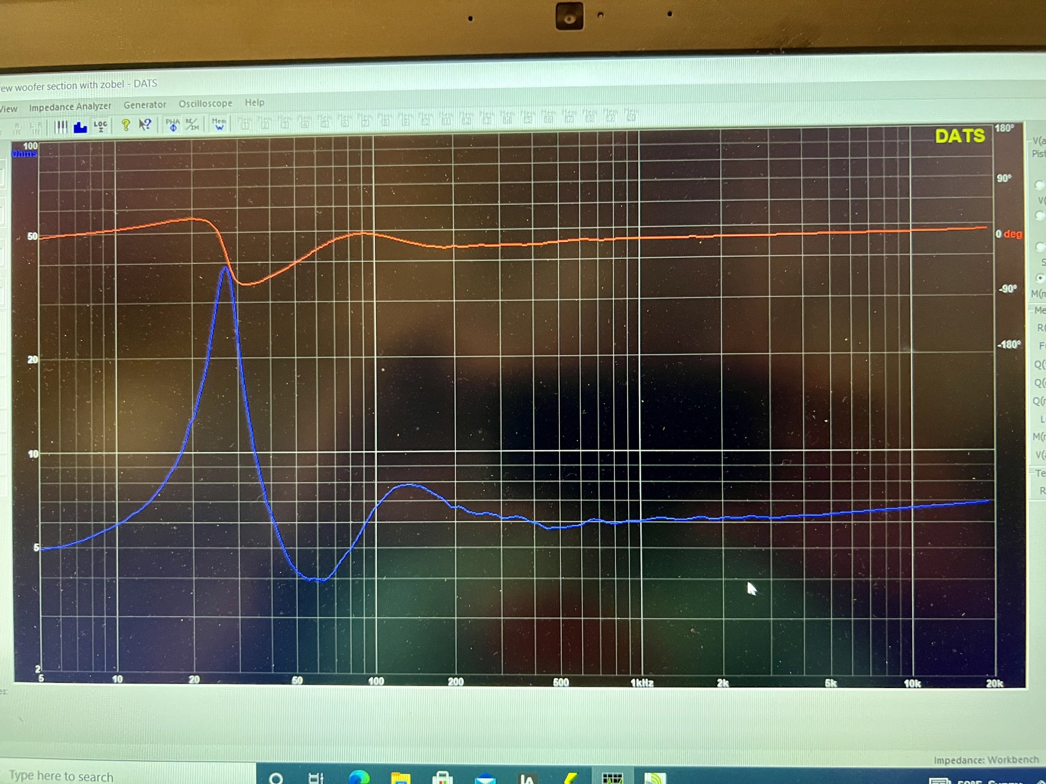

Below: Impedance of the woofer section with the RC zobel network included. As you can see the Bitches Brew is not a difficult load, with 6 ohms average and 4 ohms minimum at 60Hz:

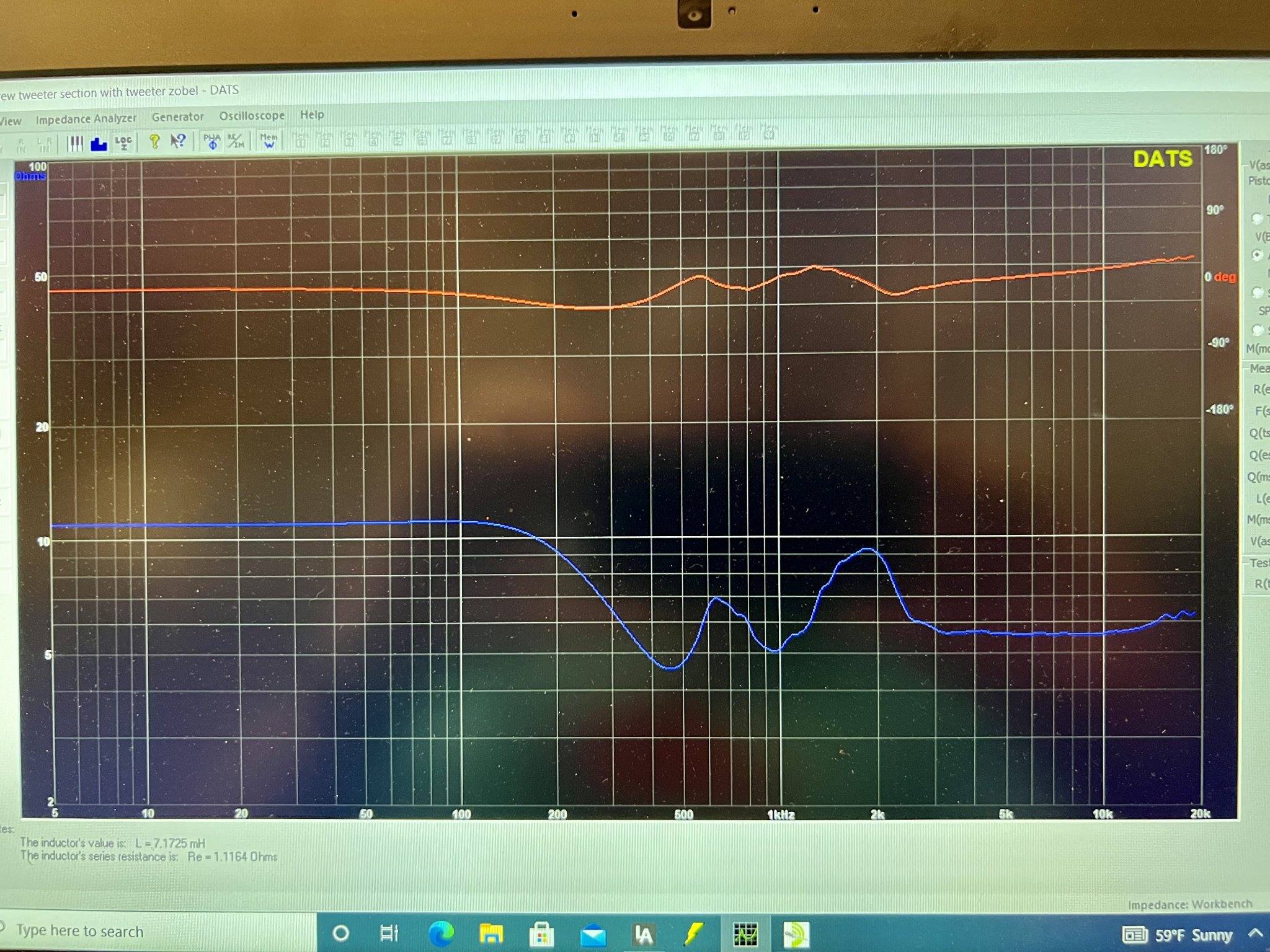

Below: Impedance of tweeter section with RL network included:

Perry,
