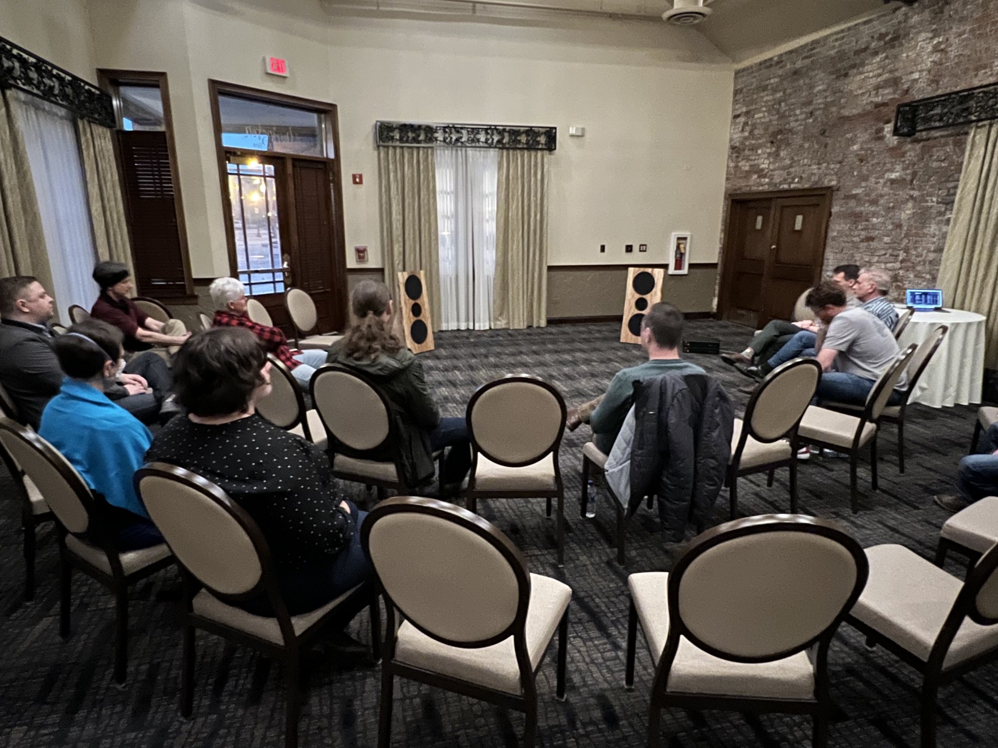

I hosted a listening party at a hotel with the Flanagangsters for 30+ people. I arranged chairs in a large 3/4 semicircle as you can see here, and stereo imaging was great for every single person. This is always the case with Constant Directivity Dipoles. The chair nearest the speaker is only a few feet away but since it's 75 degrees off axis, the SPL is the same as it is in the usual "sweet spot." You can stand next to the left speaker and hear the right speaker perfectly well and get a stable stereo image.
It's one of the reasons I feel radiation pattern separates the men from the boys in speaker design. If you get true Constant Directivity across the entire band (including rear radiation not just front!) the reflections from the room match the direct sound and you get the expansive Open Baffle sound as well as fantastic imaging for everyone. @dawa @Studley @D1sco @diyiggy @tlarwa @Juhazi @jjasniew @wonderfulaudio @LewinskiH01 @CharlieLaub Also, 2 Adcom GFA 535s (60W/channel) had no problem filling the room with sound. If we'd wanted to crank it super loud with heavy bass, the speakers would handle a 200-300W amp just fine.

What kind of wood is that and where can you get it?
There are actually 2 versions of these speakers if you look very closely at the photos (long story). The one pictured above in the hotel is Beech. You'll see Poplar in some other photos. Got it from Schroeder Hardwoods, Harvey IL.What kind of wood is that and where can you get it?
Also I've bought wood from Big Red Sawmill in Palmyra Nebraska. It's really fun to go to these lumberyards and pick out big slabs of live edge wood, they have huge inventories with all kinds of possibilities.
