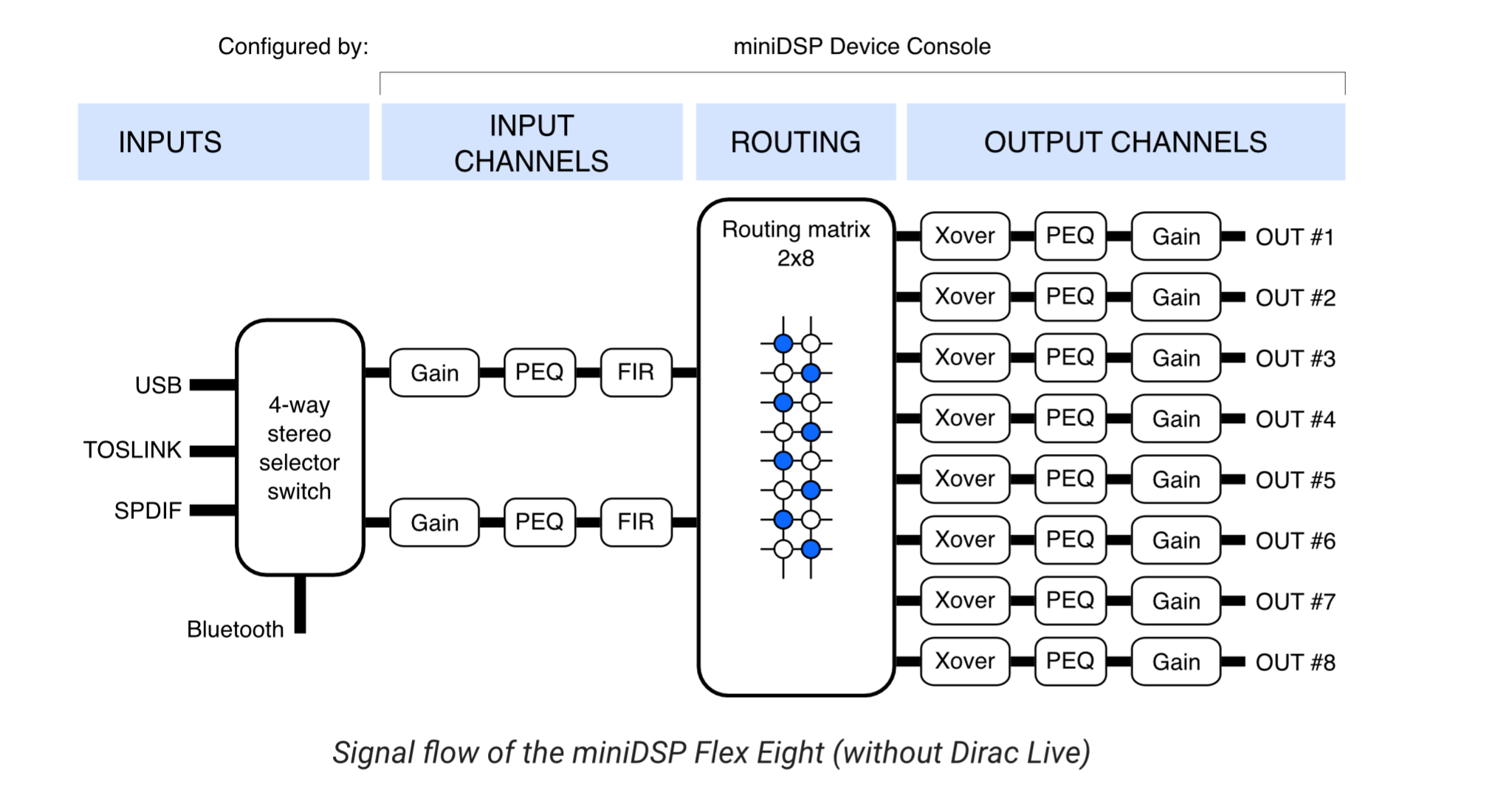

All the units have the same number or total taps: 4096. The Flex Eight differs because it debuts the new Device Console software, so signal flow is different. I believe it will be different for the other devices as well, once they get support for the new software, which supersedes the old plugin.2) I have not tried the MSO tools or MiniDSP Flex 2x8. I anticipate one frustration with the Flex 2x8 though, which is that while the 2x4HD has 2K of FIR DSP for each of its 4 channels, the Flex 2x8 only has 2K of FIR DSP for the 2 stereo channels for the entire unit; and no FIR taps for the individual 8 channels.
From the manuals:
2x4HD
“The 2x4 HD can compute a total of 4096 taps. These taps can be distributed as you wish across the four output channels, with the limitation that each output channel must have 6 or more taps and can have no more than 2048 taps.”
Flex
“The miniDSP Flex can compute a total of 4096 taps. These taps can be distributed as you wish across the four output channels, with the limitation that each output channel must have 6 or more taps and can have no more than 2048 taps.”
Flex Eight
“Allocating taps
Taps are allocated to each block according to the number of loaded taps. The miniDSP Flex Eight can compute a total of 4096 taps. These can be distributed as you wish across the two input channels, with the limitation that each channel must have 6 or more taps and can have no more than 2048 taps.”
About the Device Console:
“We're initially rolling out miniDSP Device Console with support for the Flex Eight, but the other members of the Flex family, the SHD series, and the 2x4 HD and DDRC-24 will be following shortly afterwards. We will make announcements on our forum when they are ready, so stay tuned!
Please be aware that, unfortunately, some of our older platforms won't be able to transition to the Device Console, either because they don't have the necessary hardware interface or because they are approaching the end of their product life cycle”
The MiniDSP device console‘s new signal flow.
So, starting with the Flex 8, would would do normal IIR xover & PEQs on the outputs, the use the FIR inputs to linearize the phase. I write that like I know what I’m talking about, but believe me, I don’t. I’m a software engineer, but not with a background in audio or DSP. I hope it’s not too hard to change the flow to linearize up front vs at each output 🙂
Maybe I'm being nitpicky, but I am an engineer after all! But this speaks to all the issues we're discussing here. Because in order to attain the kind of crossover control at low frequencies that you and I are speaking about, we would need not just 2K taps on each of the 8 channels, you'd need more like 8 or 16K of taps for each channel. 2K of taps is only enough to do EQ above 150Hz or so.
The best you can do with Flex 2x8 is to build parametric, shelf and standard butterworth or LR filters, play with delay, and then fix everything with Dirac when we're done.
Am I correct about this?
So the since the total number of taps are the same, we should be able to linearize to the same 100-150hz or so regardless of device.

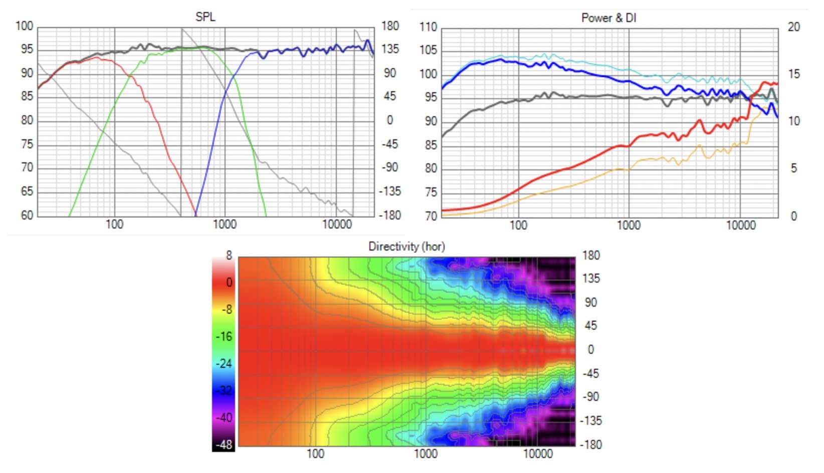

One design I came across that measures well and seemed relatively simple to build (something similar) is this Taipuu DSP way:
Talk about refrigerators. Its a 15" BMS coax and 18" subwoofer in a sealed enclosure. I believe Kimmosto of VituixCAD fame was involved with this Finnish design. They also have a design with "just" a 15" coax in a bass reflex box. Danley's new Hyperion for the Hifi market is also a refrigerator and is an active DSP design with linear phase. That one probably costs as much as a small house.
I've also been looking into Scott Hinson's MEH/Unity horn design for the theater room, where construction is simplified slightly because it uses a coax compression driver that can cross over as low as 300hz, so you can just jump straight to 2 10" woofers in the horn vs having to cram in a bunch of mid drivers as well.
What these designs and yours all have in common is they are about 20" wide and have controlled directivity down to about 100hz due to their size. (Well, yours is more "constant" directivity.)
And finally, I've been looking into CBT line array designs, which I may use as surrounds in the movie room. I wouldn't bother trying to make those, as the cabinet design and electronics required would be a bit way too much work for me--I'd just buy one of the JBL models.
Maybe I should collect the whole set: dipoles, coaxial horn, and CBT 🙂
