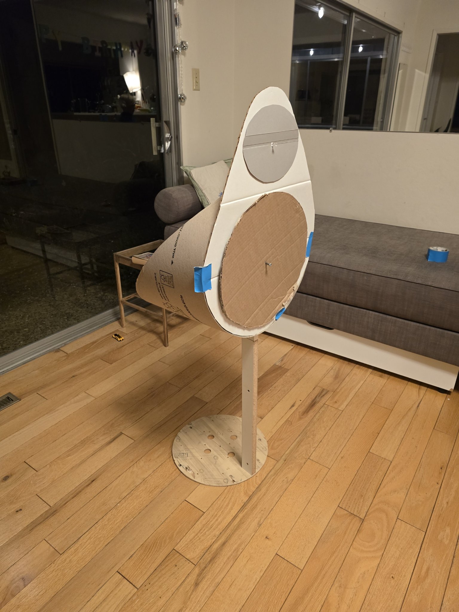

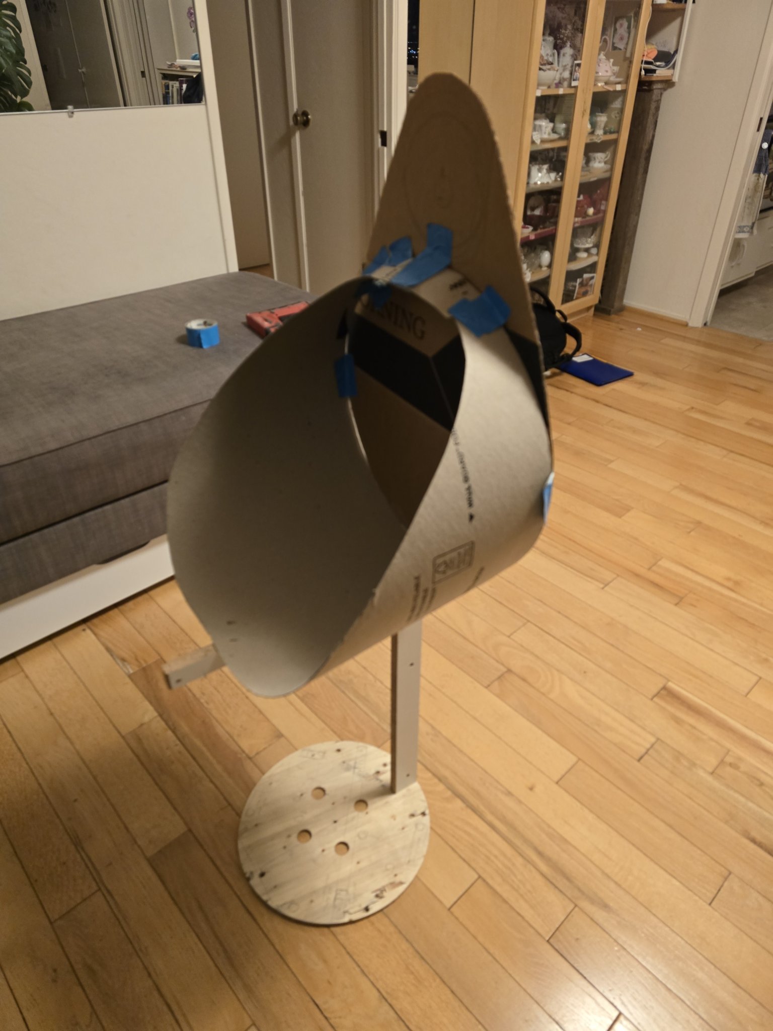

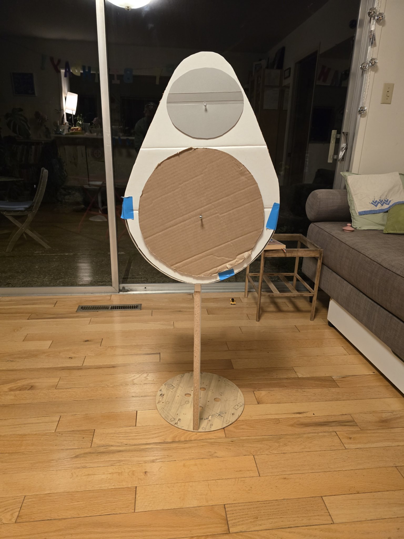

I didn't see a dedicated Cottonwood thread, so I'll leverage your quote above in this one if that's ok.

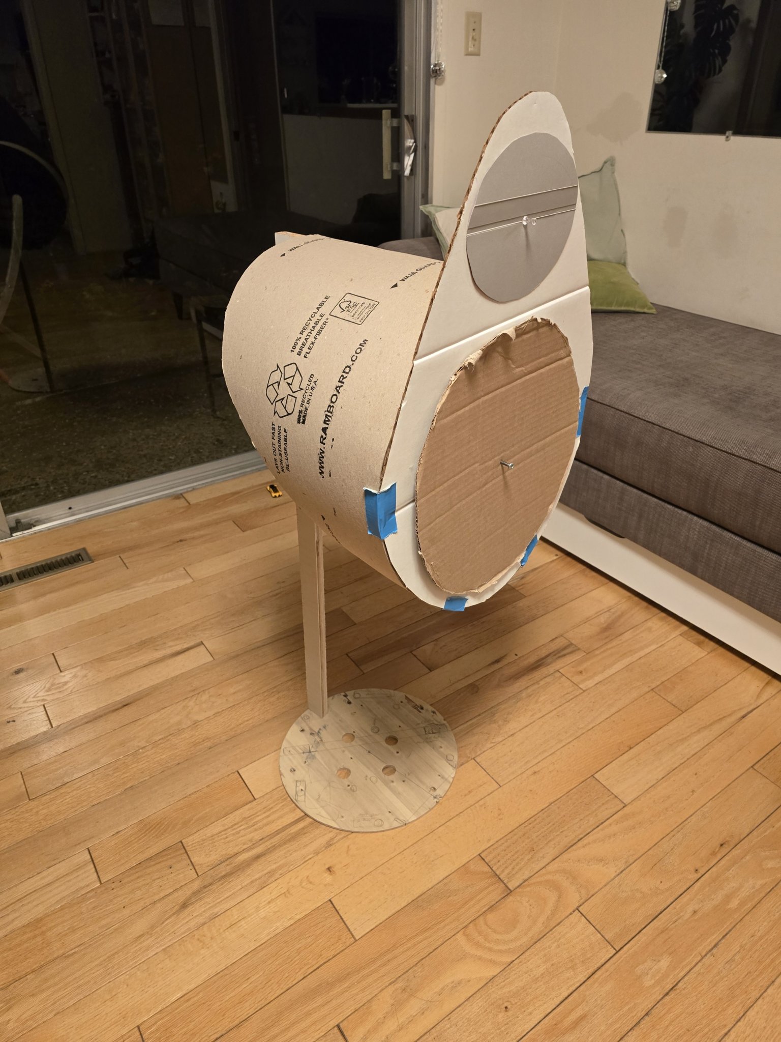

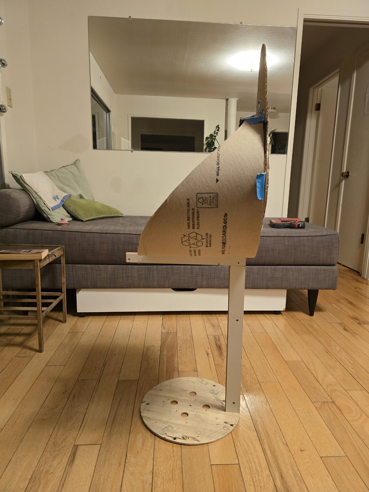

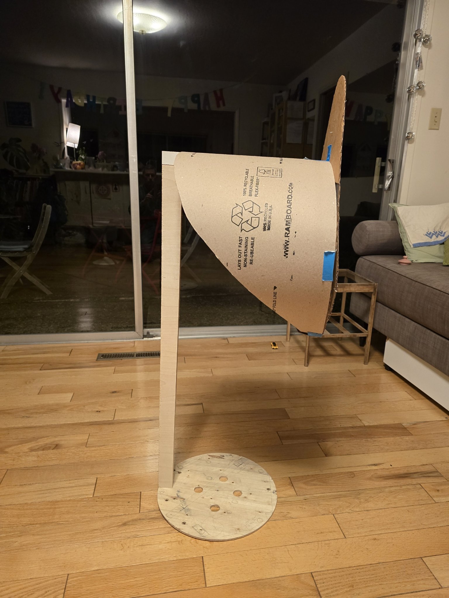

Thinking about raising up the 15OB350, I decided to see what the minimal volume might be. These images will again take some serious imagination--the stand would be robust, the baffle about 1.5" thick, etc. The tweeter zone also was a quick eyeball guess, then I retroactively tried the wider 8" oval waveguide, so looks very cramped. The 15OB350 diameter as shown is back-mounted, but that could be reversed of course.
Would one of these 2 "wing" orientations be preferable, or no difference?
Is the wing feature larger than needed? As shown, it's a maximum of 14" from the baffle front.
Common airspace:
Or "segregated" airspace--kind of keeping the rear tweeter zone separate from the woofer. This might be more relevant if there were a midwoofer above it, I'm guessing? Anyway:

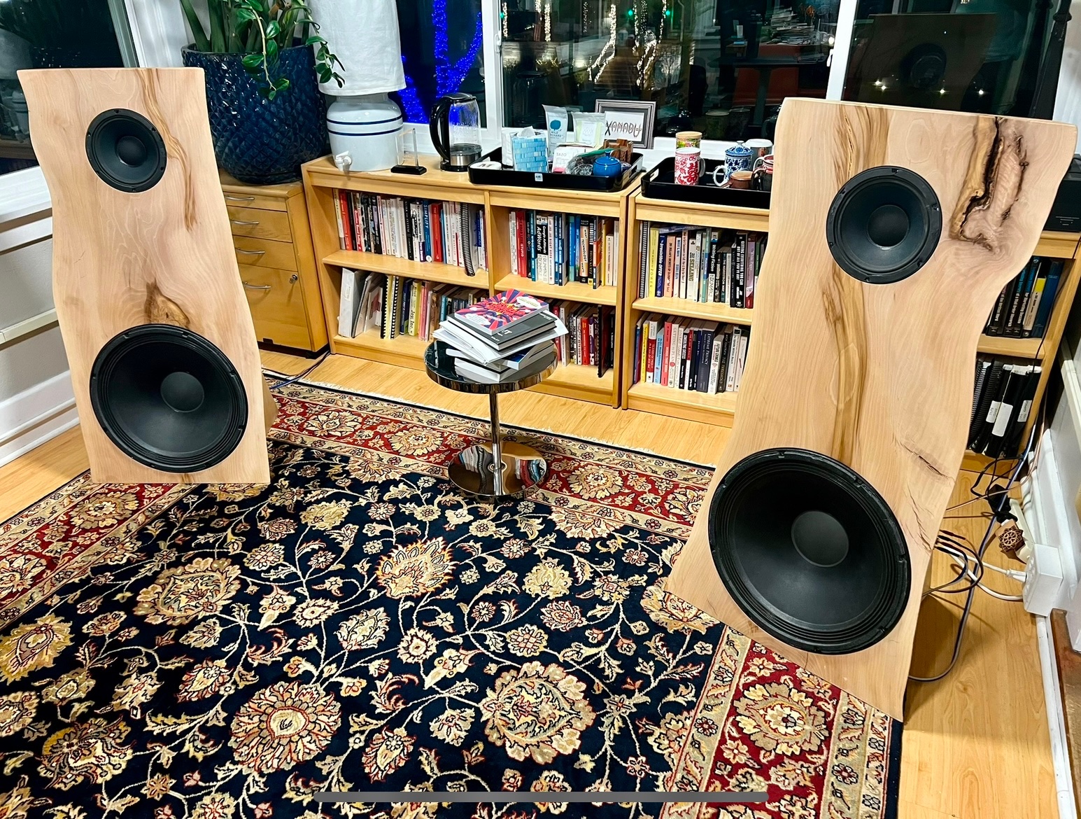

I prefer the common airspace. Acoustically this design should perform well. It will roll off at around 120Hz so will need a little boost around 80 to meet the crossover point of 60. Should be no problem.
Cosmetic comment: it seems to me there's a risk of this looking like a bird or an egg so you’ll need to play with the design so as not to lend that impression.
Personally I think you could mount the drivers on a single slab of wood 18” wide without wings, that goes all the way to the floor, and you’ll get adequate bass extension with modest EQ. Just my 2 cents.
Agreed with perry for the slab going to the floor ... But your solution is less "intrusive" in a little space.

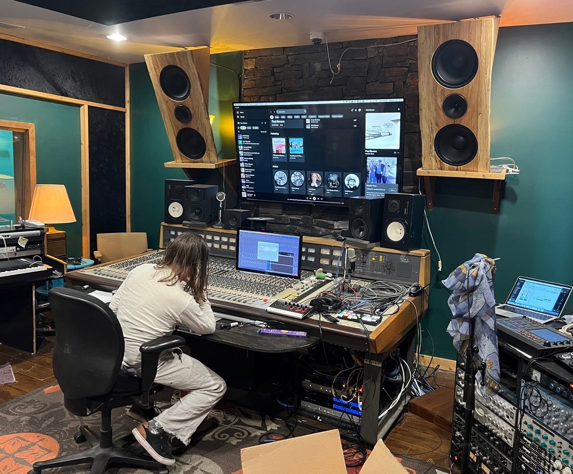

It make me think about the Hex3 speaker https://www.hex3speakers.co.uk that looks pretty "small" for an OB
It seems to be a 15OB350 with Visaton B200. Don't know the tweet ...

I was personally more thinking about sound rather Aaesthetic for the slab. Unfortunatly size is important in OB ... And since bass is directive in OB you might have strange behaviour and bouncing on ceiling or floor...
That's certainly an innovative way to mount them, but I have to ask--how does it work having the OB sections that close to the wall?
The speakers also appear to be at borderline nearfield listening range, which makes this multiple driver setup even more challenging to understand.
He didn’t ask me where to mount them, he just hung them and told me later. So they are about 2 feet too close to the wall. They sound great anyway. The other recording engineer commented that they don’t have “corner mud” and that the bass sounds fantastic.
There’s no issue with being too nearfield, there are only 2 drivers operating above 200Hz anyway and there are no serious lobing issues at any realistic listener position at the 2K crossover frequency.
One of the reasons is the double steep shelf filter crossover I implemented via FIR which only has max 1/3 octave overlap between the drivers at 2K. The FIR corrects timing and achieves flat phase.

@DirtyBumOAK if you have long narrow rooms, put the dipole 24-26” from a side wall and keep the usual 3-5 feet to the rear wall. That works great because there’s little side radiation.
Every one of my dipoles sounds great in this 9x19 foot room pictured here. Hybrid OB reflex or TL will work just fine too.
