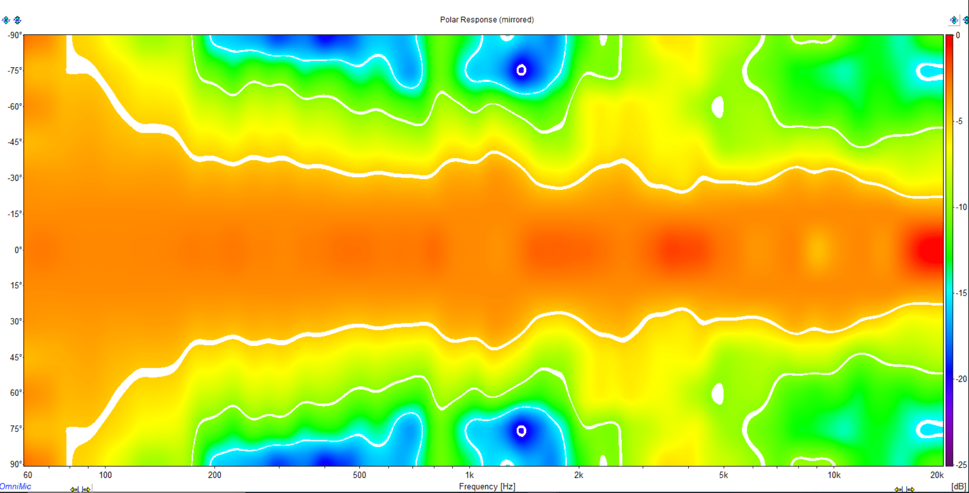

Out of curiosity, does the mid driver start to beam as it nears 2 kHz? I'll add that the idea of a single high-efficiency driver from 100-2 kHz with solid Sd seems appealing.

You can see from this plot how beamy the midrange is at 2K - it matches the tweeter fairly close. This graph is from the first post in this thread.

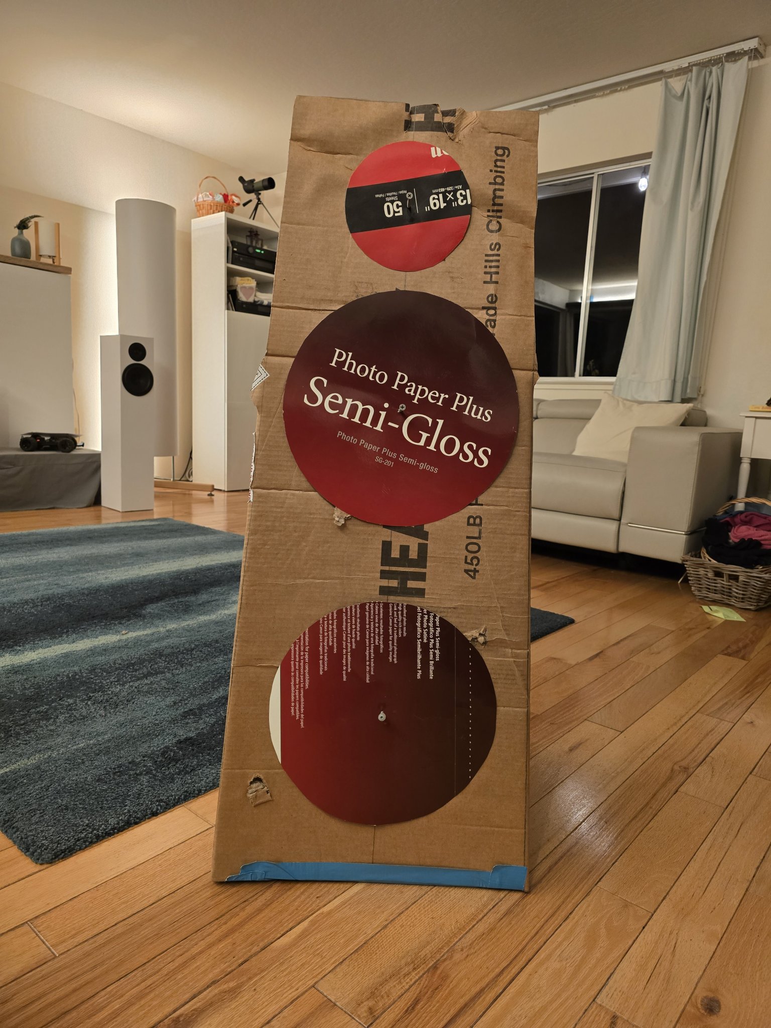

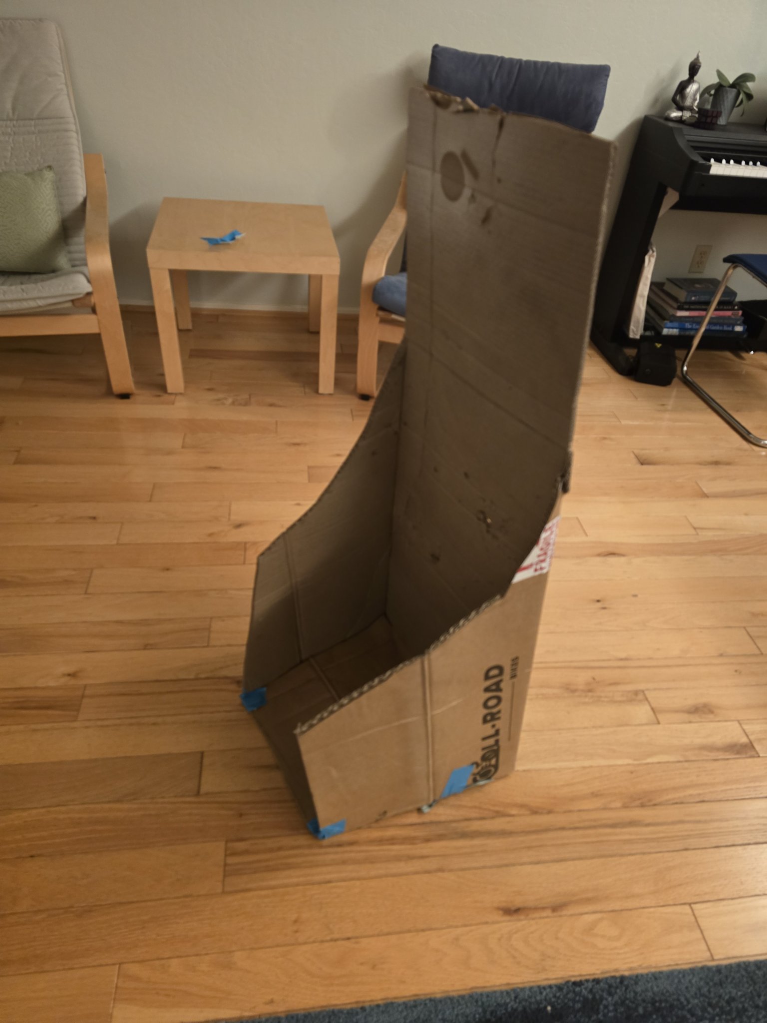

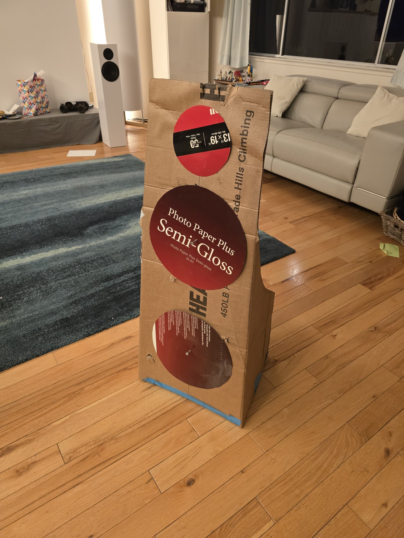

For fun tonight I eyeballed a Flanaganster with the tweeter on top. Then I measured what I'd come up with. The baffle was 42" high, 17" wide at the bottom, tapering to about 12.5" at the top. The BR box zone started at full width and tapered back a few degrees on both sides to shed some visual weight. In real time I wasn't sure how far up to carry the side wings, and tried 2 profiles, but the basic idea was increasing the volume by making the rear chamber a bit deeper at the top. I haven't calculated the volume, but would match your (Perry) design.
One of my specialties is making rapid models to assess volume and proportion... and they're almost always sinfully ugly. I can see the final product in my mind's eye...
Rear-mounting only the middle driver might give a nice taper to the black spaces. I also like the original MTMish layout.
The slight tilt to the side undoubtedly would give it that special something. 🙂

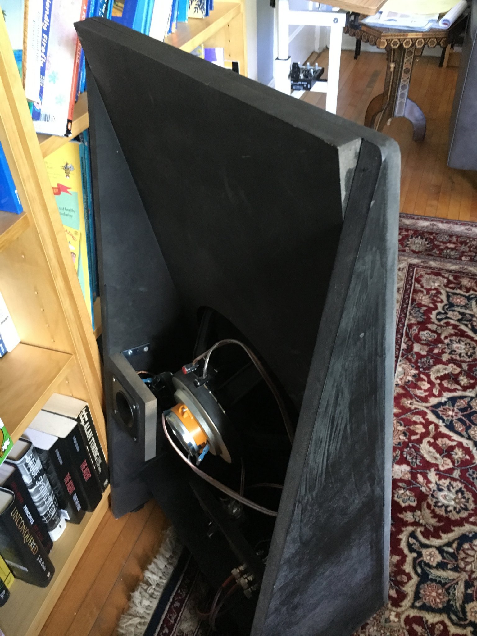

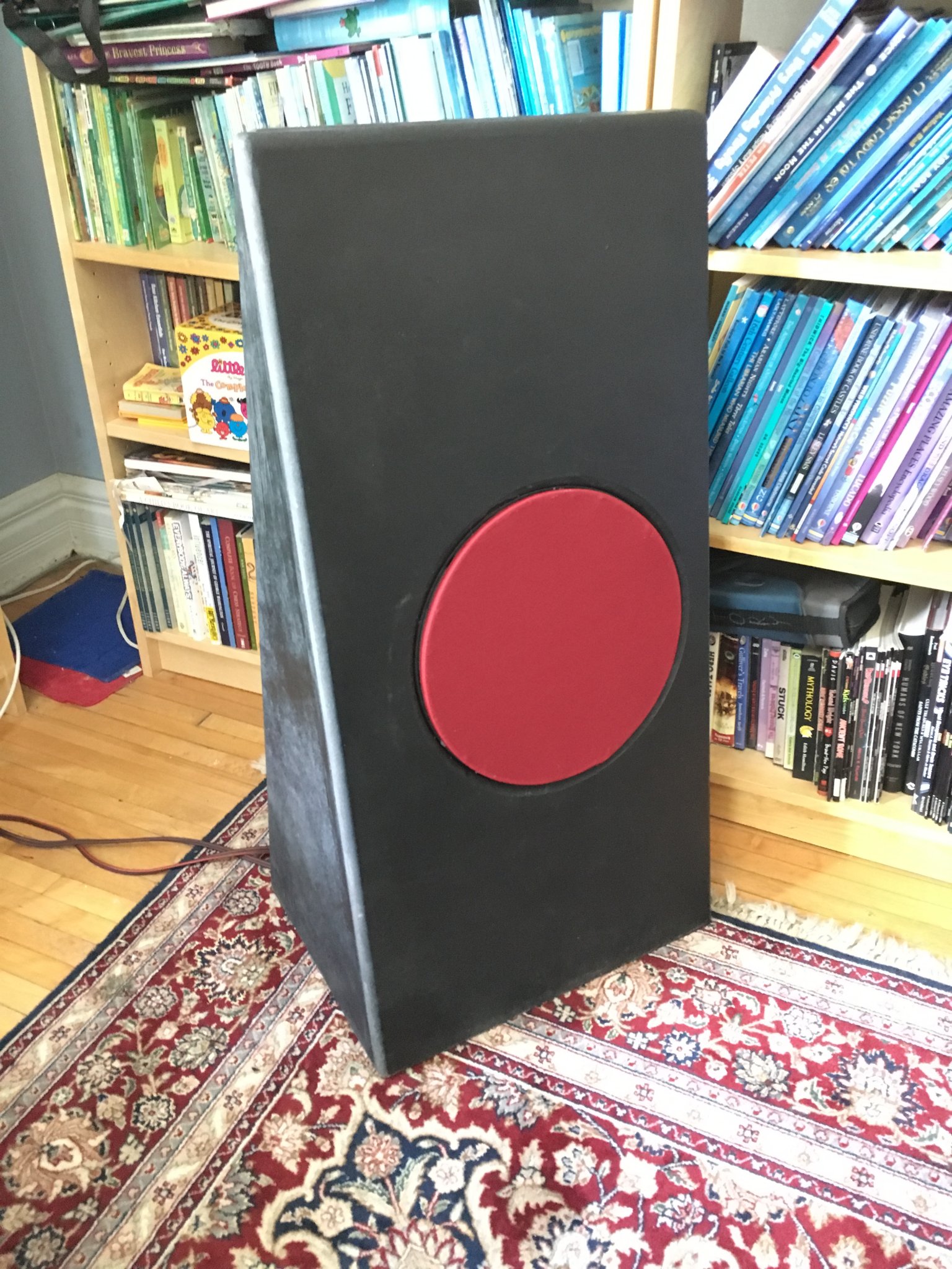

The Flanagangsters....
A Heretical Reflex+Open Baffle Hybrid
Constant Directivity, 96dB SPL, 300 Watts, 35Hz-20KHz
Crafted from Live Edge Wood
(re-posted from https://www.diyaudio.com/community/threads/ultimate-open-baffle-gallery.123512/post-7216744)
I made these for my friend Jeremy Flanagan who loved the Bitches Brew Live Edge Dipoles but needed something much smaller and more economical. These deliver 80% of the performance for 20% of the cost. I wanted these to have the luxurious room-filling sound of Open Baffles but be capable of functioning as “party speakers” when called upon to do so.
The woofer has 5mm Xmax. This would fall far short of what’s necessary in an Open Baffle, but 5mm is plenty in a reflex, especially since the DSP filters out frequencies below 35Hz using a high-Q shelf filter. There is surprisingly little excursion at high volumes, and plus it doubles as an excellent midrange. And even with the small baffle size, the 12” dipole midrange effectively operates down to 100Hz.
Below is the MiniDSP EQ correction curve for the woofer – notice the 9dB of bass boost at 40Hz which complements the above curve and renders the system flat to 35Hz:
I feel these do successfully achieve their objective of: Delivering most of the power and impact of the Bitches Brew Dipoles, without the expensive high-end drivers and huge size.
The Constant Directivity sound pattern means every seat in the house is excellent. You can stand right next to the right speaker and hear the left across the room with an intact stereo image. The DSP assisted reflex means with a 200+ watt amp and 96dB, these will play at loud party levels without stress or fatigue. A few months ago, I hosted a listening party at a hotel for 40 people and they easily filled a medium sized hotel ballroom with sound.
These have great stereo imaging everywhere in the room, tremendous dynamic range, and achieve the advantages of Dipole + Reflex with almost none of the disadvantages. Distortion is incredibly low and they have a creamy midrange and very non-fatiguing high end that's easy on your ear.
