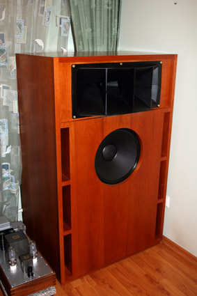

Hi GM,
That looks pretty nice. Mine are still unfinished although I sometimes contemplate staining them..
I would be curious about any diffuser options you dig up..
Just looking for any little improvements I can make as icing on the cake. I'm less sure now that the midrange coloration I was hearing was from the horn as it might have been one of my digital sources that was the culprit, it seems much less pronounced all of a sudden.
The vertical directionality of the current diffuser is an issue though..
I'm happier with these than with any of the store bought speakers I owned previously, personal biases not withstanding.

4 Years On: Update
The Onkens have been in service now for nearly 4 yrs and I can't imagine living with anything else frankly. The end result ultimately far exceeded my expectations particularly with the 2nd generation X-O design mentioned in another thread.
I never did stain them and like their appearance as is..
I also have not opened the boxes since their completion and despite the measurable presence of higher frequency components at the ports this has not proved to be audible at all - although why that would be the case is not clear.
Despite designing for an FS of 38Hz at -3dB, the box tuning actually appears to be slightly lower perhaps due to a slight error in the port length, and other things. I have usable output down into the low 30s and it is pretty obvious. Things changed with the X-O modifications which addressed an excessive rg issue and perhaps slightly reduced the Q of the driver. Break in seems to have played a role here as well.
The real reason I have posted is that the Onkens (theoretically anyway) are about to get an upgrade to the mid and high horns. I now have JBL 2440 compression drivers and will be evaluating them for use with some sort of conical horn like the AH! 700 or 350Hz Edgar Horns.. I'm also thinking about 300 -350Hz Iwatas, and will have several different types of conventional sectoral and possibly smith horns to try. JBL 2405 or Fostex 825/900/925 in addition to the current 2402 are options for the highs. The bass sections will not be changing. All of this is reversible in the event that I do not achieve any real improvement.
