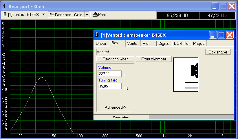

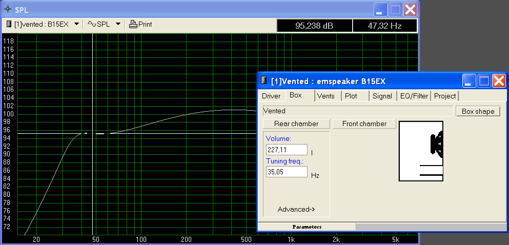

For example the very exspensive EMspeaker B15EX. Cost 1400 euro or 2000$.

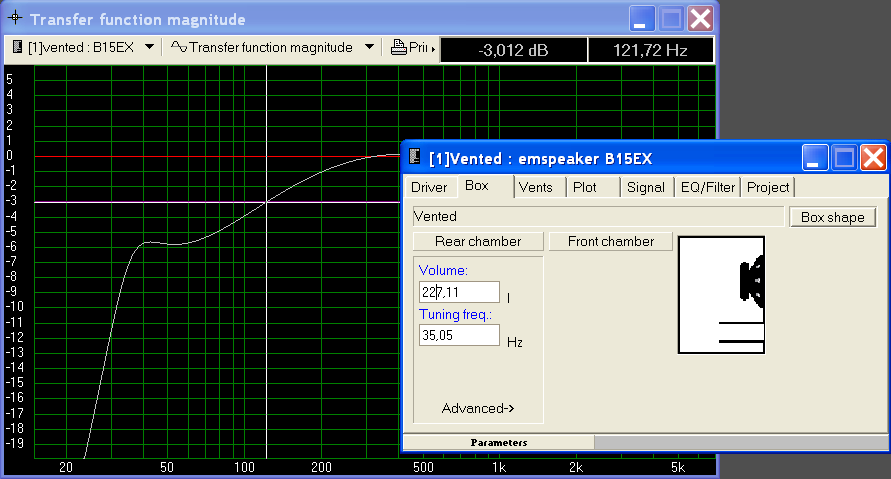

100dB average let simulate it in a onken like enclosure. What do we see -3dB at 120Hz (97dB 1Wmtr).
35Hz 94dB 1Wmtr. So you can use it down to 35Hz then you have to attenuate above 100Hz -6dB so average spl level is 94dB 1Wmtr with the extreme expensive woofer.

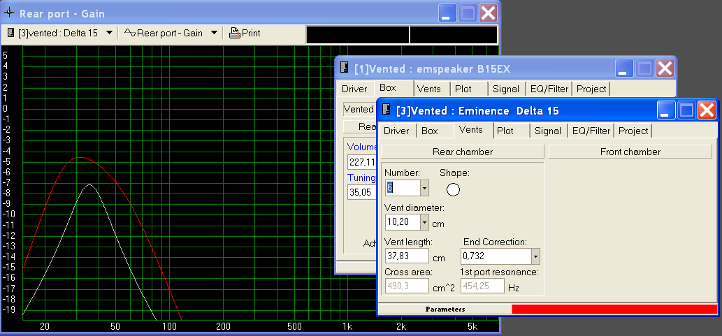

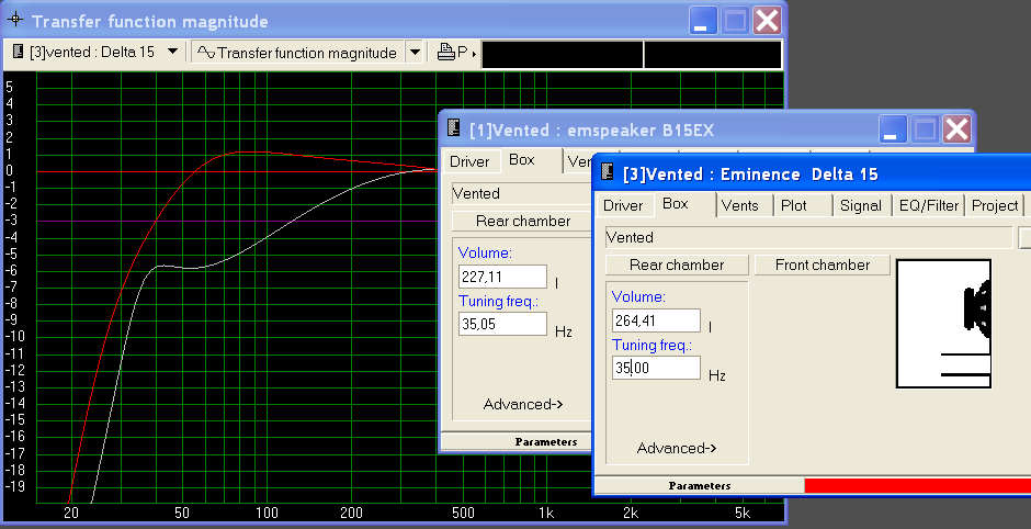

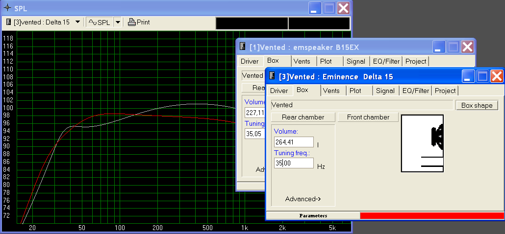

Lets compare the 2000$ EMspeaker to the 130$ eminence delta 15".
The eminence has -3dB at 44Hz 95,5 dB. With port gain it will do 40Hz and it extends easy down to 30Hz.
When I had a EMspeaker in my onken I would spend 90 euro and try a eminence delta to see if helmuth is right.
Succes
In pictures
grey line EMspeaker
and
red line Eminence Delta 15"

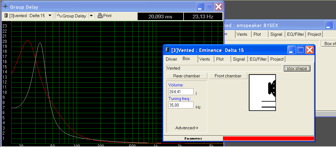

On groupdelay the eminence outperforms the EMspeaker also much better acceleration.
It is nice when frequency X Groupdelay is smaller then 400 as a rule of the thumb.
But still why build a onken when a openbaffle performs better box-less sound.

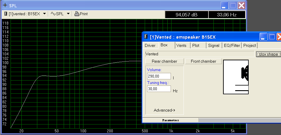

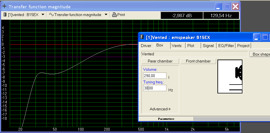

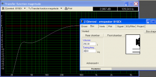

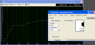

Here the simulation 290l enclosure 30Hz tuning.
-3dB 130Hz.
33Hz 94dB 1Wmtr
One advantage at this curve is when placed in a corner it can become a flat response due room gain.

Your simulation shows 3-4 dB more, I have good experience with Winisd results so do not doubt them.
I understand your choice on your own data, with use of room gain it can become close to flat and near the 100dB level.

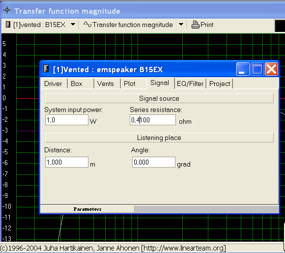

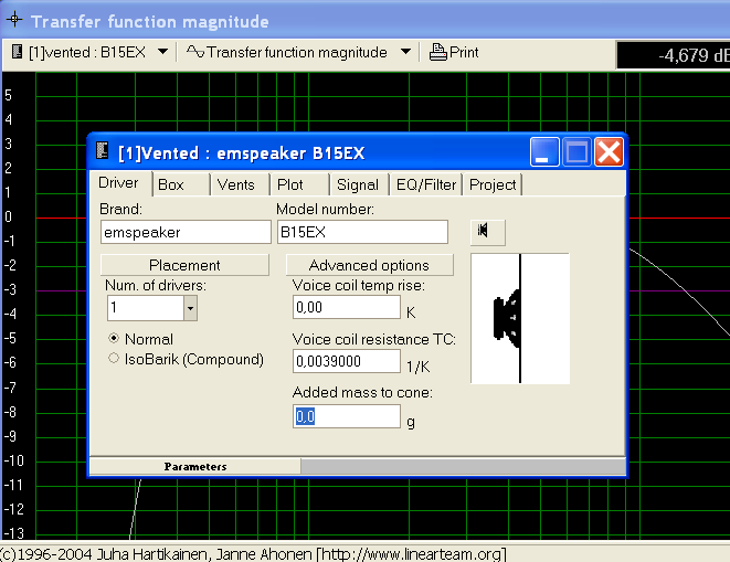

Simulation tips winisd
Port size is important for Onken alignment I did not see different results for simulation small or big. When you change port size then in the box window the tuning frequency will also change in winisd.
In practice the sound is boomy from a to small port I know from my projects.
To play with the cutoff characteristic you can simulate the influence of the series resistance of the passive filter or with active place a series shunt to get the optimal result. It will change the total Q = Qts.
Also you can ad mass to the cone to lower Fs and this can be also a way to tune a driver for your application.
And you can ad your lowpass filter it will raise the groupdelay in the simulation. The low Fs of your driver helps a lot to keep the groupdelay low when tuned to Fs, you showed that in your simulation.
