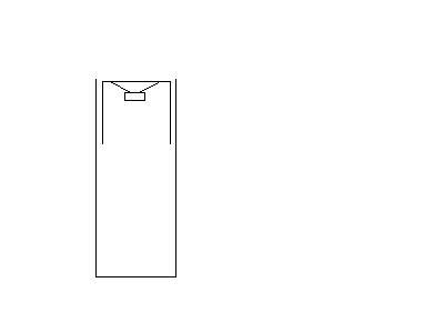

This is how my Onkens looked like. I admit this sack shaped design is not the original intention of the Onken concept, but the parameters (85%Sd port crossectional area, 33cm port length, Onken alignment) are standard values. I simulated it in the MJK sheet with the unusual height and port/driver offset, and even here nothing indicated it shouldn`t work. Of course the sheet doesn`t take into account the direction of the port, but can this be the reason?
hi el 'Ol I'm no expert, but I suspect that the shown configuration might result in some serious performance problems. GM or panomaniac probably could come back with some more cogent answers, in my design I deliberately attempted to stay somewhat close to the "golden ratio" although one of the ratios is more than a bit off actually.
It seems to me that such great depth relative to the height and width might result in an organ pipe like resonance. I could be all wet here.
My box is roughly 28" wide, 20" deep and 35" tall and these values worked well for me, and are not too wildly different than the original Jensen ultraflex box, although the tuning is specific to the 165-8G I am using.
My understanding is that none of the extant simulation programs model the onken properly, again someone far more expert will need to weigh in with their thoughts.

Well, if you post all the info I requested, I can 'speculate' too. Till then, I'm going to assume you screwed up somehow and/or are comparing 'apples n' oranges' since the performance 'spread' between the two is so great.
That said, no program AFAIK can model an Onken with the same degree of accuracy as a single vent BR, but performance 'trends' can be compared, which often allows us to figure out why one performs better than another.
