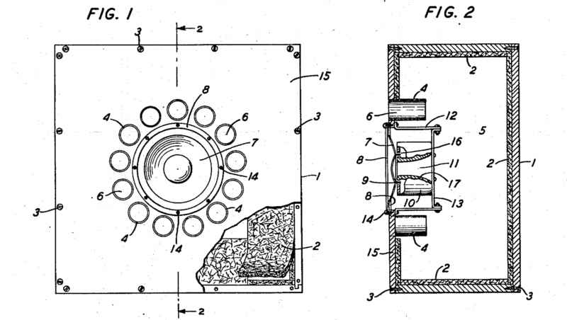

As far as damping goes, I was just reading some vintage Altec speaker building manuals. They had a simple method to determine "enough" damping.
From Altec - 1974
The normal method to check speaker damping is simple, but is easiest if you start out with too little fiberglass. We recommend the battery test method to check for damping. Attach a short length of speaker wire to the loudspeaker terminals in the normal manner, and bring the loose end around front – where you can easily listen to the loudspeaker sound while testing. Hold one of the speaker leads to either end of a standard 1.5 volt flashlight battery. Then touch the second lead to the other end of the battery and release. A properly damped loudspeaker will reproduce a clean “click” as contact is made and released.
The underdamped speaker will reproduce the battery contact as a “whomp” sound. Fiberglass may be added in a loose manner to the enclosure until the proper “click” is obtained, and then stapled into place according to above practices relating to the specific type of enclosure.
The overdamped speaker is more difficult to observe. It is a matter of degrees that becomes familiar with one or two experiments. Thus, the recommendation to start tests with too little, build up, and then go back down as required.

Assuming they're like the old 416/515 series (which they should be according to GP), then they are still somewhat 'colored' compared to more highly damped drivers, so there's still room for 'improvement' since you're not using any of the Altec horns they were voiced with. Horn loaded is where they should 'shine'.
Yes, I used the 'click' test. For an Onken, best IMO to either use a loose fill, or what I did was to put 1" acoustic fiberglass matte on the top and one side due to the parallel walls, then kept adding layers of it on the baffle board until I was satisfied since the cab acts as an end loaded two step pipe. IIRC I wound up with four layers on the 416-8C alignment.
Damping the vents is best for rolling off both its output and its harmonics, like for when they either 'boom' due to being too near a wall or corner or the cab is too small/tuned too high, i.e. make the response more TL-like. Historically it was done by stretching one or more layers of either damping material or grill cloth over the baffle thickness vent opening, but with the longer vents, foam inserts or packing them with drinking straws is preferred.
