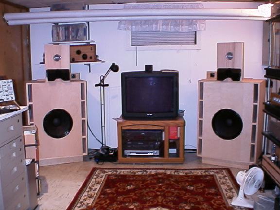

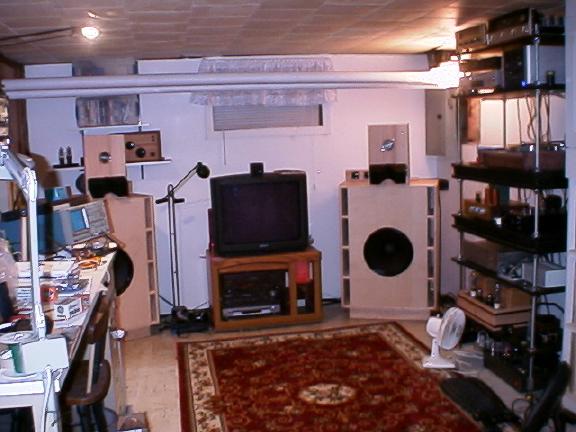

Here is my new Onken based system. I'm pretty pleased overall with the performance.
It was quite a lot of work, but I think I even got the basic box tuning right. I won't have to open them again for a while.
I'm not totally used to the CD mid horns yet which is what I have now got, dispersion patterns are quite a bit different than most horns and indeed most direct radiators.
I'm less and less convinced that the 2402H is essentially similar in sonic signature to the 075 - it seems not to have quite the high frequency extension. I'm thinking Fostex T900 or T925 alnico bullet horn tweeter in the fall.. LOL
The mid and tweeter horns are entirely separate from the Onken boxes to allow me to try other horn/driver combinations.. The x-over is external for the same reason.
Another conclusion is that amplifiers with high source impedances interact with the more complex x-over and drivers in ways that I don't yet fully understand. Average amplifier power output is a couple of mW typically, the 300B with fixed bias and regulated supplies does a good job, my more traditional 2A3 amplifier with direct coupled driver stage and polyprop in oil cathode bypasses doesn't cut it. (And the problem is not in the bass! The mid horn hates that amp or vice versa.)

Nice Kevin! Congratulations on getting them working. If they sound as good as they look, you'll be a happy man.
That's a great listening room you've got there. You can watch the o'scope, get high on solder fumes and listen to great tunes all at the same time. Add a few adult beverages and we'll have to call you "Ali-Baba."
Nice that you seem to have gotten the box tuning right. Won't the drivers change as they break in? Lower FS and such? Let us know how that goes.
Tell us a little about the mid horn. I never heard a CD horn I liked. Good, but never great - but they were all in P.A. or cinema use. What have you got going there? Is it JBL?

Hi Mike,
They're definitely a lot of fun and I had a little time to crank them up a bit more tonight, my room is probably a little too small.. There is a lot of bass, and it seems quite well controlled, I do expect though that the extension will improve as the drivers break in. Some tuning may then be required.
Eventually I might tri-amp this system, and at that point I think modifying the amplifiers I would use on the low end for variable damping factor might be interesting.
The mid range horn is JBL 4333, the compression driver is a 2420 which has a honking great alnico magnet, currently 16 ohm vc with titanium diaphragm. All "unauthorized mods" by previous owner have been removed.. LOL I doubt the diaphragms are oem, but sound reasonable. (not broken in yet) The horns are 2312, and the diffusers are aftermarket clones of the 2308. They are quite interesting sounding, but I need to do some measurements to see if they are crossed over properly - they sound like no cone mid I have ever heard, both good and bad. They are a little directional even with the diffusers installed.
The tweeters are 2402H annular ring tweeters with ferrite magnets and I don't think they are as good sounding as the older alnico versions but I'm not quite sure..

I made an interesting discovery last night, I definitely had the mid horns phase reversed. Swapping the phase as required by my cross-over design greatly improved mid range dispersion and eliminated an audible hole in the frequency response and dispersion pattern, and also interestingly resulted in much more coherent highs as well.
The difference was so noticeable that I almost fell out of my chair.. (And it wasn't bad before despite what must have been large holes at 800Hz and 8kHz - the cross-over points.)
Matching levels between the drivers masked the problem to some extent as the mids and tweeters are about 8dB more efficient than the bass cabinets, tonally I thought there was a hole in the lowest registers of the mid-range at any level setting. Now that is gone and the overall levels required from the horns is much lower. Dispersion now seems much less position dependent, and the tonal balance sounds right as well. Ah, the benefits of tweaking..
The Onkens move a lot of air at low frequencies, this is more than audible - you can feel it.
Still need to get set up to do measurements so that I can tweak things and also gather enough information for eventual tri-amplification.

Hey Mike,
Further listening indicates some tuning will be happening in the future..
I determined last night that the ports are a whopping 7/8" too long, so I will at some point be cutting a little material off of the ends of the internal port dividers (left/right) on each side to fix this. I was a little bummed initially, but I realized that with a small plunge router and a fence fastened to each divider this will not be hard to accomplish.
I also think that I will take the opportunity to add some additional bracing in key locations. I don't hear any rattles or buzzes, but I do think I possibly hear a cabinet resonance.. Additional rigidity cannot hurt.. LOL
I don't plan to move fast on these realizations as there may be other causes, and I won't do anything until I can measure the results. I think things are pretty good as they are and I want the tweaks to fix "real" not "imaginery" shortcomings.
