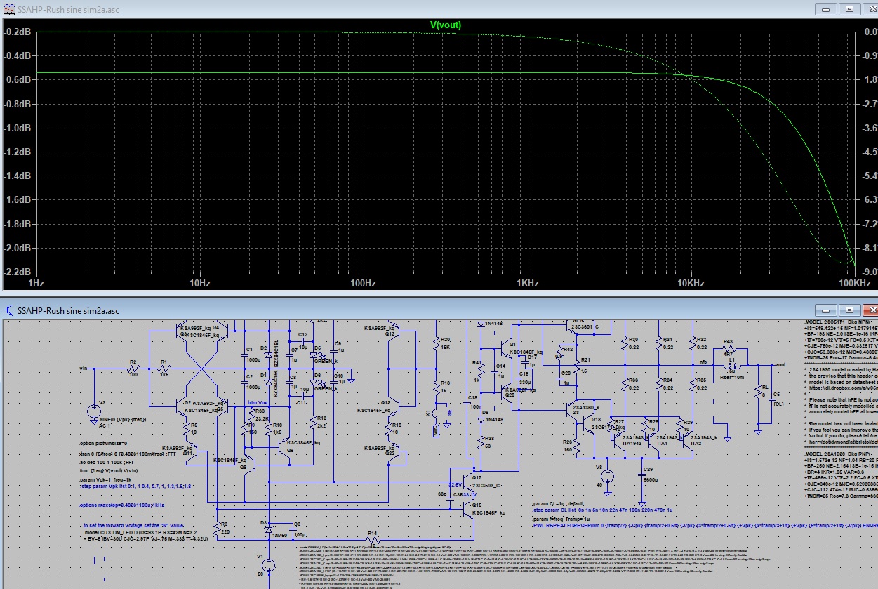

The frequency was 20K. Besides, LC's First One Zout declared less than 10mR but with output inductor, don't know the value. He didn't mention if it's on nfb or out. Maybe this is because they use mosfets as op?
BTW Your Ad (difference gain I assume) is -ve when it should be positive. Then use the differential gain 29.5dB (not the SE gain) as the reference gain.
The common mode gain can be measured with "Vin" fed to the inverting input (as well as the noninverting input) then add 29.5dB to the reading (or use two cursors to read the difference).

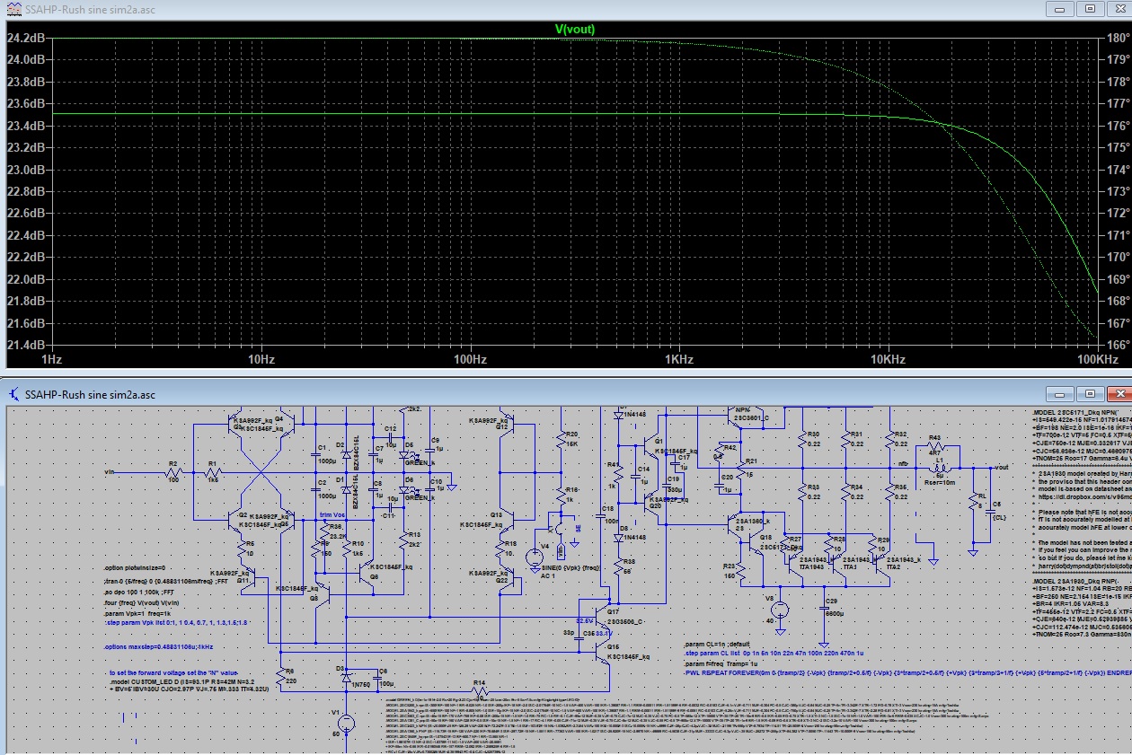

I measured diff gain with one source to both inputs. Sorry, yes it's positive, 21.9db at 100k. Acm however is much different at both inputs.
We can raise the CMRR when match the input impedance I guess.

....Acm however is much different at both inputs.
Thanks for those screen shots. I can now see how you get your readings.
There are two ways of doing balanced systems: the ground referenced type and the floating type. The ground referenced type with a transformer is where the sender has a center tap and the center tap is grounded. The floating type has no center tap. You are using a floating type of input whereas I have been using the ground referenced bridge driver. ESP Fig 8 Balanced Interfaces top circuit shows the grounded type. The mid and lower ones are balanced types.
Your first run uses the floating form. I used the ground reference type as it can be easily switched from balanced to single ended by changing a jumper position on the inverting input. With this method the balanced gain is double the SE gain.
We need to use the same type of balanced system to compare notes to avoid confusion. Confused?😕 I'll use the floating method from now on.
So delete E1 and connections (In-) including the jumper switch (X1). Hard wire the bottom end of the input source to the inverting input (R16). An AC run will show the differential gain as +23.5dB.
To get the common mode gain wire the inverting input to the top of the signal source and connect the bottom of the signal source to common and read around -50dB at LF. So the CMRR is 23.5+50 or 74dB.
BTW it looks like your second plot (near -0.6dB) has a floating inverting input because the Vin+ label goes no where (since you have deleted E1 in this run). With the inverting input floating there is full Vout to this input so almost unity gain except for some attenuation of the input resistors on the other input). If you connect ground to where the Vin+ is then you get back to a SE input amp. The third plot has a floating noninverting input, but that's OK and you get an inverting SE amp gain of 23.5dB.

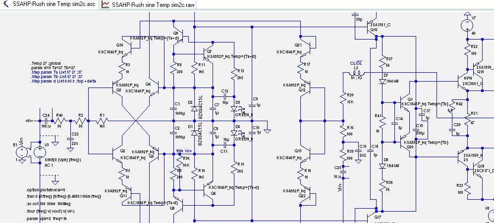

Hi AndriyOL,
I did some sims with a floating input source. The attached capture shows how I did it.
When input capacitors are used there is an error -- "floating source". To fix this, add 1G ohms to Rpar (Rt Clk on cap) both input caps. Then you get high THD because the input capacitors have a transient; to fix that make the values 100 and 10 which is Farad's when in reality you use 100u and 10u.
There is a 3rd problem with a floating source -- you can't do a .four on a floating source; to do that you need to use a controlled voltage source as a differential amplifier to shift the voltages to common.
Next I did some temperature stepping to check if adding transdiodes for the VAS idle current. My run showed VAS current was not helped by these diodes and worse the distortion was almost doubled with the diodes. So it appears best to not use these diodes, just use the original 220 ohm b-e resistors.
Note a changed statement: .param d=0 Ta={Temp} Tb={Temp}
This makes all transistors use the same temperature with global stepping, eg .Temp 37 27 . With this statement you can read the change in THD, then probe returns the idle currents for 37C (get 27C current from the original .Temp 27 run).

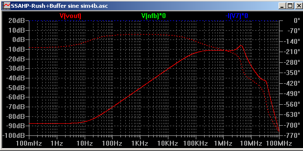

Then I also added 2 buffers. Why is this necessary?😕 I found the noninverting input needs a buffer to match the gain of the two inputs to get a high CMRR. The noninverting input needs attenuating with a 1k and 15k voltage divider, hence the need for the 2nd noninverting buffer so the two inputs also have the same high input resistance. THD is around 0.5ppm at 1kHz 15V, and 1.6ppm 20kHz.
Without this 2nd buffer and attenuation on the noninverting input the CMRR is quite low, around -20dB; it is from the unmatched gain difference of the two inputs (without the noninverting attenuator).
Recall a noninverting opamp has a gain of 1+Rf/Ra and the inverting input opamp has a gain of Rf/Ra, or a gain of 1 different. In a 4R diff. amp we add two resistors to the noninvering input to reduce the gain from 1+Rf/Ra to Rf/Ra, which can be done with values "Ra" and "Rf" for the divider.
This circuit is still basically the same as my original Rush "SSAHP" (eg Post 509) but with 2 input buffers, also I now use your cascoded CCS's (hopefully for a lower temp co to reduce output voltage drift with temperature).
To reduce the transistor count use 10k resistors instead of CCS's for the buffers; 8 less tr's. THD increases at 1kHz to 1ppm and 20kHz falls slightly to 1.4ppm and the CMRR is not impaired (see below 1kHz -50dB, so net CMRR is 70dB at 1kHz).
So overall I'd say it's OK here to omit the CCS's for the buffers.

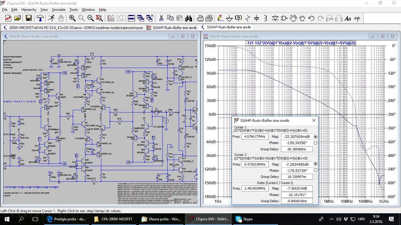

I simulated Loop Gain with the Tian probe and the result is quite suboptimal.
PM is 20 degree only and GM is 7 dB.
I like your balance approach with the Rush cascodes and will tray my amp simulation with it.
By the way I don't think that the gain differences between hot and cold inputs are important for good CMRR but equal input impedances.
I my amp the cold input gain is hot input gain-1 and I don't equalize it.
Best wishes, Damir
