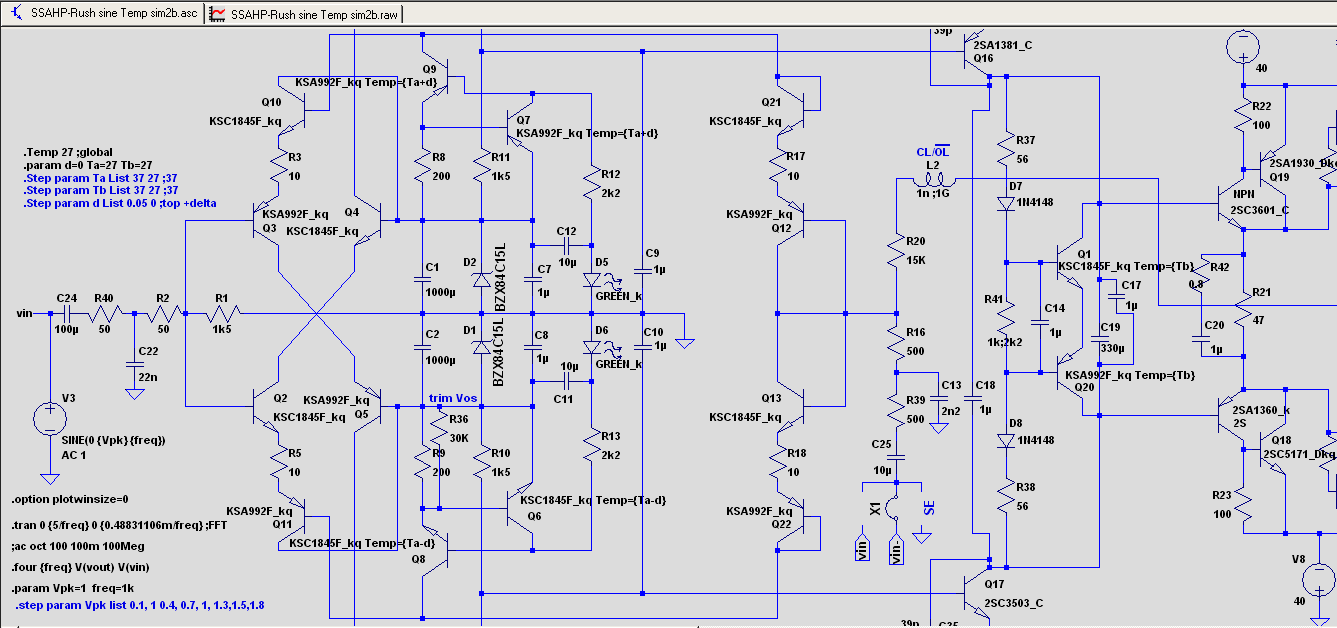

Objectives have not changed. The main is to build balanced input cfa amplifier. If you think previous input design is viable than i guess we can compare the amplifier with two input designs, their pros and cons and pick the better one.Well if the objectives have changed I can leave you to it. In my view the stability investigation amounts to scratching the surface. The design is viable, with the proviso that the differential input does not function as a differential input, as Mjona originally observed. If you want easy gratification go with what you have and I won't bother improving the design.
Th problem with original input design is doubled gain 45db with balanced signal feed and 26db with SE input. Obviously it can't be used as balanced in current state. I couldn't find a solution of this, if not consider the noise. Perhaps it's possible to make it working for the one who know how to do this but not for me.
Ian's rush pairs input design seem to be basically stable. However I couldn't run square wave sim with previous Mjona's setting and there was Spice error when I tried to ground cold input to test as SE.
I have attached my simulation. This uses the settings given by Bob Cordell on his web pages.
Just interesting. What did you mean, which setting?
Anyone tried to sim with square wave input? Is it possible to use it as SE?

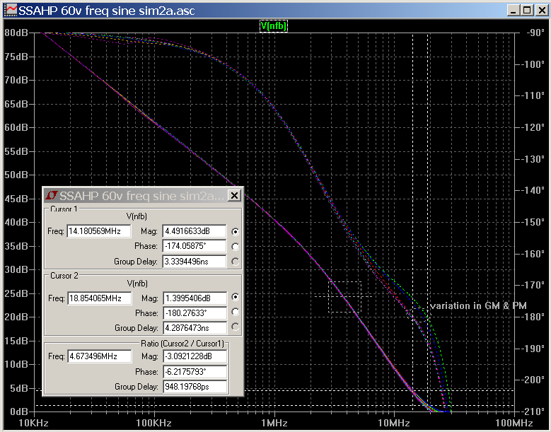

So, when phase reaches -180° the gain has fallen to -25dB, right?

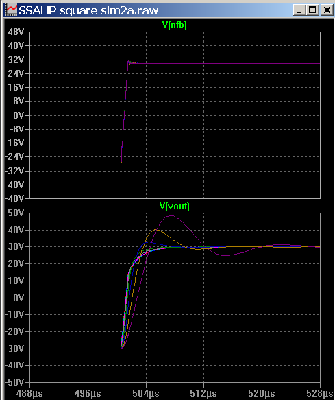

The attached files have been modified to do most of the stability checks. The Zobel is used in all cases.
The 1st plot shows the open loop gain-phase with CL stepped to 1uF. The output inductor has been reduced to 5uH to show the variation in phase when CL is stepped. This was done SE and in closed loop (CL) the LF gain is 24dB. BTW I added a jumper to select SE and Balanced input.
To check stability put the cursor on the 24dB point and read the phase lag. The difference with -180 deg is the CL phase margin. Put the cursor on -180 deg and read the gain. The difference between this gain and 24dB (CL) is the gain margin which needs to be negative (attenuating), ie less than 24dB so it doesn't oscillate.
In the first plot I show the range of phase readings where the phase goes through 180 deg as CL is stepped; a range of 6 degrees less phase margin with 1uF compared to no CL. So it is stable for all CL's to 1uF🙂
The 2nd plot shows the step response at the load and before the inductor (called "nfb") with CL stepped. Very little ringing appears at the nfb output. After the inductor the usual ringing appears with 220nF and above. So ordinary speakers (typically <1nF) will not cause ringing, only ESL's.
The 3rd plot shows the step response at "nfb" output with a fixed 200nF and the input level is stepped up to clip level. There is some ringing in the 9V to 36V range. Also at clip recovery has some sticking with the usual step, then on entering clip there are some wobbles that may need checking. Sticking after clip here is fairly good. Adding more damping with more compensation capacitance could help but usually increases THD values.

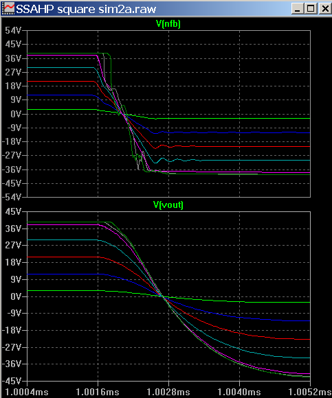

The 4th plot is like the 3rd but with a 20kHz sinewave. The pre-clip wobbles appear, and the post-clip sticking with some ringing as well. I would pass this amp as stable for clipping. Probably a real one using these values will need more compensation because of neglected inductance's in the power stage like track inductance's and capacitor ESL and ESR's. But still a good starting point to build unless someone can find some other issues.

It work for me without Zobel as well and complies with Spladski' advise regarding stability without Zobel network.The attached files have been modified to do most of the stability checks.
I also think C36,37 and C14, C17 can be deleted, I can't see any change in simulation without them.
If you don't mind, a few things I would like to ask you.
What is a purpose of increasing R21 to R47 over R15? Your schematic works the same with 50V front end, if I'm not wrong, which is more practical than 60V.
As I see you are feeding the same positive phase signal into hot and cold inputs. Why not reverse one?
Do you know hot to measure gain balance of both inputs in Spice? In the schematic bias currents are not the same for hot and cold inputs (4.57mA, 4.47mA, 4.33mA, 4.33mA).
Also with such currents input transistors will be hot. Can we reduce them to 3.5-4mA and the amp remain stable, just to be on safe side?
What is an output resistance of this circuit?

Not sure what you mean by "R21 to R47". R15 is an emitter degeneration resistor for the VAS. It provides thermal bias stability for the VAS which also affects the power transistors idle current.If you don't mind, a few things I would like to ask you.
To get it working properly with 50V auxiliary rails reduce R10=R11 to 1k5 so the zener's have about 5mA.
I hope not. My last circuit was set so the inverting input was fed with an inverted signal from E1 (set to a gain of -1). You can check this by clicking on the inverting input then the noninverting input after a run to display each input signal.As I see you are feeding the same positive phase signal into hot and cold inputs. Why not reverse one?
Place the cursor over the base of Q2 then Q3, the difference is the input bias current to ground. It mainly depends on beta mismatching in Q2 and Q3. But in closed loop there are a host of other things that affect the matching of Ic(Q2) and Ic(Q3).Do you know hot to measure gain balance of both inputs in Spice? In the schematic bias currents are not the same for hot and cold inputs (4.57mA, 4.47mA, 4.33mA, 4.33mA).
The main mismatch appears to be the CCS's Q8,Q9 etc which means a trimpot is needed to trim out the DC on the output since the PNP's can't be matched to the NPN's. One option to get low DC voltage on the output without a trimpot is to use 0.1% resistors in place of the CCS's. I'll try this later.
As for reducing dissipation in the input transistors I don't see this is a serious problem for Q2,Q3 at 60mW. Note Q4,Q5 are not a concern --they are cascodes that act as series regulators to reduce the voltages on Q2,Q3 to +/-15V to keep them fairly cool.
I have reduced Q2,Q3 current to 3.4mA (attached) by increasing R8=R9 to 2k and reducing R41 to 1k (for the same output stage idle current), then R36 (across R9) to 30k to trim the DC on the output. This reduces the dissipation of the VAS from 1W per side to 350mW.
33m ohms at 1kHz. See attached circuit it has a current source added to inject 0.5A sine into output. Turn off the input sine, set the current source to 0.5A peak (no DC offset), Run, then measure Vout peak-peak. Rout=VoutPP.What is an output resistance of this circuit? Thanks.
Q1,Q20 should be placed on top of output devices, C14 will remain on PCB. If considering long wires connecting Q1, Q20 in the circuit, it still make sense to leave it than you are right.

The attached capture shows changes so you can also sect "Vin" to test the CMRR. First use an AC run with the jumper on "Vin" for the inverting input.Have you measured CMRR? What about input impedance mismatch, is it possible to equalize it?

First R8,R9 are chosen for the current through the input Tr's, then R6,R7 set the VAS current, then R41 trims the idle current in the power transistors. I have not attempted to find the optimum idle current for the power stage for my latest changes, looks like the optimum (minimum THD at say 20kHz) is with more than 220mA though V7. I'll leave that for you to find.About R8-9, R36 change, you wrote there is only 60mW load on input transistots, than no need to lower idle currents I guess and sacrifice performance.

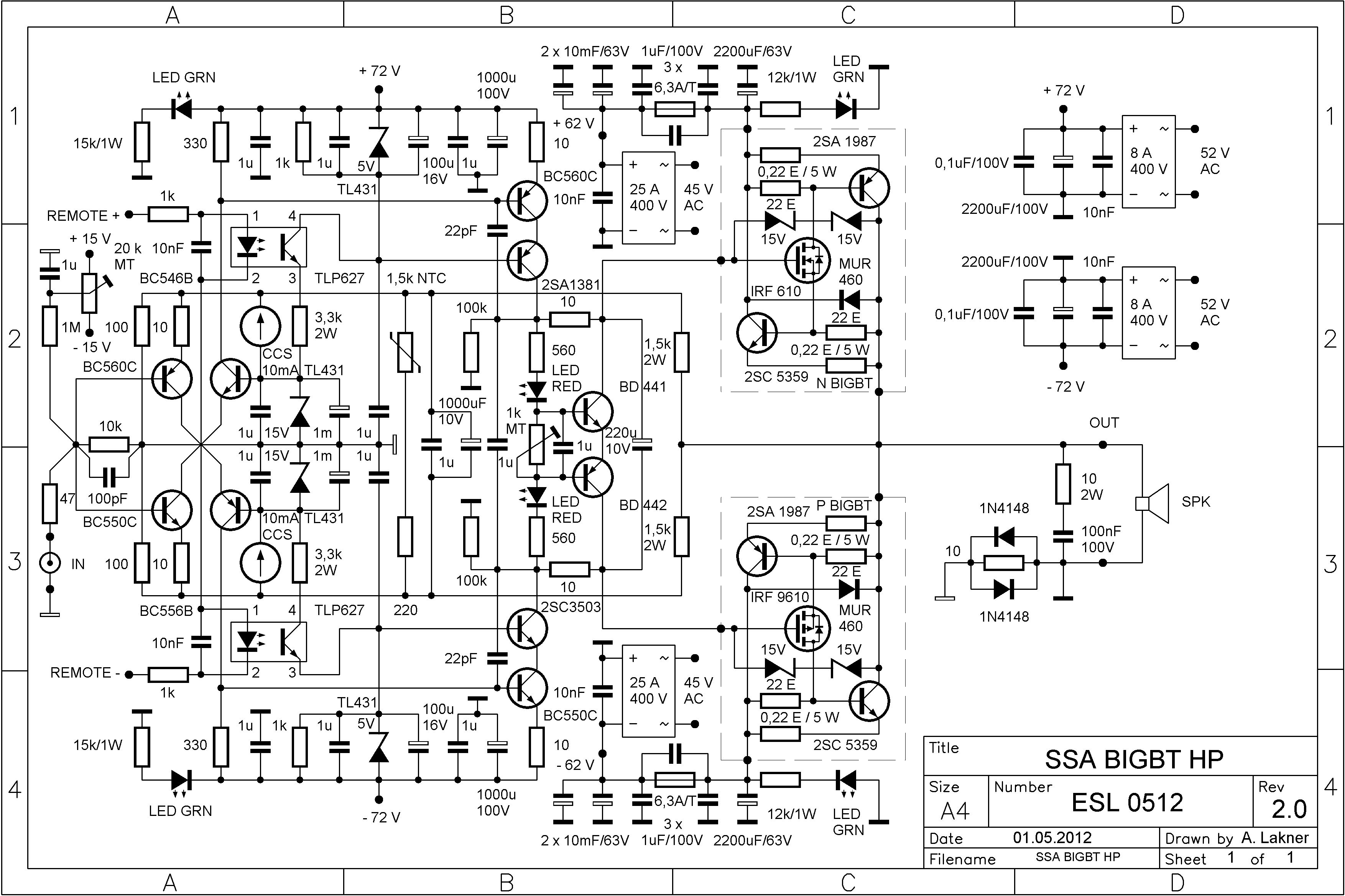

There was similar Bal. design guided by LC and was supposed to be built but I haven't been able to find a reported results later on in the thread.
http://www.diyaudio.com/forums/solid-state/193923-simple-symetrical-amplifier-165.html#post2810098
