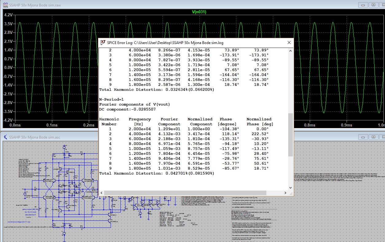

You have made other changes than these. I changed the circuit compensation and have now checked the 1kHz THD. The result is not the sort you have been hoping for.
I have little better results, 0.04% THD on 20KHz region with high capacitance on out. The main problem seem to be in the input stage. If you lower the input voltage amplitude the THD will decrease proportionally even more. Somehow instead of unify a hot and cold signals, the circuit amplifies them separately and doubles the gain which produce distortion I guess.

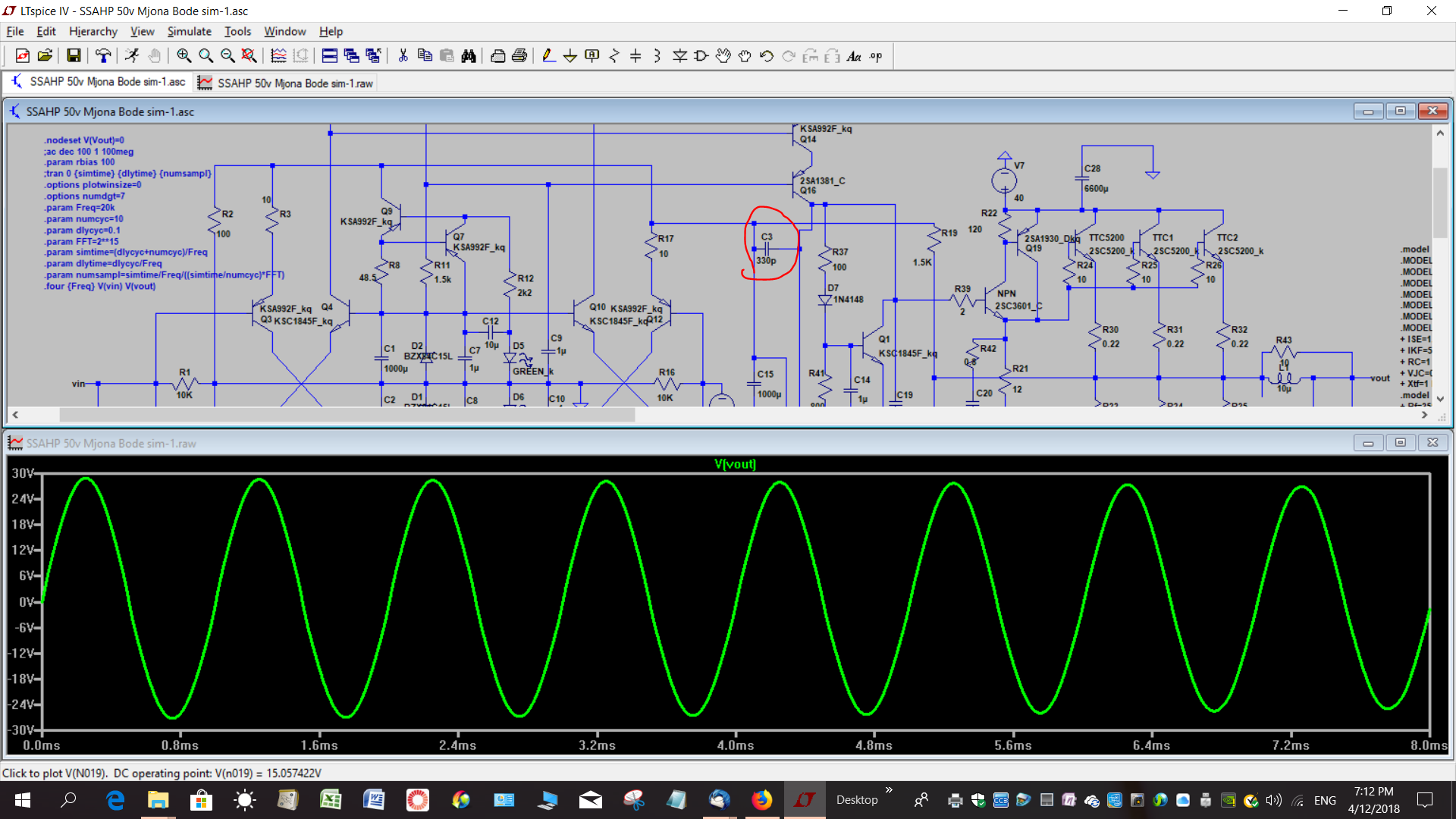

The closed loop behavior is governed by two feedback paths via R19 and R20. If these paths can be broken, then one can begin to observe the open loop behavior. Component changes in the open loop environment will yield more dramatic changes than the closed loop one. This will give you an insight into the key elements that drive stability.
The Tian probe is a sophisticated method for open loop, however there is the cheat method. Place a high value inductor (100H) in series with the output feedback to R19 and R20, and a 10000mF capacitor to ground, which effectively removes all AC components from the feedback. LTspice doesn't seem to understand Farads.
Now you can see the effect of compensation capacitor adjustments on the open loop bandwidth. The gain available at 10KHz will change enormously.

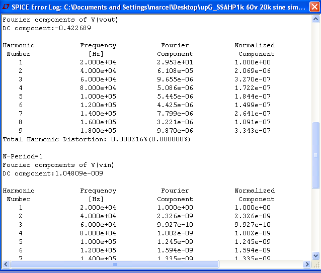

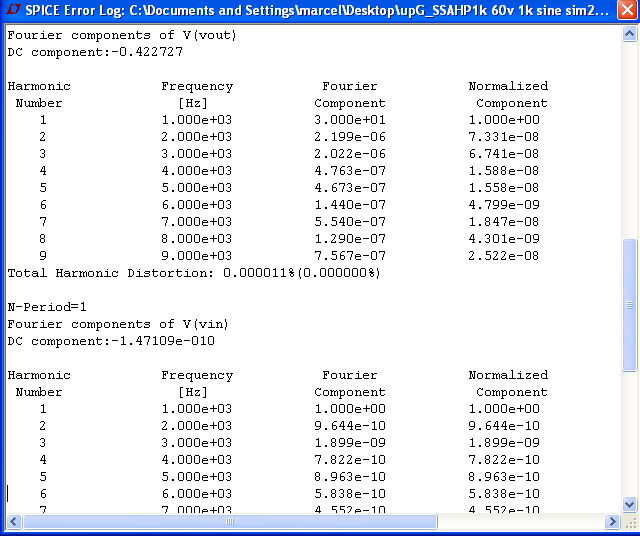

I have little better results, 0.04% THD on 20KHz region with high capacitance on out. The main problem seem to be in the input stage....

Attached is mjona's last circuit now modified with a Rush differential input stage and re-biased for similar idle current and VAS current.
The THD results at 1kHz 0.1ppm, and 20kHz 2ppm both at 30Vpk into 8 ohms

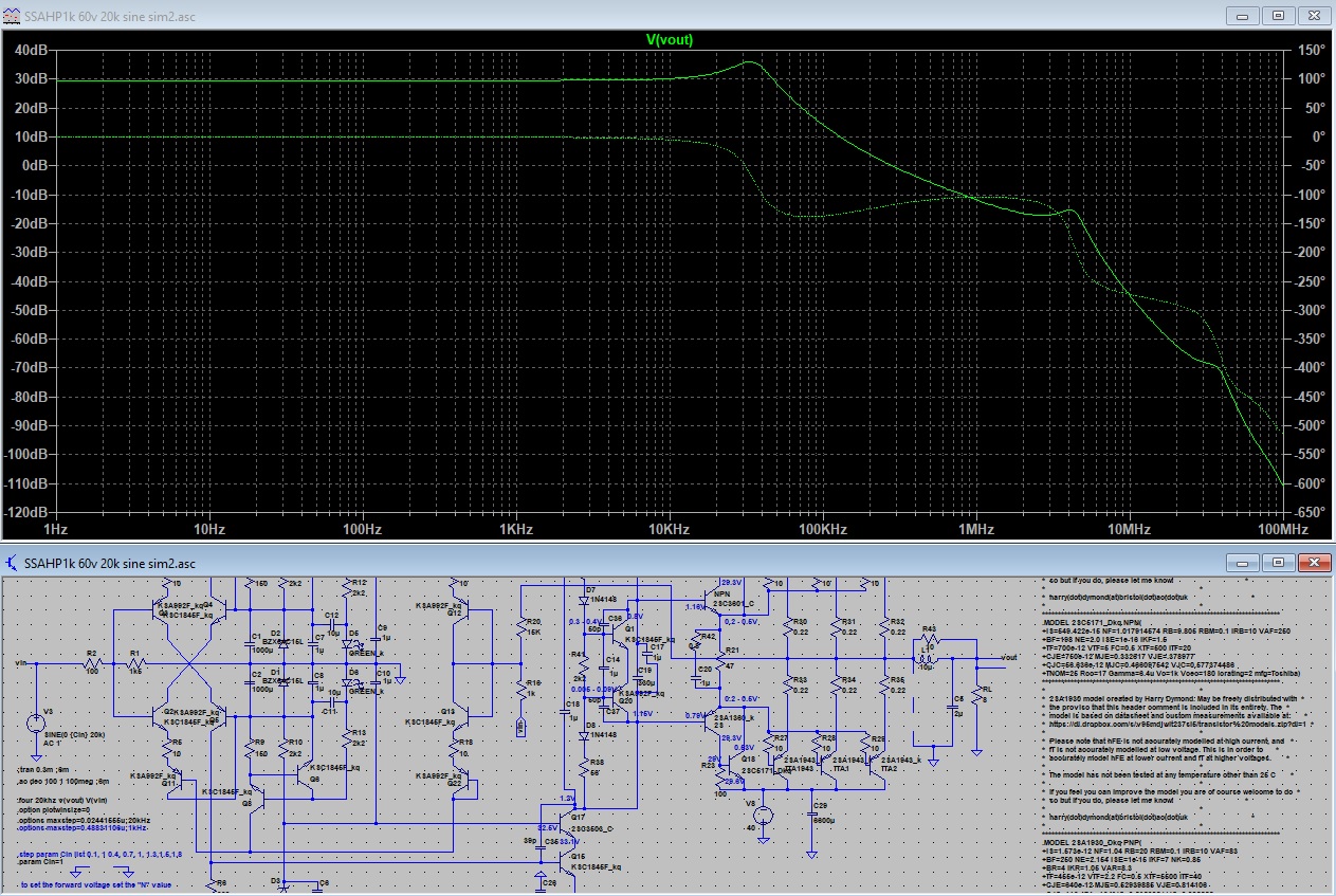

Without Zobel, with 2uF load
Squarewave sims

Good to see your AC plot. Nice going.
