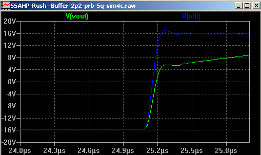

I tried a capacitor across the 15k feedback resistor. With 2p2 it improves the phase margin to 59 degrees (was 23deg) which removes the peaking in the AC closed loop plot and a slight overshoot in the squarewave plot. A 2p7 removes the squarewave overshoot. This is SE without the input filter.

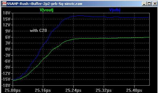

The squarewave sim circuit is attached. It includes the Tian probe to measure the PM accurately with this 2p2 capacitor (it is disabled in the attached circuit).
BTW I disconnected the cross-coupling capacitor C20+R42; with it there is some HF ringing in the squarewave in the higher voltage range, but stops when they are disconnected.
I have found a capacitor across the feedback resistor usually causes oscillation even though a simulation shows it works well. So I wouldn't feel too satisfied that the PM issue is fixed that easily. It is the first thing to try and if it works as well as it simulates then it's easy, and if not you need a plan B from a few more options that we have yet to try.

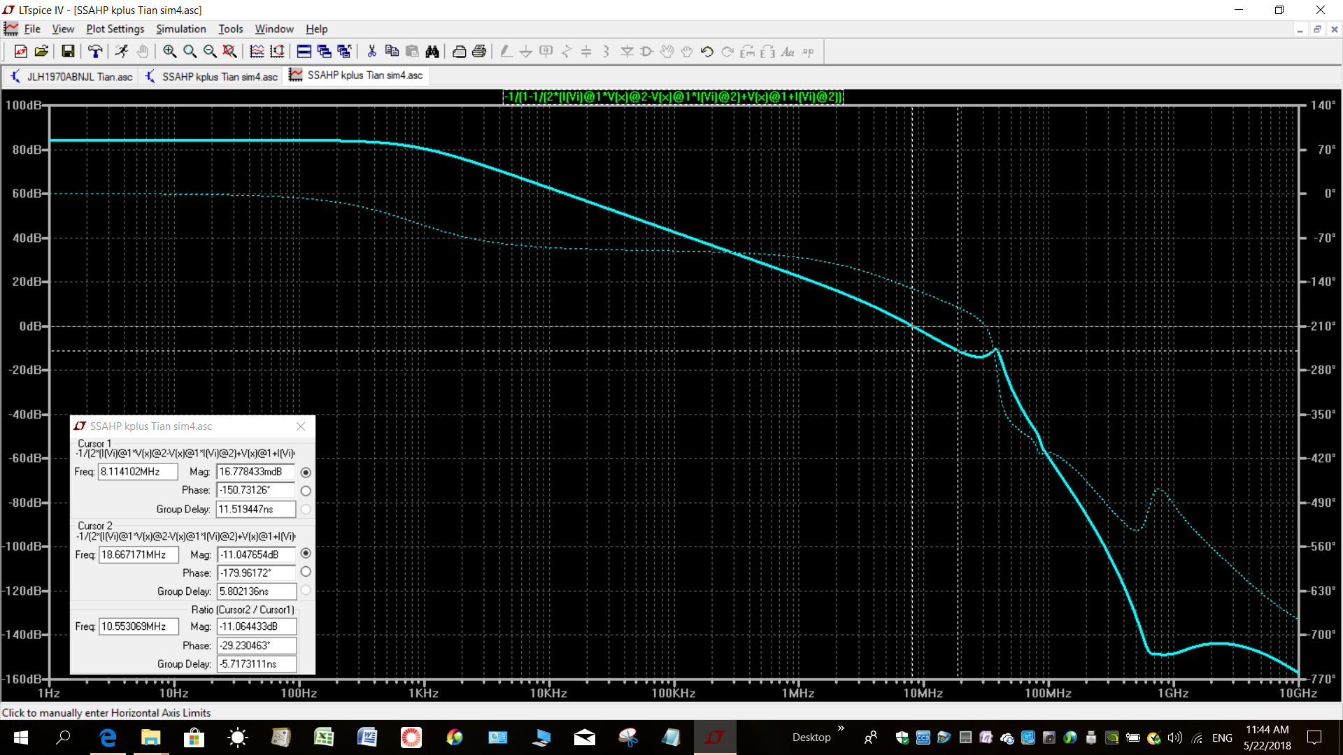

Aren't those gain and phase margins too low, below the stability recommended values?
Mine had not been a statement, but a question.
I'm just starting in using the Tian probe sim in LTS. Perhaps Ian can add the probes to your asc files, and comment on the results.
On the simulations he uploaded I got low margins. Are they satisfactory?
Hi carlmart,...Perhaps Ian can add the probes to your asc files, and comment on the results.

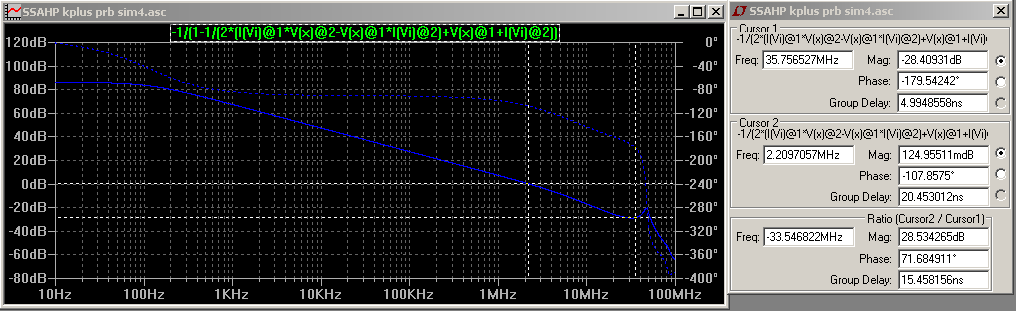

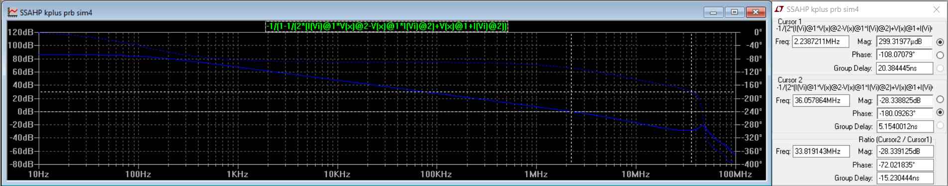

AndriyOL's sim4 circuit gives 29dB, 72 deg. See attached.
My earlier circuit in Post 564 (sim4e) giving 6dB and 36 degrees, and yes, it has no margin of safety for when building it. It needs double those figures as a safety margin to cover any modelling omissions. The post was following a series where I was trying different ways to get a bit more from the simple Miller compensation which was fixed at 39pF for a like-to-like comparison with the earlier circuits.
@All
Post 564 also raised the interesting question about the inclusion of inductors in the power transistors bases and emitters and keantoken commented on that Post 565.
The lack of model accuracy over the 10-50MHz region of our models places a degree of uncertainty on the GM and PM values we obtain using the Tian probe for instance. So we can't rely on our actual GM and PM values too much from simulations -- we need to test our built amps with a squarewave or whatever to see how close our sims actually were.
Where our GM and PM sims can help us is to compare different compensation methods in a relative way to get an idea of which type of compensation is best suited to our needs and aims.
@All

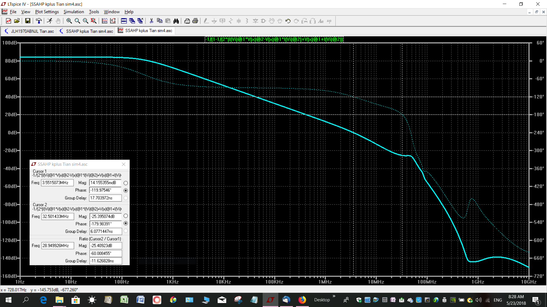

You need a minimum phase margin of 45 degrees with a gain margin of 12dB for a circuit to be stable your latest circuit comes in at 29 degrees and 11dB which can be improved.
While that might get you inside the door albeit you should increase the margins to allow for component and simulation tolerances.
The first attachment shows what you have now - the simulation I am attaching shows changes to the lag compensation capacitors C3 and C5 and the disabling C21 which is responsible for the peak issue.
To use the simulation file you need to copy the following expression and paste it in the title of the .raw file where it says vout.
Right click on this and a drop-down box will open - in this you then delete vout and paste in the expression -1/(1-1/(2*(I(Vi)@1*V(x)@2-V(x)@1*I(Vi)@2)+V(x)@1+I(Vi)@2))
After that open the cursor options so you can place one firstly at 0 dB and the second where the angle shows at -180. You can drag these cursors close as you can to these points and use the side-ways movement arrow buttons - beside your number key pad to the right on your keyboard - to make fine adjustments either way.
This one should be better.

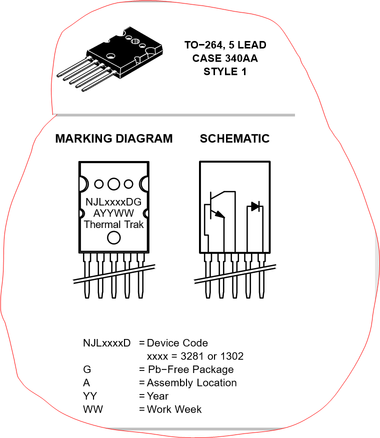

Thermaltrak transistors include diodes. The attached image shows the lead outs for emitter and collector.
This is by design to make it easy for the input leads to run closely as possible in order to minimise radiated magnetic fields into conductors in the proximity due to current changes due to OP switching.
The tracking diode leads run in parallel for similar reasons and if there is any length in the path of the wiring the solution is to twist these together.
