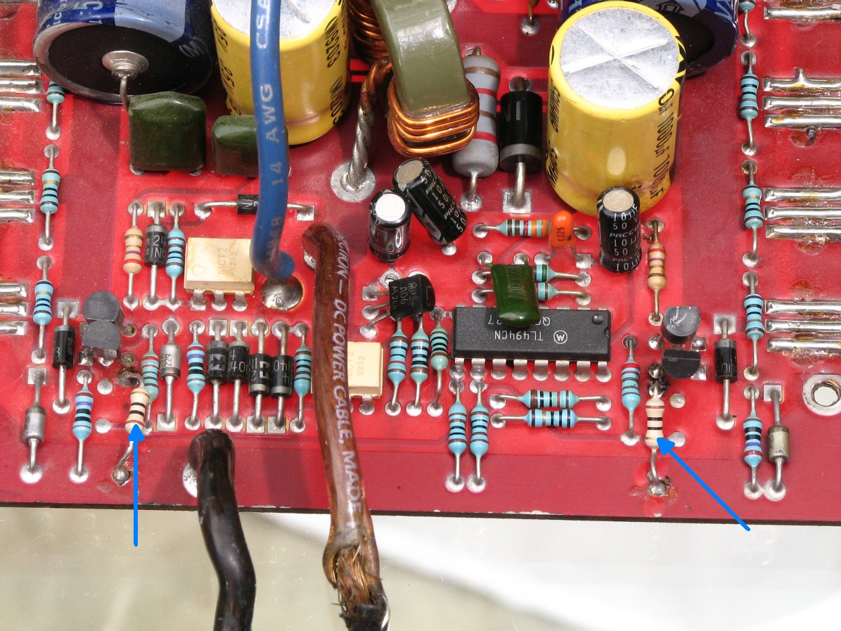

Once again need help fixing Orion HCCA 225 Digital Reference
Will you show me the resistor you mentioned? Are they the ones I have circled in yellow in the attached photo?
The resistor that is connected to it was bad. I also found the diode in the corner of the right side of the board was bad. I replaced both. Voltage readings are now the same. Amp now powers up without the PS Fet's getting hot.
