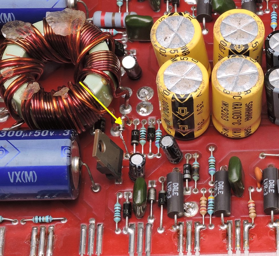

Voltage across that diode is +20.94 volts
My power supply is not adjustable for voltage.
Can you read the number on the diode?
On the other board?
I think the regulated voltage for these amps is about 18v. If the diode in your amp is the original and is a 21v diode, there may have been different versions.
On the other board?
Had to pull it to read it. It is a 1N4748A. It is a 22v diode. It is the original diode. The other board has the same diode in it.
