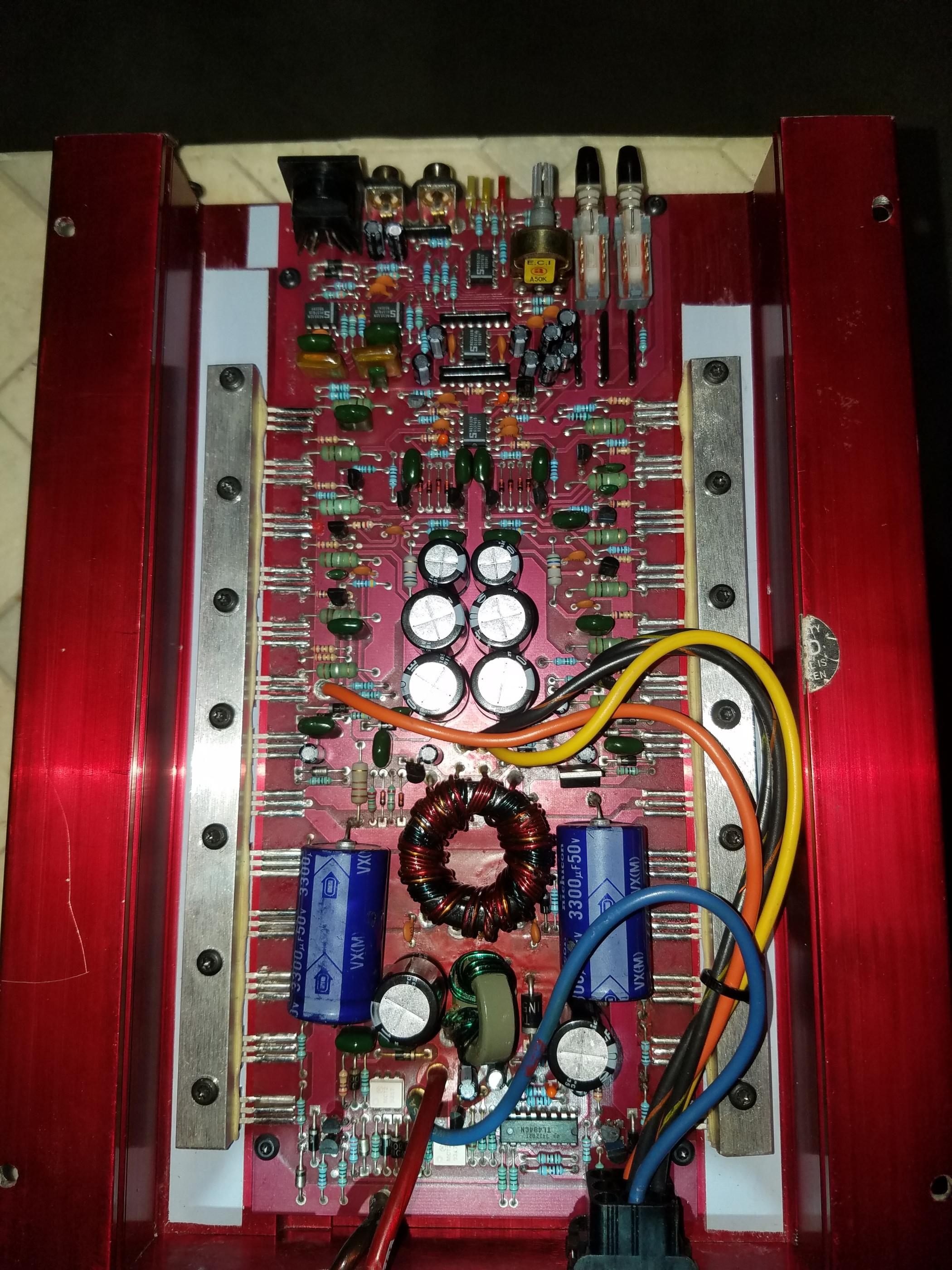

If you have drive back on both sides, you can remove the jumper on the 6488 and reinstall the resistor from 4-7 on the 494. I think that's where we were before the FETs blew.
Not applying any heat, the amp only powers up for about 30 seconds before shutting down. Ounce the voltage on pin 4 of the 494 rises above +2.5 volts it shuts down. Should I change the resistor to a lower ohm one? If so, what do you suggest? It has a 10k on it now.

I put a 5.2k in it and it seemed to have stabilized it just enough to test with the heat gun.
When I apply heat to the area of the 494 the voltage of pin 4 goes high.

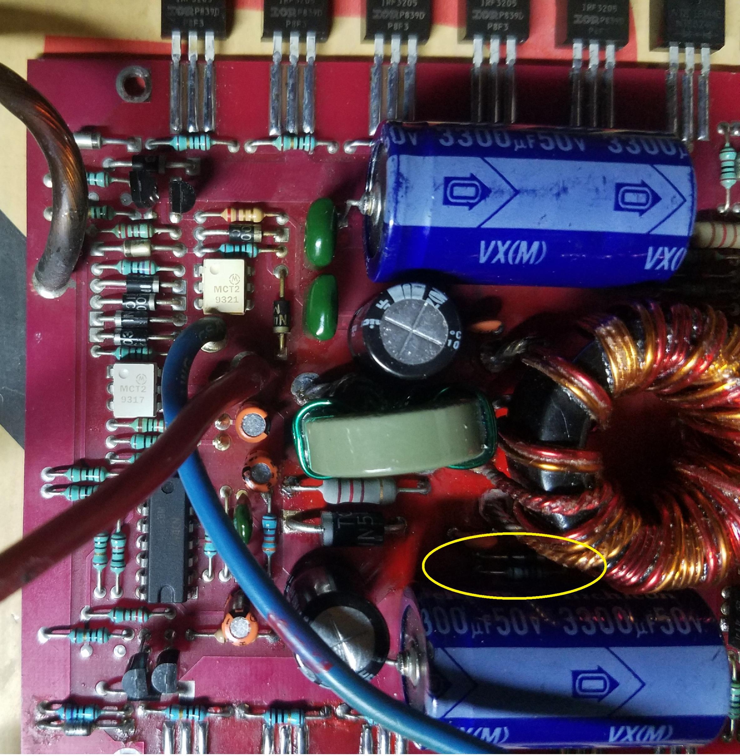

Touch your soldering iron to one end of the 494 (not in the center) for a second or two to see if it's the sensitive component.

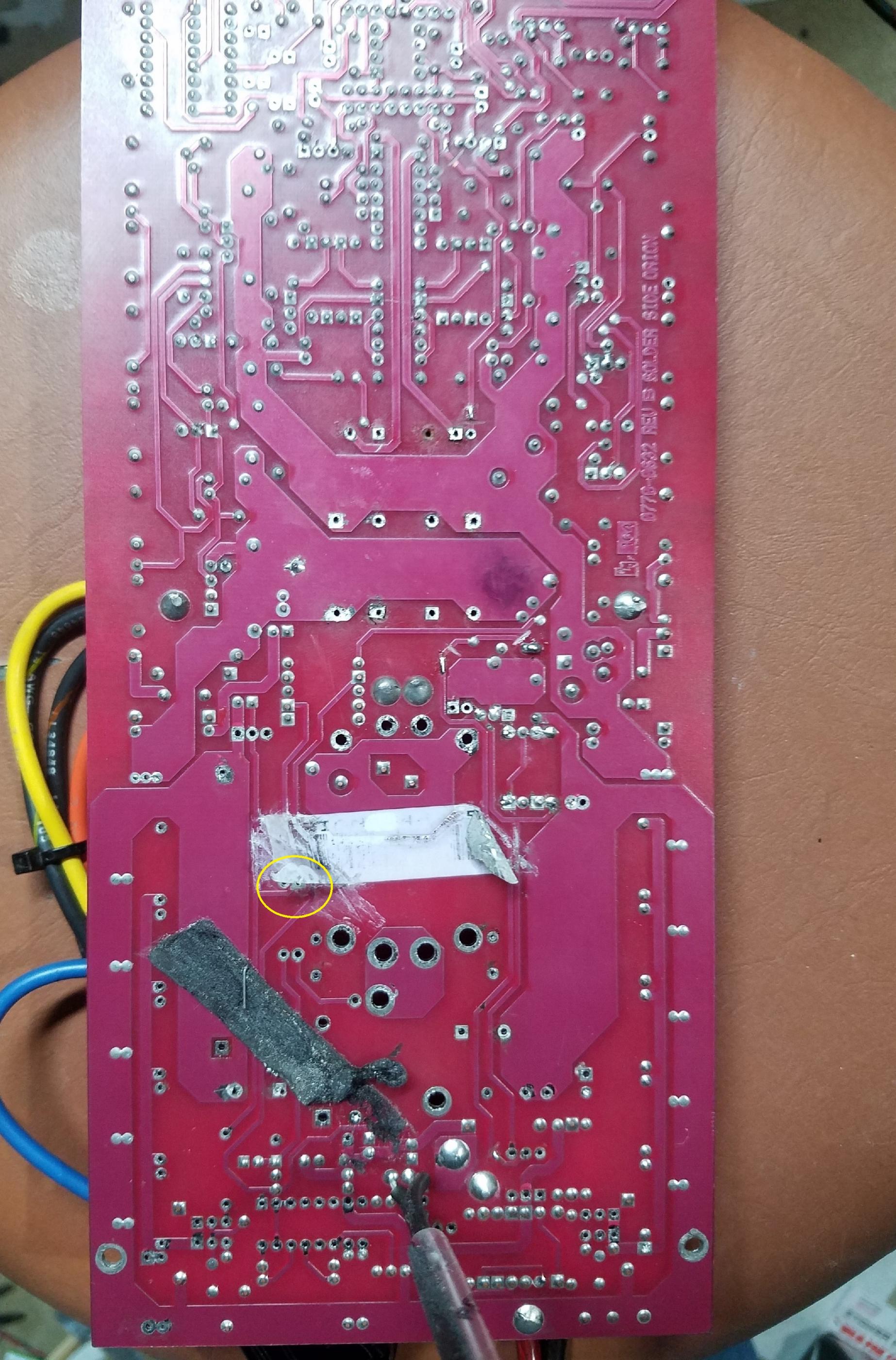

I found the heat sensitive component, the cap that is in circuit with pin 4 but it was not the entire problem. While the cap was out of circuit I checked power on the pad and it was still high. Following the trace I found two solder pads that where ever so slightly touching, a diode and resistor next to each other(see photos for reference). De-soldered and re-soldered both. Pin 4 voltage is now down where it should be and amp is powering up as it should with resistor removed.
