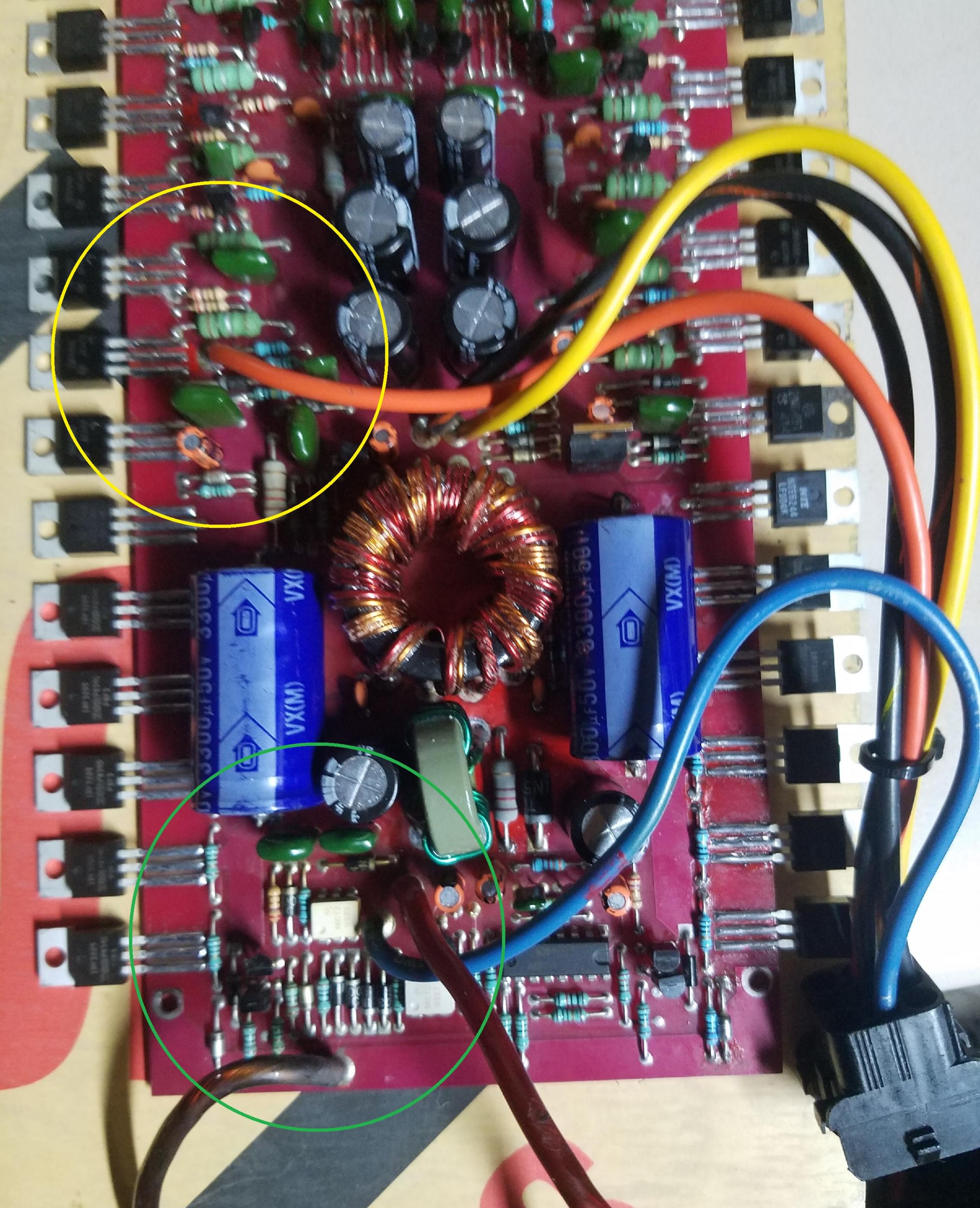

It definitely didn't like the heat gun. I'm not a hundred percent sure but the area circled in yellow seemed to be sensitive to the heat. The area in green is a possibility as well but can't be certain as the amp was already shutting on and off at that point.
As I was saying it definitely didn't like the heat gun as the amp no longer powers up at all now. It is shutting down my power supply. It also shuts the power supply down with no power being connected to the remote wire.
It blew one of the PS Fets. The same one it had blew before on the left side of the board (side with the yellow circle in the above photo). I pulled it and tried to power the amp up, it immediately blew another PS Fet on that same side of the board. I pulled all of PS Fet's on that side of the board. It is no longer shutting down my power supply.

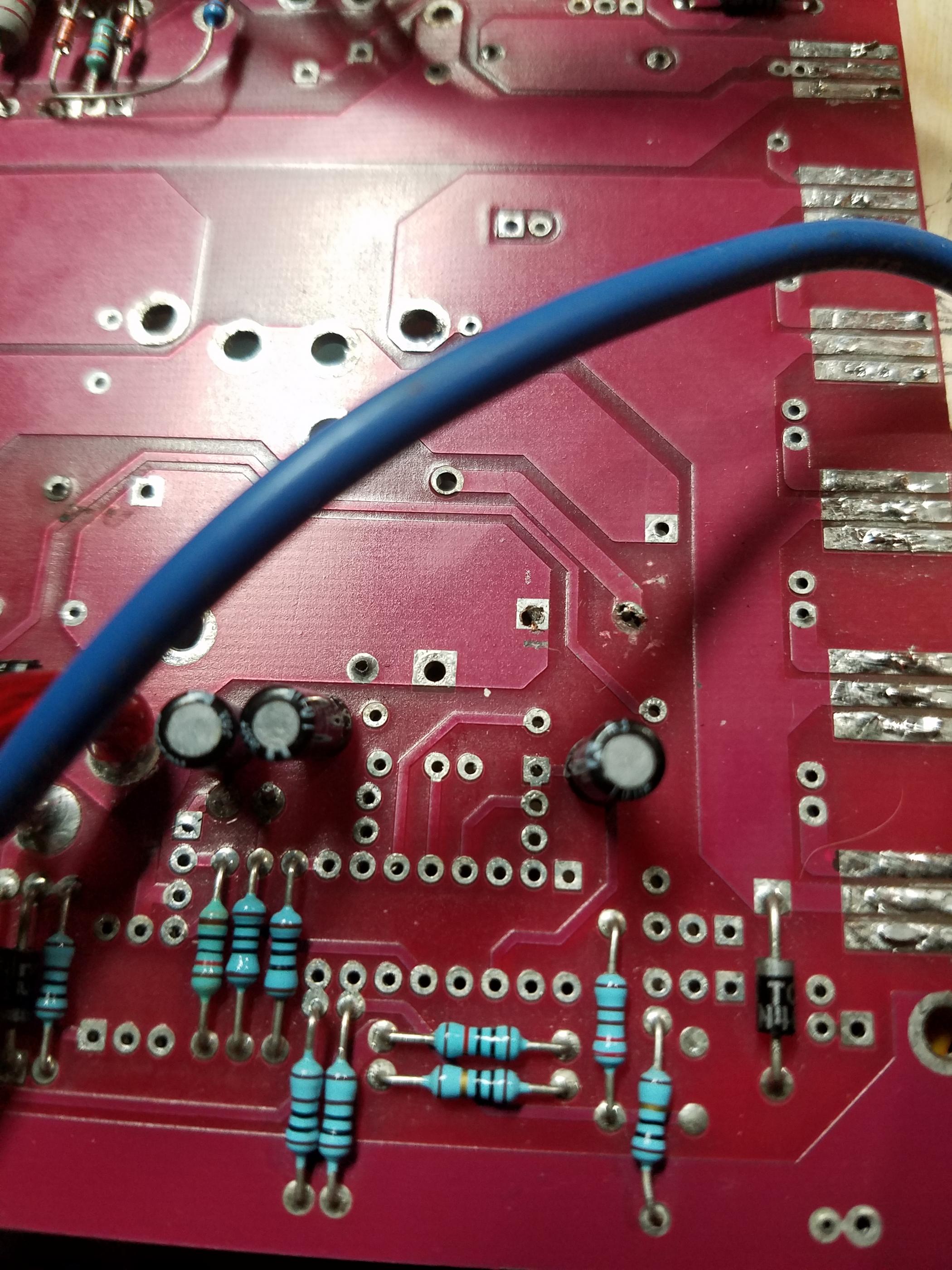

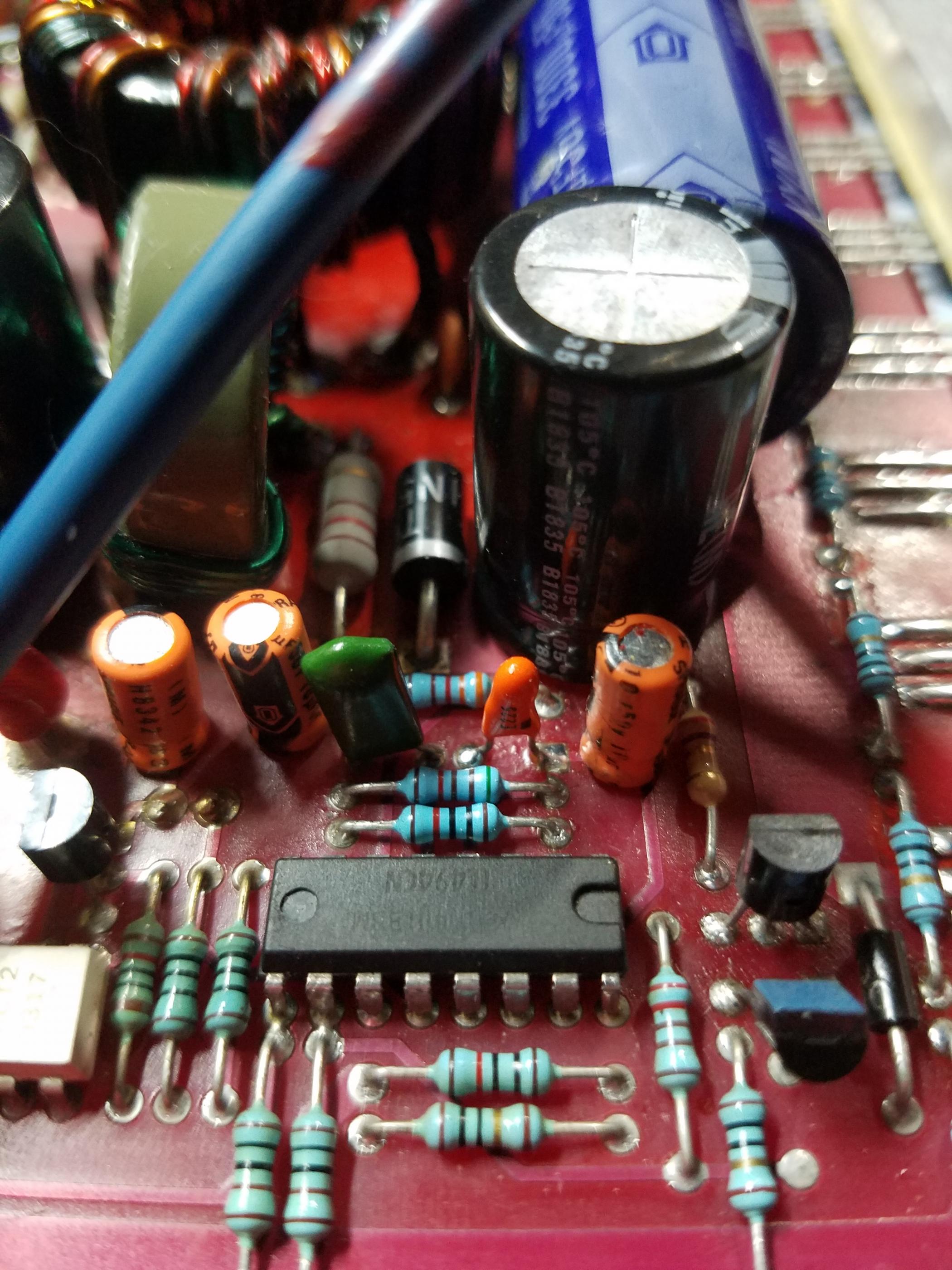

Best I can tell, pin 14 drives pin 4 (attached a photo of the trace). The only things in that circuit are one electrolytic cap and one tantalum cap(see second photo). Those have both been replaced. Do you think it is possible one of those is causing it?

I'm not a 100% certain which area was effected by the heat gun. The area that seem to be most effected, that I circled in yellow in post #142, I can find nothing reading out of specs.

Heat shouldn't cause the amp to malfunction. Even if that's not the only problem, it's something that needs troubleshooting. You may have to use something like a piece of cardboard to block the heat from heating everything in the area to narrow down what's so sensitive.

I solved the power imbalance that was going on which was causing the PS FETs to overheat. I had pulled the MSPA06's and the MSPA56's to test them. They tested good so I tested the pads for voltage, while I had them out of circuit. Found voltage on pad 2 of the left MSPA06 driver. Something conductive was on the board in that area. Not sure was it was as it wasn't visible. Cleaning the area removed it.
I also pulled the 494 cleaned that area of the board and replaced it with a new one. Pin 4 voltage is still high. I have installed the jumper back on it. I'm still at a complete loss as to what could possibly be causing it. Do you have any suggestions on what I should check or do next?
