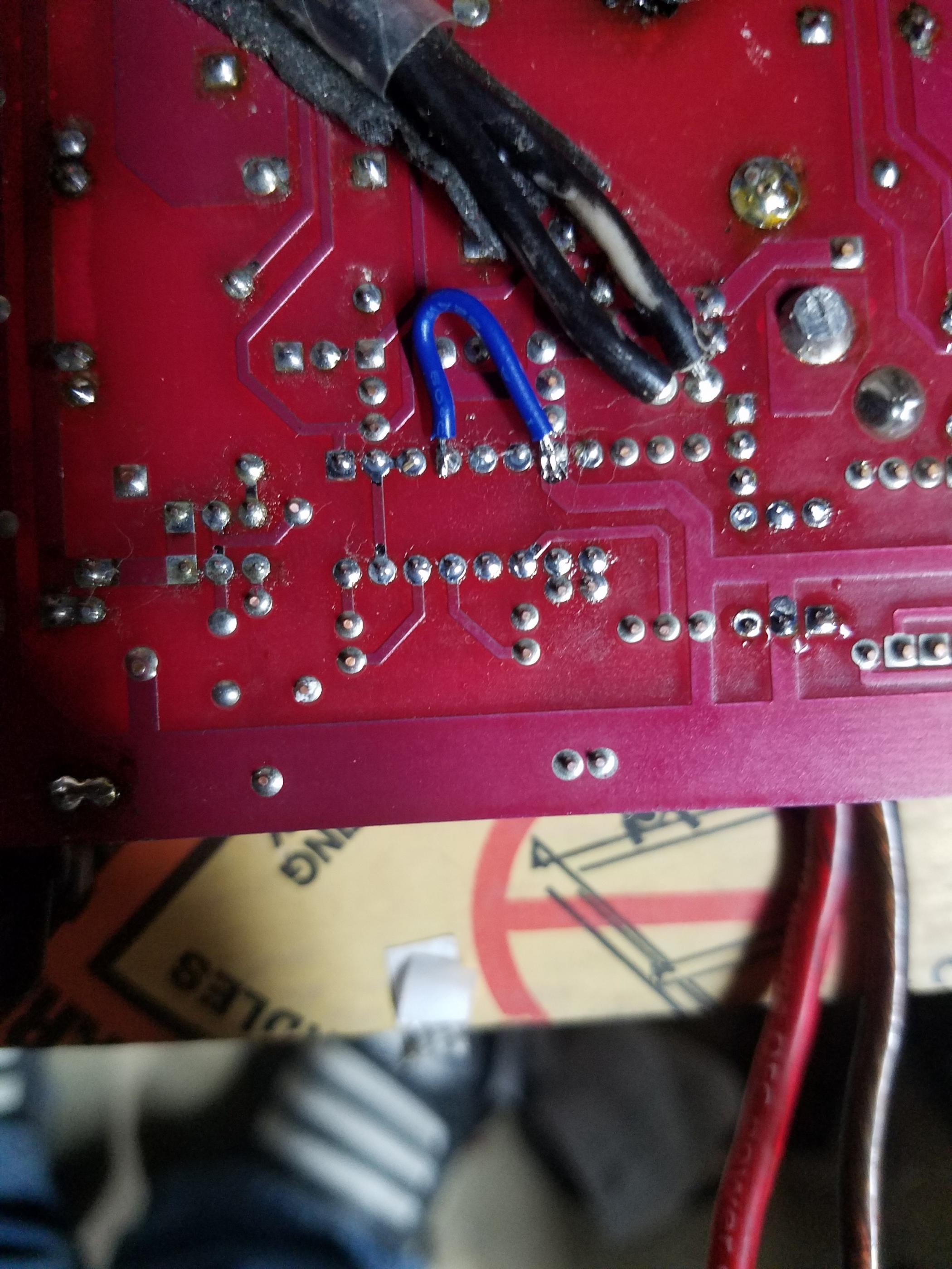

I connected the jumper. The amp powered up(red light on). The rail voltage across the rectifiers is +42.8 volts. I also monitored for components getting hot, nothing was heating up.

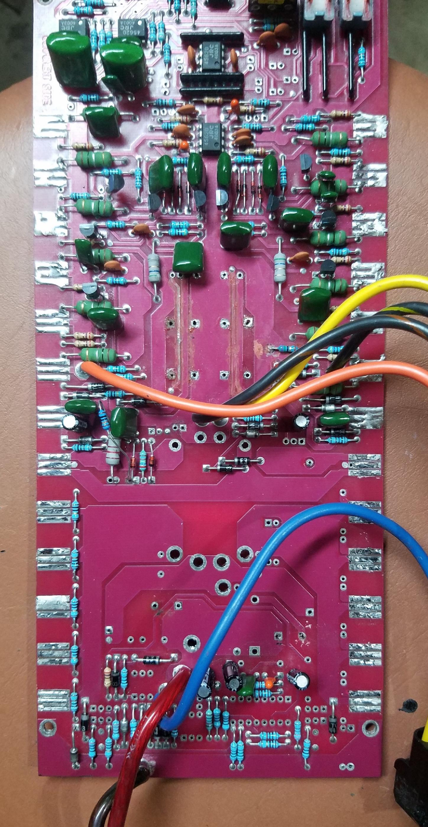

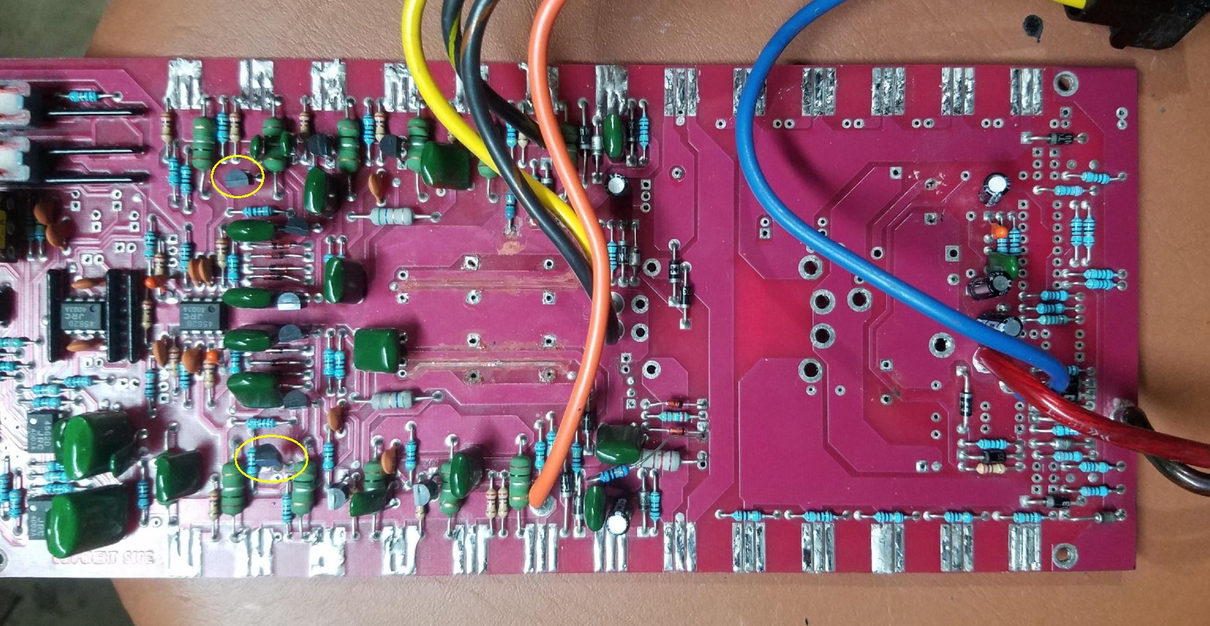

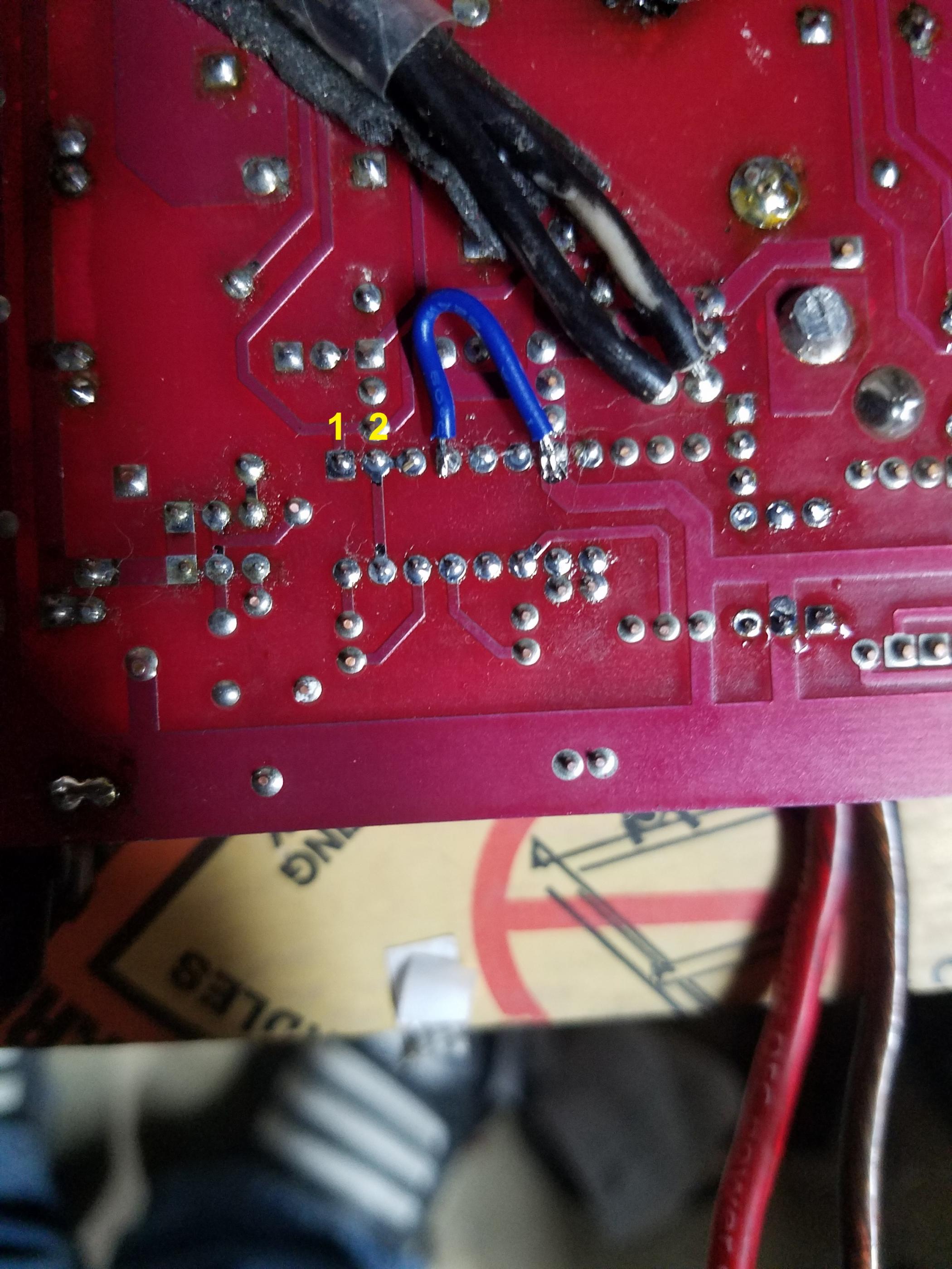

Sweep with the probe showed no voltage. Attached are pictures of the trace on the other side of the board. There is a resistor on the top side connected to the trace for pin 1 (the yellow "2" is on top of one of the pins of that resistor in the one photo).

On the amp I have here, removing the 6488 did nothing to the voltage on pin 1. Pins 2 and 3 follow pin 1. That's why they all changed. You can reinstall the 6488.
Pin 1 is driven by the protection circuit transistors. Pull them to see if that allows the amp to power up.

I pulled the jumper since it was powering up with it on. Do you want me to put it back and then check the voltage on pin 1 of the 494?
Jumper is back on. Amp did not power up. Voltage on pin 1 voltage is oscillating between +0.3 and +0.15 would intermittently briefly spike higher up to +1.6 volts.
