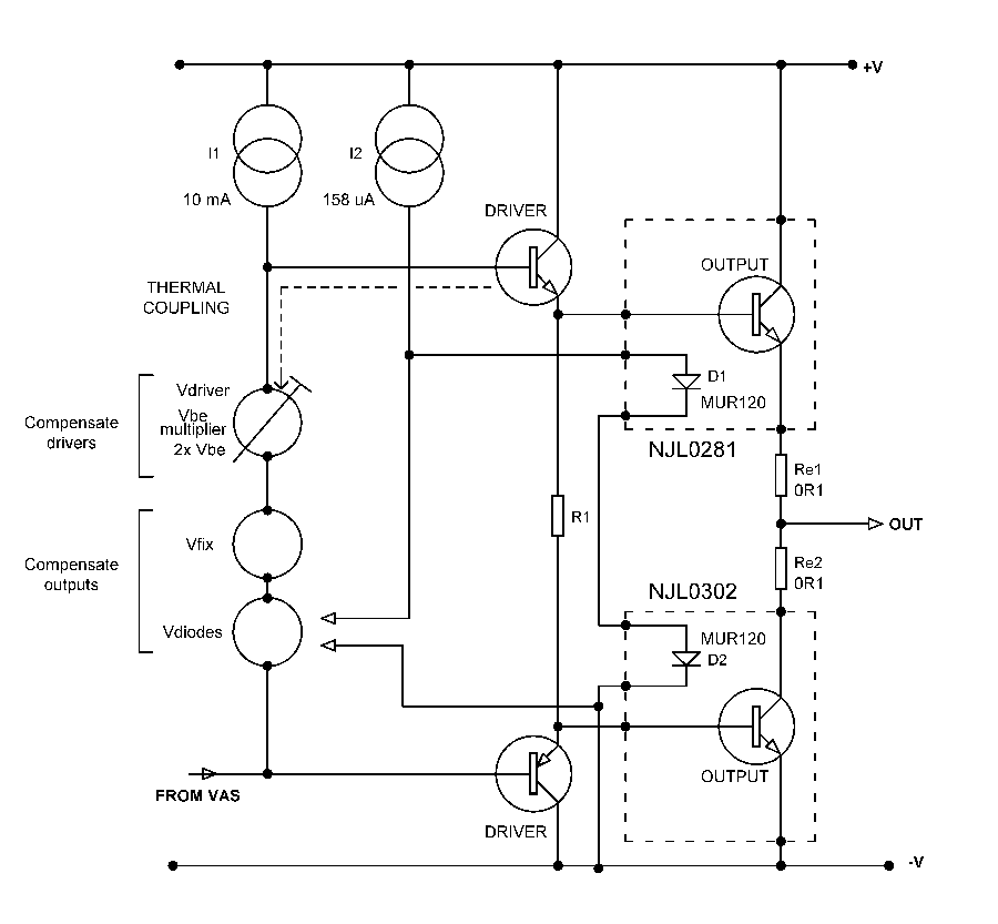

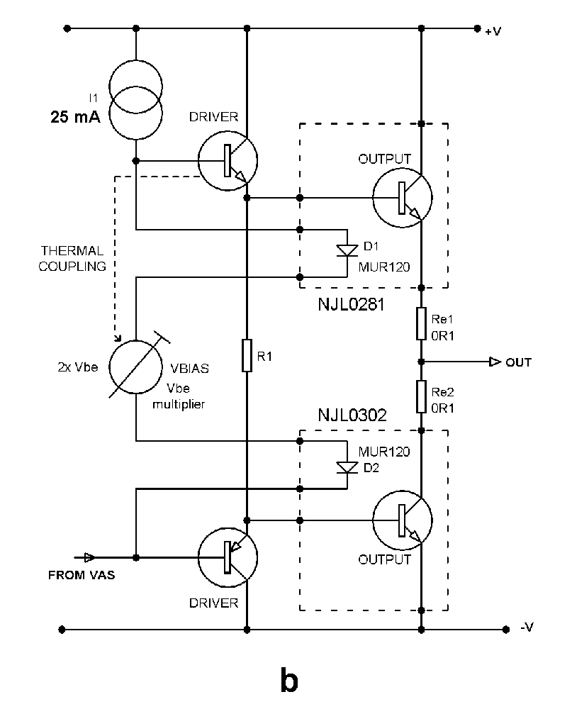

Hi JPV, sorry I couldn't get back to you yesterday.
My first attempt at applying the ThermalTraks was to assume that the diodes would be used to attempt to directly cancel the transistor Vbe voltages,which means running the diodes at 25 mA (for transistor Ic=100mA) and accepting that the tempco would not match exactly. The compensation should, I think, still be much better than conventional methods but it is certainly not theoretically perfect. This is the approach I used in the attached circuit, which I think of as Plan A. I have never tried to run a VAS at 25 mA,and I fear the linearity might be worse. Certainly TO-92 transistors will get too hot for amplifiers above 100W/8R, which is a problem as the bigger devices tend to have less beta. A VAS buffer may be needed.
I accept what you say about increasing diode tempco's by reducing the current. I have just reread RA Pease's thoughts on it; http://www.national.com/rap/Story/vbe.html and and he certainly quotes - 0.2mV/°C per decade decrease of current. Our diodes have a tempco of 1.7 mV/degC and the transistor Vbe has a tempco of 2.14 mV/degC at 25mA (Bob Cordell's figures) so diode tempco needs to be increased by 0.44 mV/degC. The diode current therefore needs to reduced by 2.2 decades, or 158 times. That gives us a diode current of 158 uA. (not a typo) This is much too low for a VAS operating current so we need a circuit that will replicate the diode voltage at much greater current.
The lower current is clearly not going to give us enough diode voltage to cancel the transistor Vbe's directly. However we cannot use a conventional multiplier circuit as in multiplying the voltage we also multiply the tempco. What is needed is to add a fixed voltage to the diode voltage. If we assume we are using an EF type 2 output, then we also need compensation for the driver Vbe's which can be done with a conventional Vbe multiplier circuit, as used in Plan A.
Another point is that a diode current of 158 uA is quite small, and whatever circuitry we use will have to have its base currents looked at carefully if it is not be inaccurate.
It therefore looks as if we need a system like that shown conceptually in the second diagram. Vdriver compensates the driver Vbe's. The fixed voltage is derived from black box called Vfix, and the diode voltages are replicated by a black box called Vdiodes. I am calling this approach Plan B. It should give much better compensation than Plan A, but it's going to take a bit of designing...
What do people think?
I'm not sure if I can put two pictures in one post, but I'm about to find out.
Douglas
But if we put the diodes in the upper leg of the Vbe multiplier base circuit (like leach) their tempco won't be multiplied. And 160µA sounds like a reasonable current to have flowing there, just use a buffer for the Vbe multiplier transistor and it will have enough beta to be stable with vas current.
Or is your worry that when doing this the tempco of the vbe multiplier transistor part will be too high, decreasing idle current with increased ambient/driver temperature? But this should be pretty stable.
