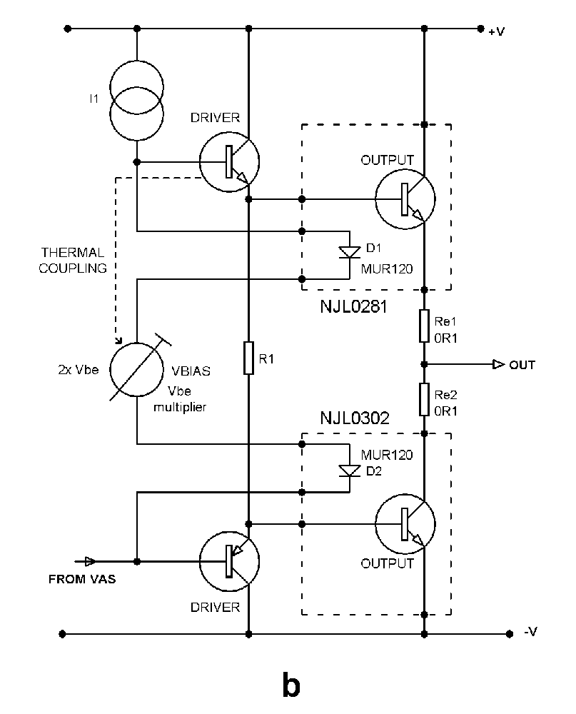

It is expensive to use more NJL output devices just to get the right number of diodes, and in my opinion the application note misses the point utterly by trying to compensate driver temperatures with output temperatures. That app note really is a bit of a disgrace.
My first thought was the attached circuit, which is I think what you might be looking for.
I would be glad to have people's comments on it.
Douglas

Hi Doug,
You are so very right about the app note being wrong to lump in driver Vbe with power transistor Vbe, as if all were alike. The circuit you show looks like it should work.

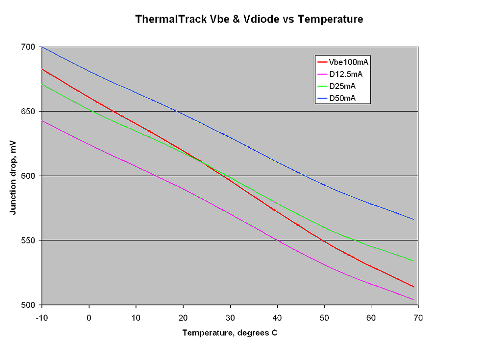

One of the key things to bear in mind is the tempco matching of the ThermalTrak diode as compared with the tempco of the ThermalTrak power transistor; one has to be very intentional about the current one runs through the diode to get the desired tempco, as junction drop tempco is always a function of current density.
Another approach is to build the tracking diodes into a separate Vbe multiplier so that their net effective tempco (mv/C) can be multiplied by the amount desired while running the nominal VAS bias current through the diodes. Then a second Vbe multiplier can be used to mop up the remaining bias spread needed by the drivers et al. Lots of different possibilities here.
Bob

Hi Bob
From reading the other thread I gather that you have determined that the transistor Vbe temperature coefficient is -2.14 mV/ ºC while the diode has -1.7 mV/ ºC, and the best voltage matching occurs when the diode current is a quarter of the transistor Ic. That suggests that my circuit will leave the output devices somewhat under-compensated, even if the respective currents are scaled correctly. Guessing at a quiescent Ic of 100 mA, that means 25 mA through the diodes, which suggests a VAS buffer would be required.
I think you're right- some multiplication of diode tempco is required.
Douglas

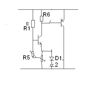

Something similar to this could be used to multiply the temperature coefficient of the thermal traks. For a 2-stage darlington output the multiplication will be about 1.5 making the temperature coefficients about the same. For a triple darlington the multiplication will probably be too high - but this can be lowered by inserting diodes or diode connected transistors (probably 2) in series with R1. These can be used to sense driver transistor temperature.

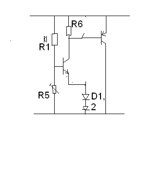

megajocke said:Or you could do this - making temperature coefficient of thermaltrak diodes adjustable. Pot turned upwards gives no multiplication, downwards multiplication increases. Bias voltage needs readjustment though when that is adjusted.
Is the simple Vbe multiplier like the Leach one not the easiest and perhaps the best because very low interraction
The potentiometer in the lower leg of the base tunes the Vbias and the diodes in the upper leg tune the drift of the drivers and of the output transistors for minimal distortion at high temperature. This is easy done by adjusting // bleeder resistors.
JPV
It is easy but if you have only 1 pair of outputs in a smaller amp than the Leach it might be possible the temperature coefficient of the diodes is not enough to compensate. Best would be to try it. 4 diodes like the Leach might be overcompensated.
megajocke said:It is easy but if you have only 1 pair of outputs in a smaller amp than the Leach it might be possible the temperature coefficient of the diodes is not enough to compensate. Best would be to try it. 4 diodes like the Leach might be overcompensated.
But that is the main point. By letting the diodes working at lower current you can adjust the tempco to the tempco of the transistors.
The amount of output transistors do not matter. You take the 2 diodes of one pair is serie with the diodes of the driver pair. They will exist in a small amp or in a big amp with many ouput pairs in //
The optimal Vbias is set by the potentiometer in the base leg. Of course you will need two normal diodes in each base of each driver to bias correctely the Vbe multiplier and not overcompensate. In this configuration the Vbias is > 4 voltages drops of diodes + Vbe, depending on the multiplication factor.
JPV

Hi Gaetan
I had a quick look at this circuit today, and I'm not sure it will do the job. The current through the diodes is only 1.2 mA, and their voltage drop (which with this circuit is simply added to the output voltage, and not multiplied in any way) will therefore be much too low to cancel the output device Vbe's. Bob Cordell's figures show that 25 mA gives a good match for 100mA in the outputs.
Minimum output voltage is 4.13V, which seems too much; that's seven Vbe's.
Presumably the transistor in the Vbe multiplier is thermally coupled to the drivers? You mentioned something about two more diodes, so I may have that wrong.
Douglas
