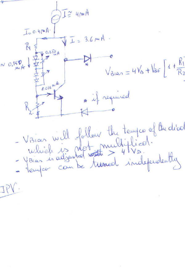

Your plan B is of course one good answer but as you said it requires a bit of design (which should not afraid diy'ers when I see all the troubles they go through with sophisticated front ends and error corrections !)
But as mentionned, the topology used by Leach should work like explained in the attachement.
What do you think?
Jean-Pierre

megajocke said:What is the dV/dI (maybe called dynamic resistance or something) of the diodes at that current?
If it is big then diverting current with resistors will decrease the temperature coefficient instead of increasing it!
I didn't do the calculations though so I'm not saying it won't work, but have it in mind.
No
operating the diode at another current will change the Vd of course and more if the dV/dI is high at the operating point. But at a fixed operating current in the diode this will be a fixed Vd for which the Vbe multiplier will be adjusted.
Now, if the temperature changes, the Vd will drift for the tempco at that current and so the Vbias.
Of course the Vd changing with temperature, the current in the diode changes so the tempco but this is a negligible effect because the proportionnal change in current in the diode due to Vd drift is equal to that drift. This is about 30% for the full range of temperature. This is a low change in tempco because the tempco changes logaritmically with the current.
JPV
What do you think?
Jean-Pierre
I think putting the T-Trak diodes in the Vbe multiplier as shown in your drawing is potentially an elegant way of running them at the lower current.
However your drawing shows shunt resistors across the diodes so the current through them will vary with their temperature. I think there will be fewer unknowns if a fixed 158 uA is put through the diodes. Why does your drawing show four T-Trak diodes? I am assuming an EF stage with two output devices only.
The operating current also needs to increase to at least 10 mA if it is to be part of a VAS,and that will put the base current up.
There also needs to be a way to add on the fixed voltage. (Vfix in Plan B)
What are the "if required" diodes for??
I'll look a bit deeper into this.
Douglas

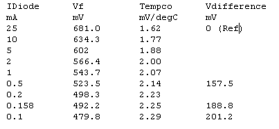

I thought I'd see what PSPICE makes of the MUR120 diode properties as the current varies. Using the standard MUR120 model from the library, this is what came out:
IDiode Vfwd Tempco Vfix
mA mV mV/degC mV
25 681.0 1.62 0 ref
10 634.3 1.77
5 602 1.88
2 566.4 2.00
1 543.7 2.07
0.5 523.5 2.14 157.5
0.2 498.3 2.23
0.158 492.2 2.25 188.8
0.1 479.8 2.29 201.2
The tempco at 25mA is 1.62 mV/degC which is close to Bob's value of 1.7 mV/degC. That's reassuring.
However, we get the desired tempco of 2.14 mV/degC at 500uA, not 158uA, so we need to be a bit flexible in our circuit design.
The added Vfix voltage needed to match the transistor Vbe's comes out as 157.5mV.
So there we are. As a first attempt try Idiode = 500uA and Vfix=157.5mV for circuit design
Douglas

Cheers, John
Not really using this data for absolute value, just to compare if diodes are equivalent size wise.
dynamic test done with the same vendor same way s/b ok just to cross check.

My point is the test may be corrupt.
At the time (back when dino's roamed the earth), the big players all published temp data in their catalogs. It is easy enough to check the 125 C and 25 C curves, and calculate the deltav/deltat for multiple currents. The problem was, the high temp vf data was no good.
The end result was tempcos that were not correctly calculated.
That's why I recommend actual measurement at DC. Designing all kinds of circuitry around a tempco that may not be realistic is just beggin for problems.
Unitrode, Moto, TI, IR...they all had corrupt temp data in their sheets..problem was, the darn test hardware worked perfectly at room temperature...
The assumption that your 150 C data is correct is a suspect assumption.
Cheers, John
Cheers, John
