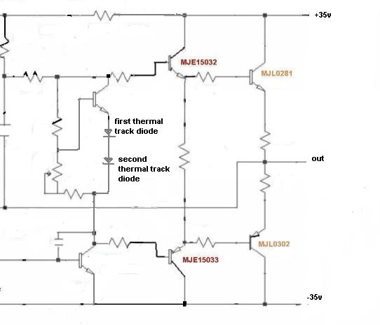

Hello
Maby I draw it a bit too simplified, but it could look like that with an EF output stage.
Gaetan

Hello
Gaetan
Re: Re: Re: Re: ThermalTrak Design Considerations
Hi Gaetan,
Yes, this is exactly right for the Vbe multiplier that is responsible for temperature compensation/tracking.
Depending on details, one may want to incorporate a second Vbe multiplier in series with this one to provide additional bias spread that is not tracking the output transistors. However, in the case here of a Double rather than a Triple, this single Vbe multiplier may do well enough.
There are a great many possibilities.
Bob

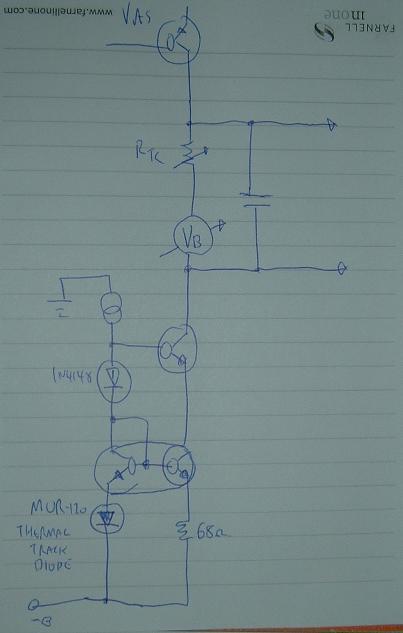

Here is a much simpler thermal-track scheme that I just thought up.
Just a single thermal-track is used, but it biases the VAS constant current source.
We then adjust Rtc to dial in any temperature compensation coefficient required (Rtc/68) and trim the output stage bias current with Vb.
Glen
Glen

Interesting, but I see one potential drawback - bias will drop when clipping as average VAS current decreses in that situation. It seems like current drawn by the next stage will decrease the bias too, more decrease with higher output current.
This assumes the cap you drew is relatively large.
Yeah, you definately wouldn't want to try it with anything less than a triple EF output stage and there is nothing much you can do to (besides a big cap) to prevent the bias dropping when clipping.
Glen
