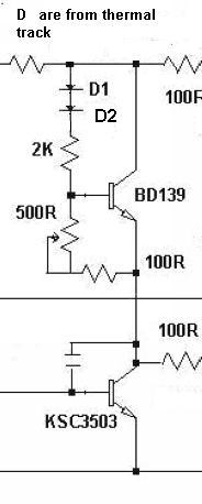

Hi
I know the roender amp using Onsemi thermal track.
I did found few of those transistors, but I still hesitate to use 3 in parallel, like in the roender amp, to get the right number of diodes for the correct bias. And anyway I don't have enough Onsemi thermal track transistors to do like in the roender amp.
Anyone try it using only one transistor per side with a VBE and only one thermal track diodes per side ?
My diy amp work super and it have a Self type II output and I would like to try the thermal track transistors on my amp.
Thank
Bye
Gaetan

do we need stable bias current with temp in the output stage? NO
This seams provocative but here is why (IMHO):
Self is writing in his book that an optimal Vq ( voltage drop on Re the ouput emitter resistor) would be 26mV for minimum distortion ( in Complementary EF stage).
This is empirically found but there is more to that if you understand why.
In a previous thread I wrote a memo explaining better the original paper ( difficult to read because typo errors) of Oliver ( from HP) on this subject.
He studied analytically the non linear output resistance of a class B amplifier. It is the non linear variation of this ouput resistance with output signal which is the cause of crossover distortion.
He showed that the distortion is minimum if: gmRe =1
where gm is the transconductance of the transistor at bias Io.
What does it mean?
gmRe=1 is equivalent to (Io/Vt)Re=1 where Vt is the thermal voltage kT/q
This is the same as Io Re=Vt or the voltage drop on Re = 26mV !
But this means that if the temperature increases, so does Vt and the current should follow proportionally if we want to stay in the minimal distortion condition !!!
So, the Vbias tracking circuit should have a different Tempco than the Vbe of the outpu transistor.
Lets evaluate this Tempco for Temp from T1=300°K to T2= 375°K. for Thermaltrak transistor
first the condition IoRe=Vt means that Io2/Io1 = T2/T1
Io1 = bias at T1 and Io2 is bias at T2. This is very important In our case Io2 = 1.25 Io1 and Vt ( at T2) = 26mv * 1,25 = 32.5
If the circuit is symetrical we may calculate the Tempco of Vbias for one half. The final Vbias Tempco is twice the result.
Vbias (at T1)= Vbe ( at T1) + Io1 Re
Vbias (at T2)= ( Vbe ( at T2) + Io2 Re + Delta Vbe )
(Delta Vbe) is the increase of Vbe at constant temperature T2 to take into account that Vbe operates at a higher current Io2.
Using the diode equation Io2/Io1 = exp ( Delta Vbe/Vt)
so (Delta Vbe) = Vt ln ( Io2/Io1 )
in our case Delta Vbe = 32.5 * ln ( 1.25)= 7.25 mV
Then
Vbias ( T1) = 0.6v + 26 mV = 0.626
Vbias ( T2) = 0.6V - (2mV * 75) +32.5 mV + 7.25 mV
= 0.450 V + 39.75 mV
And Tempco Vbias =( Vbias (T2) - Vbias(T1) )/ (T2-T1)
If we replace the values Tempco = -2mV/°C + (39.75 - 26)/75
Temco = 2mV/°c - 0.183 mV/°C = - 1.817 mV/°C
NOW the good point
If we look at the specs of the diode in the thermaltrak data sheet
At low current 1ma in the diode, Tempco is about 1.81mV/°C
So by using a Vbe multiplier like the Leach one and force 1mA in the diode leg, we can adjust for the right operating point at room temperature and have the two diodes tracking optimally !!!
So Thermaltraks OK ??
JPV

Re: do we need stable bias current with temp in the output stage? NO
Hello
Like that ?
Thank
Gaetan

Hello
I do not use a pre-driver, here is the kind of output I use in my diy amp.
My previous diy amp was a cfp output but there was oscillations, so I did come back to a standard type II output.
Thank
Gaetan
Re: Re: do we need stable bias current with temp in the output stage? NO
Yes but with two diodes in serie one for the NPN and one for the PNP.
The resistors must of course be calculated for the 1mA current and this depends on the current source feeding the Vbe multiplier.
If you have predriver(s) you must include diodes to take the Vbe of thedrivers into account. Here de diodes of the correspondent thermatraks ( if the driver is thermaltrak) will not track aswell and induce an overall error but these transistors should run cooler

Re: Re: Re: do we need stable bias current with temp in the output stage? NO
Hello
Yes, I know, I've forgot to draw the second diodes, I did replace my image by a corrected version.
I do not use a pre-driver, you can see the type of output I use in my second images in my other post.
Thank
Gaetan

Re: Re: Re: Re: do we need stable bias current with temp in the output stage? NO
my comment were about the drivers and you have them. They will drift too and there we need an exact compensation.
One possibility is to use themaltraks as drivers too and use their diodes in serie with the two others in the Vbe multiplir. Because you need more voltage drop, you will need a diode ( 1Nxxx) in the base of each driver to compensate and be able to bias the Vbe multiplier transistor in the active region
The 2 extra diodes in the Vbe multiplier must track the driver
drift. One possibility is to // each diode with a resistor and have this diode working at let say 0.1 mA. The drift should then be 0.2mV/°C higher. This with a well cooled driver should make it.
You can try even 0.01ma which should give you another
-0.200mV/°C extra drift. Of course the room temperature Vbe is lower but with a well calculated potentiometer and resistors it should be possible to adjust the pot. This is without having experienced it. It is perhaps totally wrong for a reason I didn't see. Measurements and experimenting is required.
JPV
