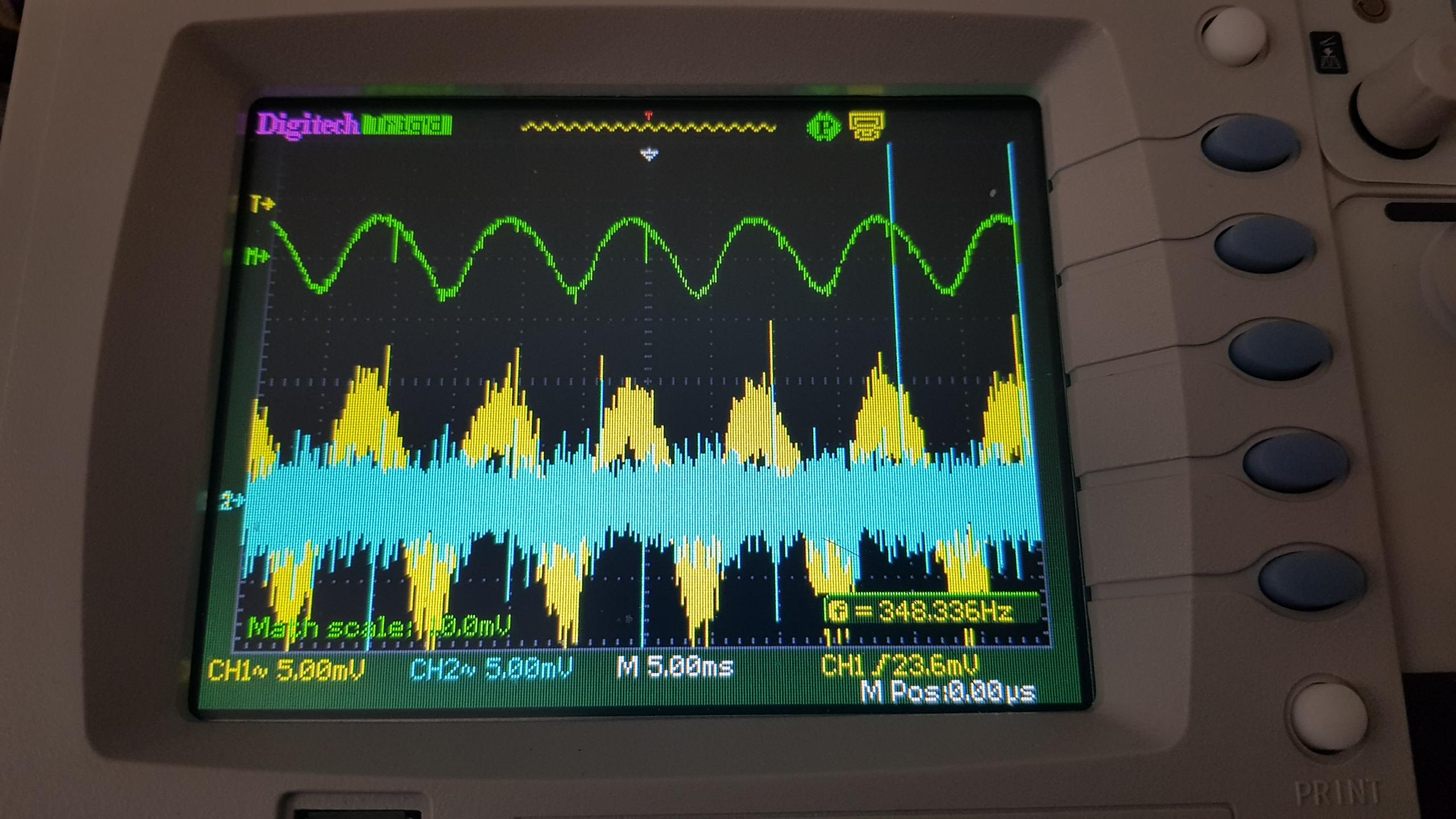

Unloaded Supply Voltage: 27.6
Loaded Supply Voltage: 26.1
Loaded Supply Ripple: Approximately 15mV pp
Power supply rpple is about the same but the shape is a little different.

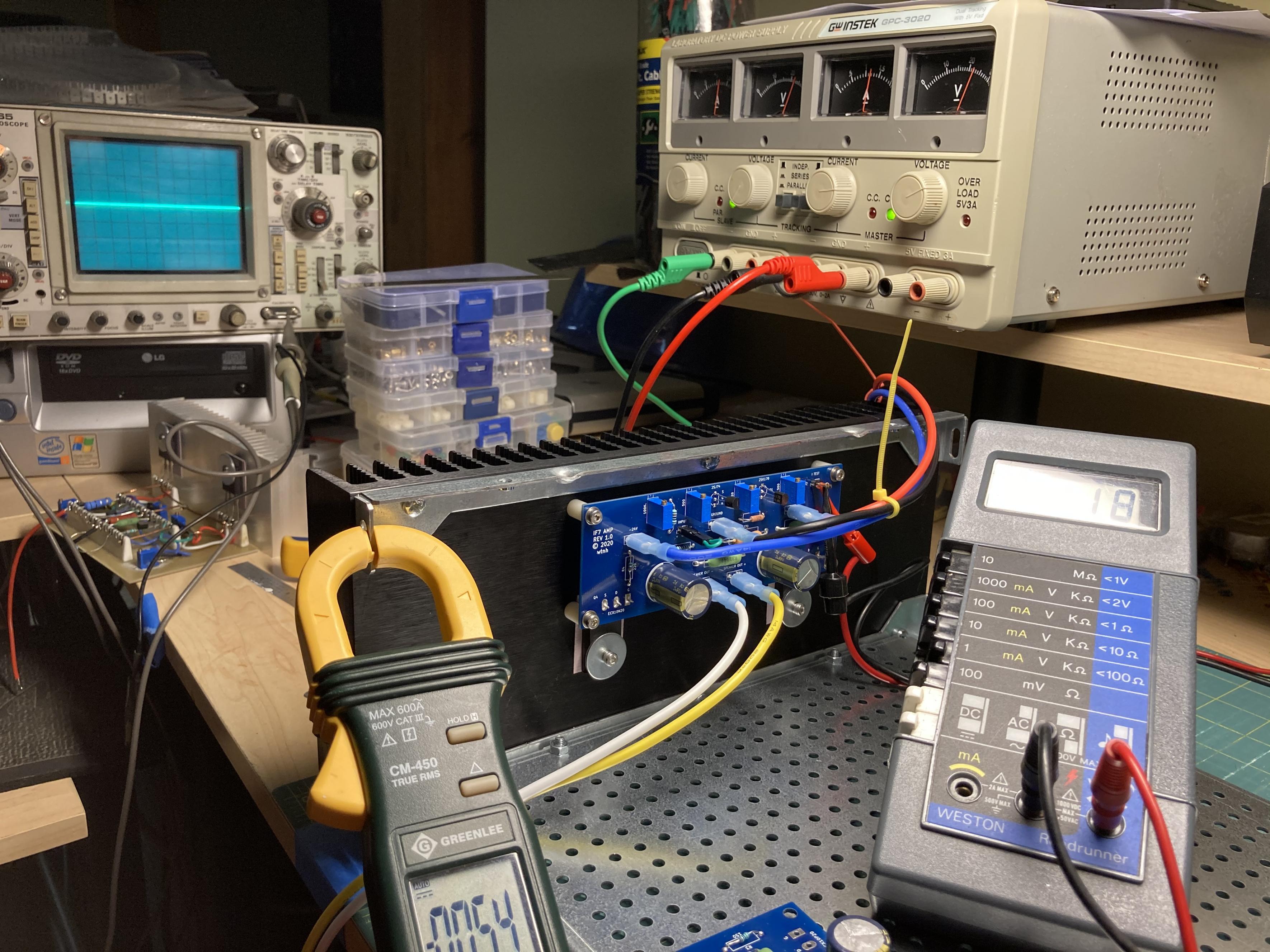

Finally some progress...
Heat soaking one channel with bench power supply - idling at about 1.25 Amps (~60 Watts total) - heatsink is warm but not too hot. MOSFET bodies around 140 F. Offset is very stable. Input shorted, no load.
Next steps - hook up dummy load, do some signal measurements and play with input FET source pot, positive feedback, etc.
