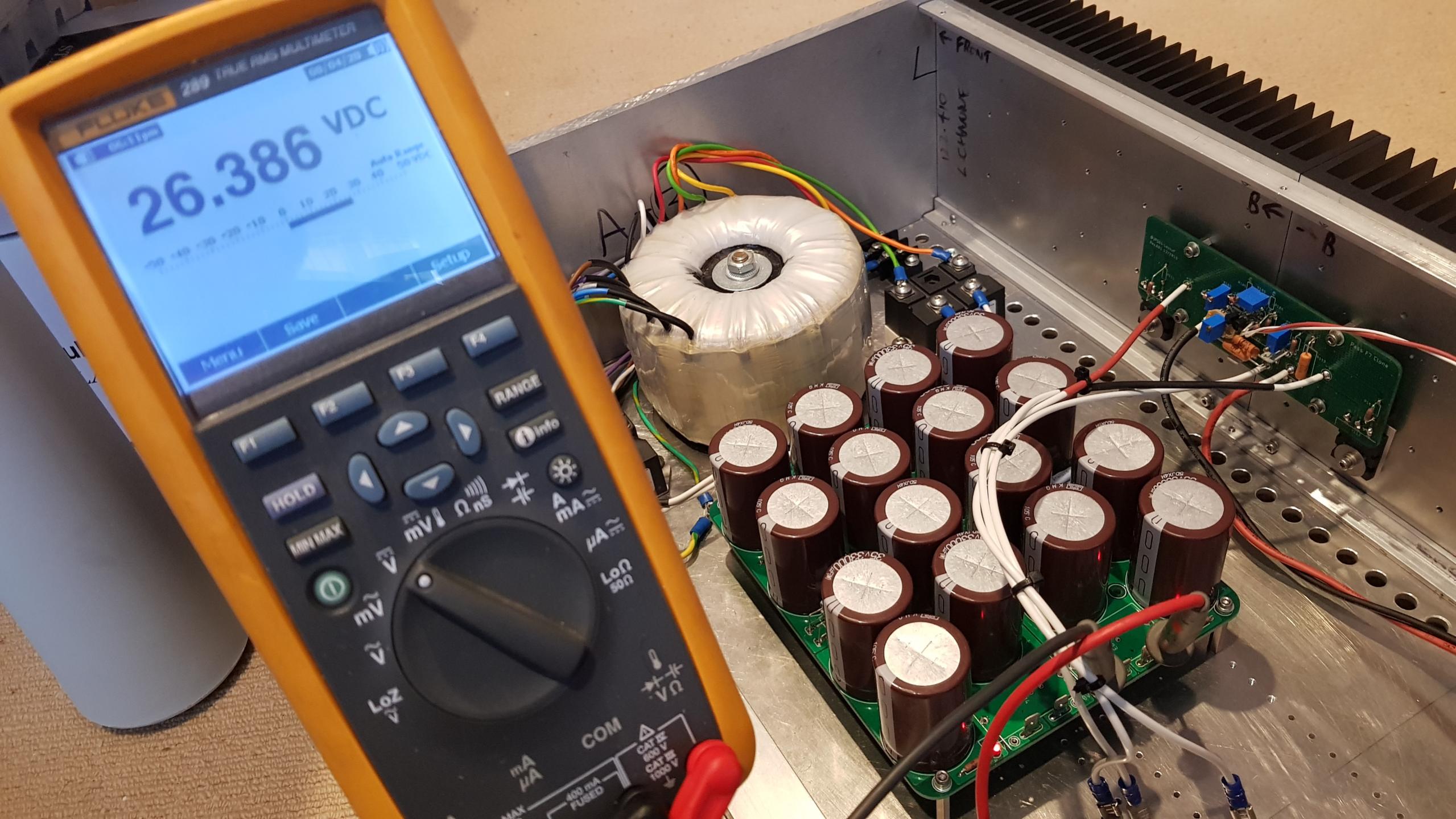

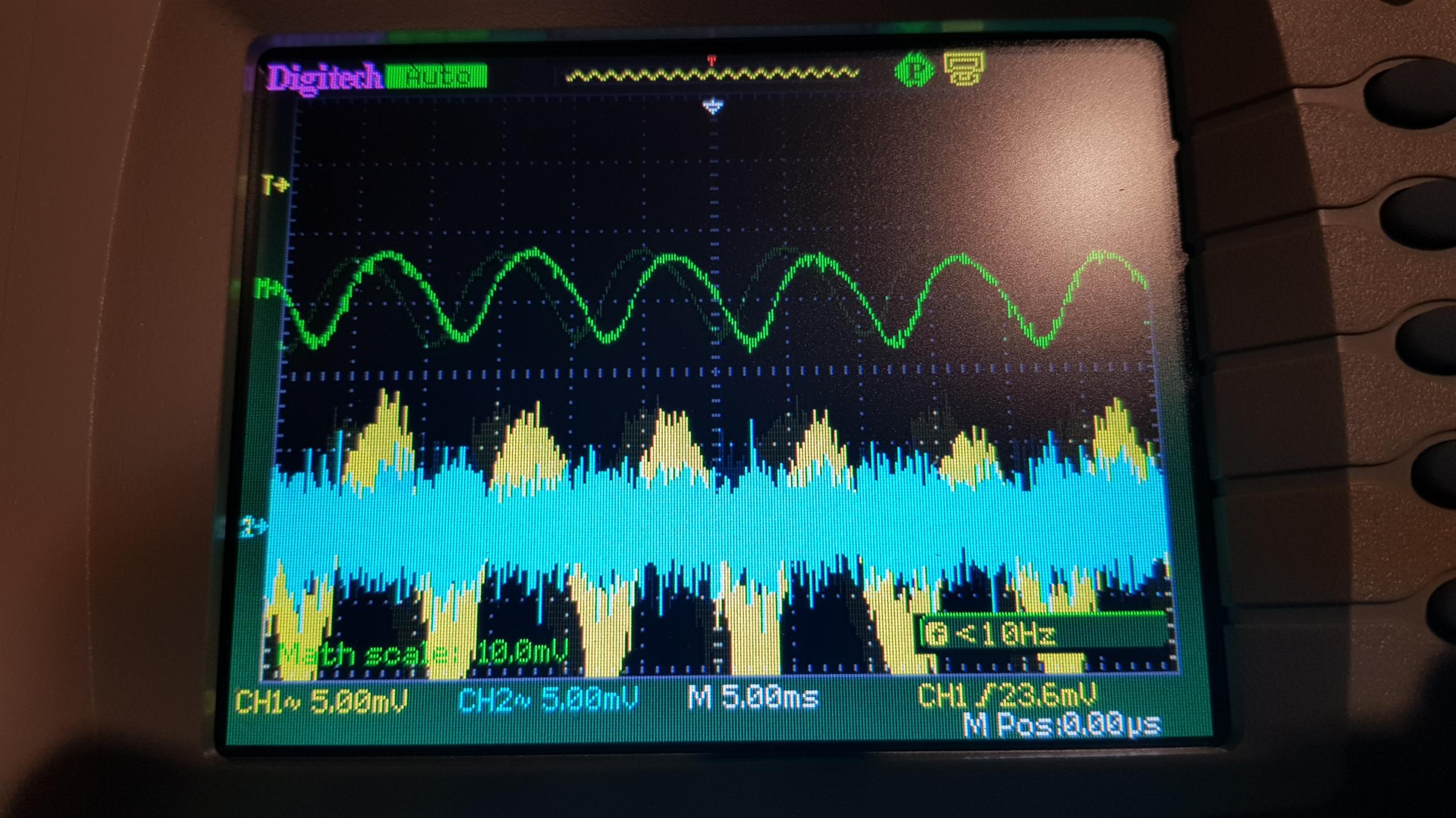

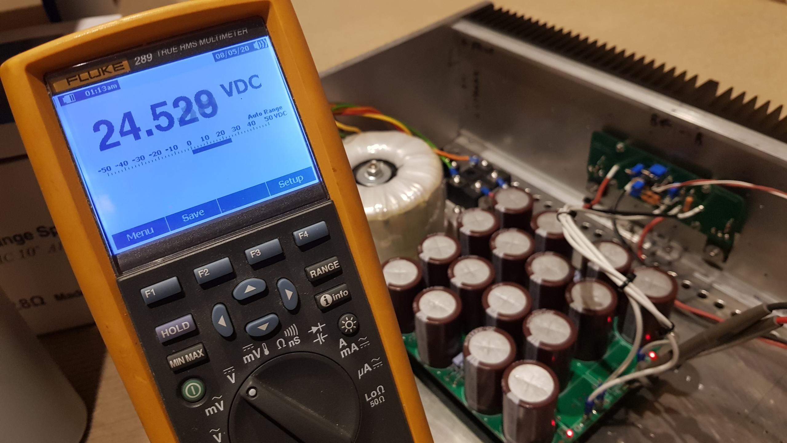

Passive Bridge Rectifier
Unloaded Supply Voltage: 26.4 V
Loaded Supply Voltage: 24.5 V
Loaded Supply Ripple: Approximately 15mV pp
I will try and do the active bridge now. If not now, then tomorrow.
Later I will look at power supply hamonics etc.

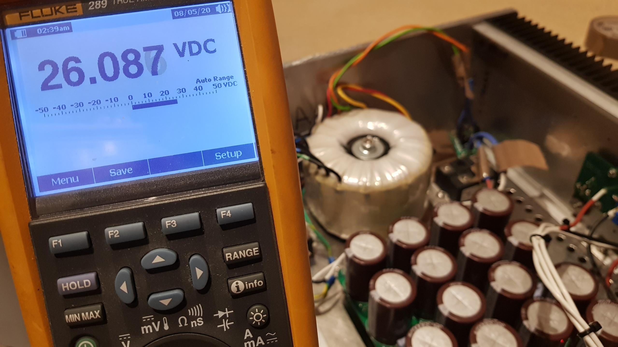

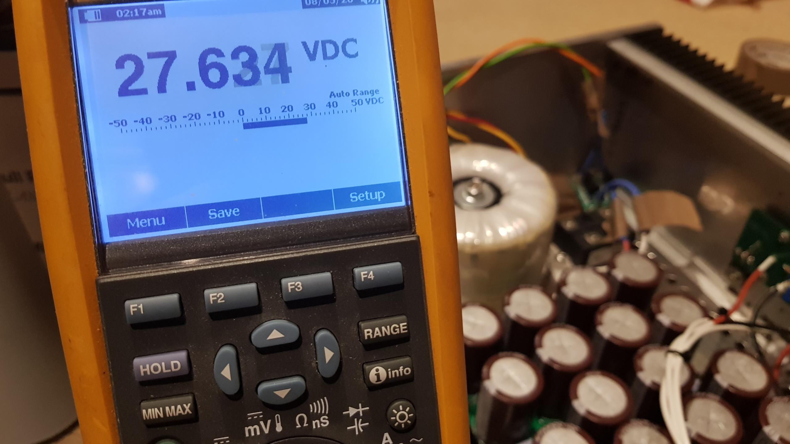

LT4320 Active Bridge Rectifier
Unloaded Supply Voltage: 27.6
Loaded Supply Voltage: 26.1
Power supply rpple is about the same but the shape is a little different.

In both cases there is about 0.2 V lost across the resistors in the crc supply, when the supply is loaded by the amp.
So Loaded Passive vs Loaded Active is:
24.6V vs 26.1V
Just so you know my transformer has 19V secondaries.
24.6V vs 26.1V
The increased loaded voltage by itself may be enough to justify the active bridge rectifiers. Sometimes being able to supply a higher Vds to the output Mosfets can translate into improved sonics. So, as Zen Mod asks, is there also a difference that you can hear?
