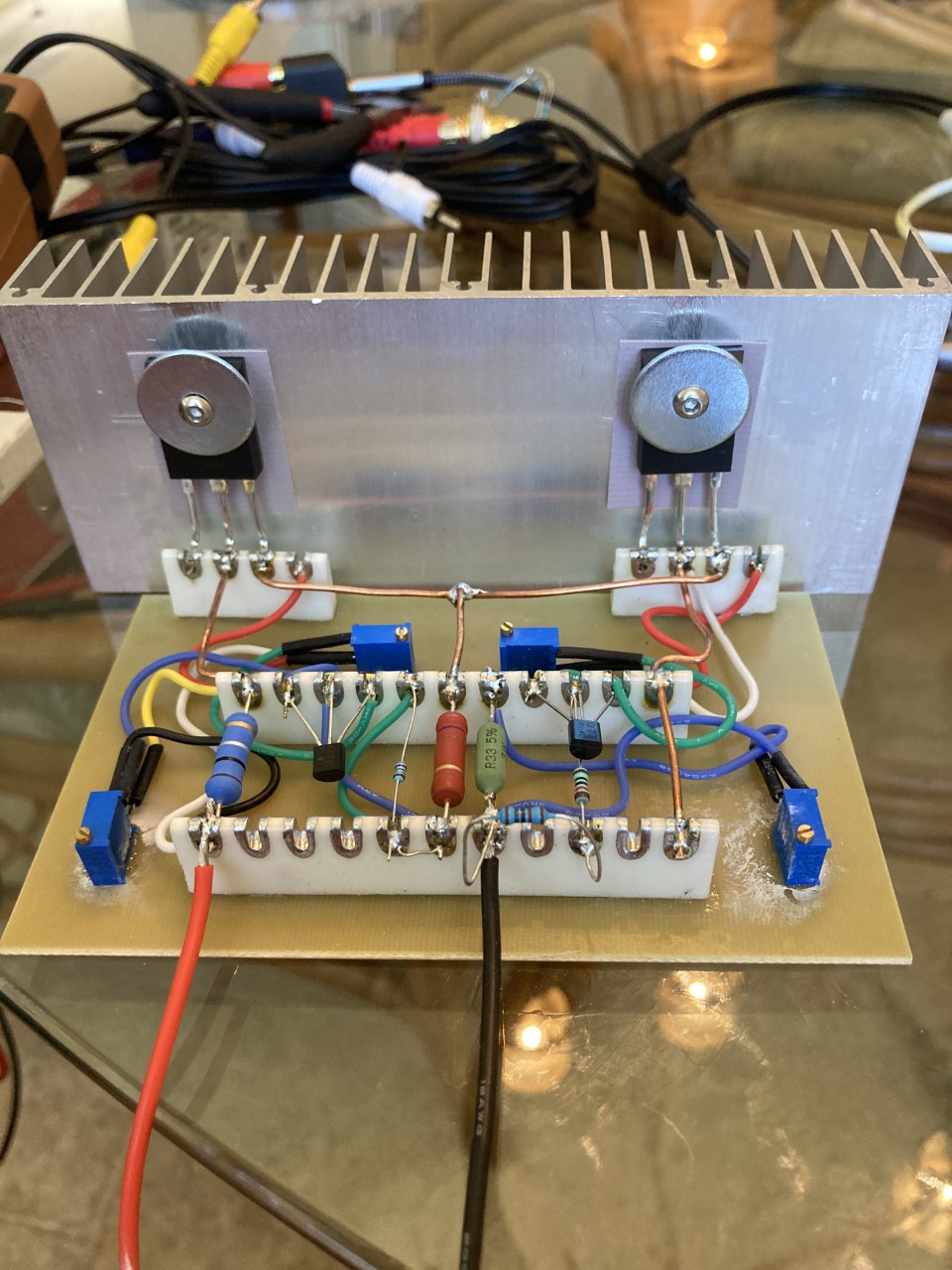

Imitation F7 breadboard
I posted this over in the F7 review thread. I am calling this an imitation (not a clone - "IF7"?) since I have no real first-hand knowledge of the schematic, but it seems to work nicely so far. Bias and offset adjustments easy to do with 15-turn pots. Did a quick listening test with trash speakers and it sounds good. I will probably do a PCB and get a real amp chassis soon, then do some real measurements and listening tests.
Old-timers will appreciate the Tektronix-style ceramic/silver terminal strips.

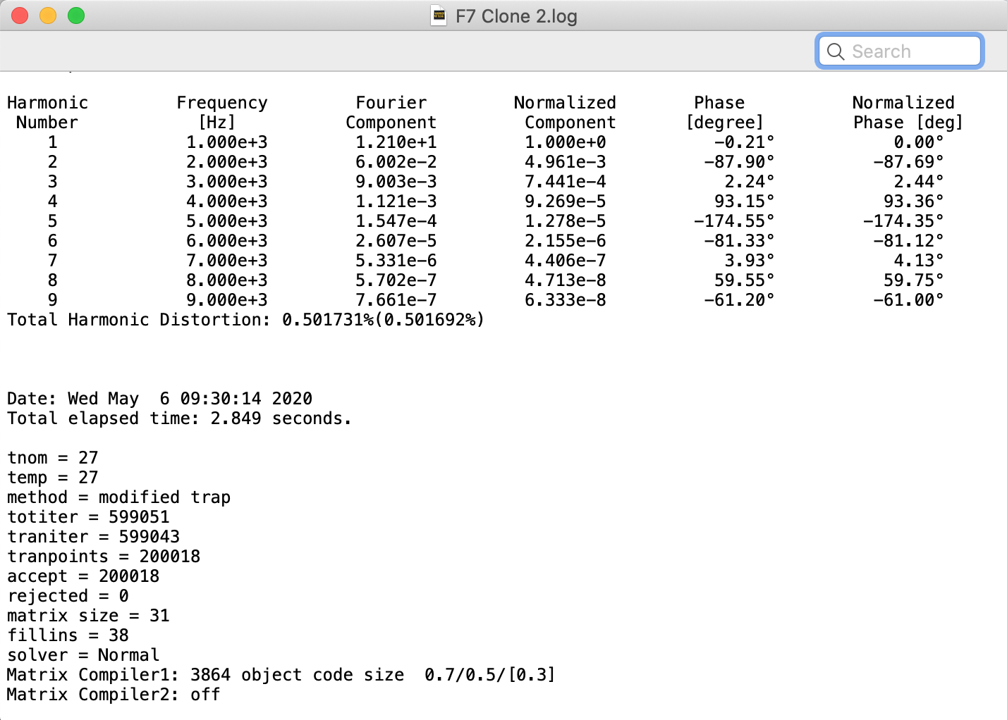

I should add that I am using the LTspice built-in models for LSK170B/LSJ74B for the fets and the Ian Hegglun/keantoken lateral models found here for 10P20/10N20 Exicon parts. And here is the LTspice log for the previously mentioned FFT.

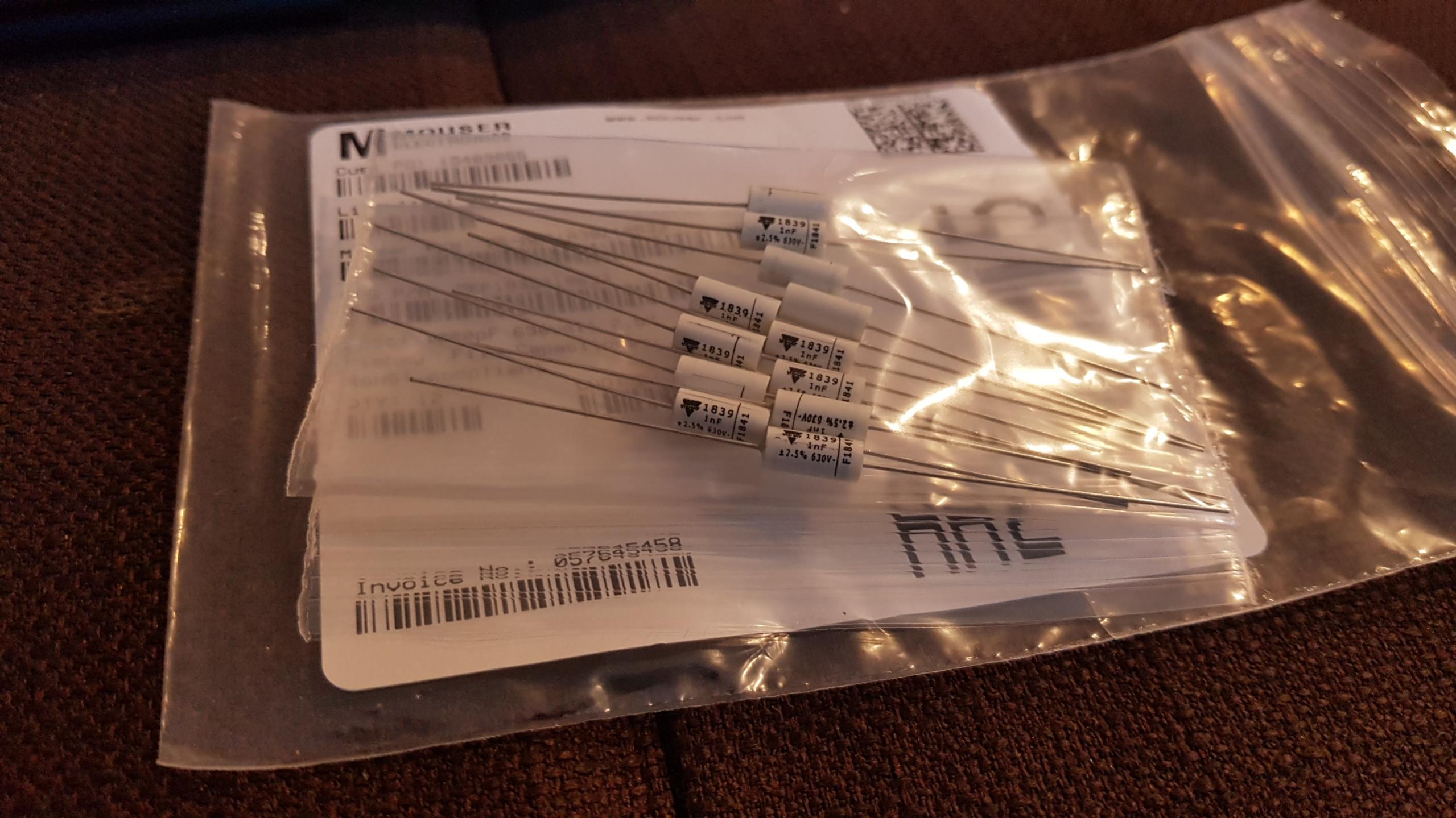

If you have a very small amount of overshoot with your F4, then placing 1000pF across R24, and R25 completely cleans it up to perfection.
Don't do more than 1000pF though. You could possibly try 500pF (I haven't tried it ).
I tried 200pF but it wasn't enough, and 22nF didn't work anywhere near as well.
The radial caps I used are a real bastard to install so I purchased these 1000pF axial polypropylene film capacitors.

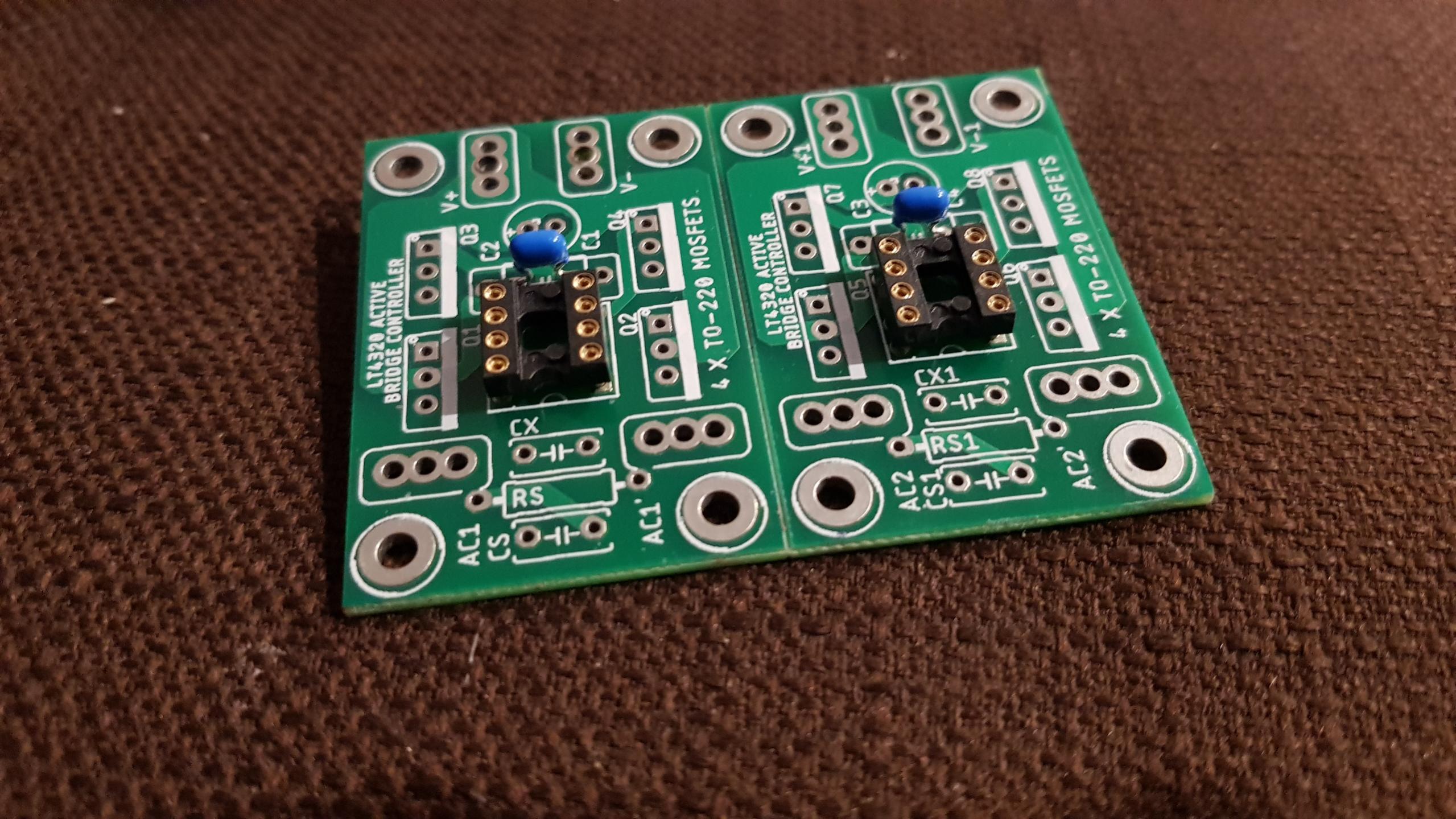

Active rectification is on my list of things to try too, pico. Let us know how they perform....
