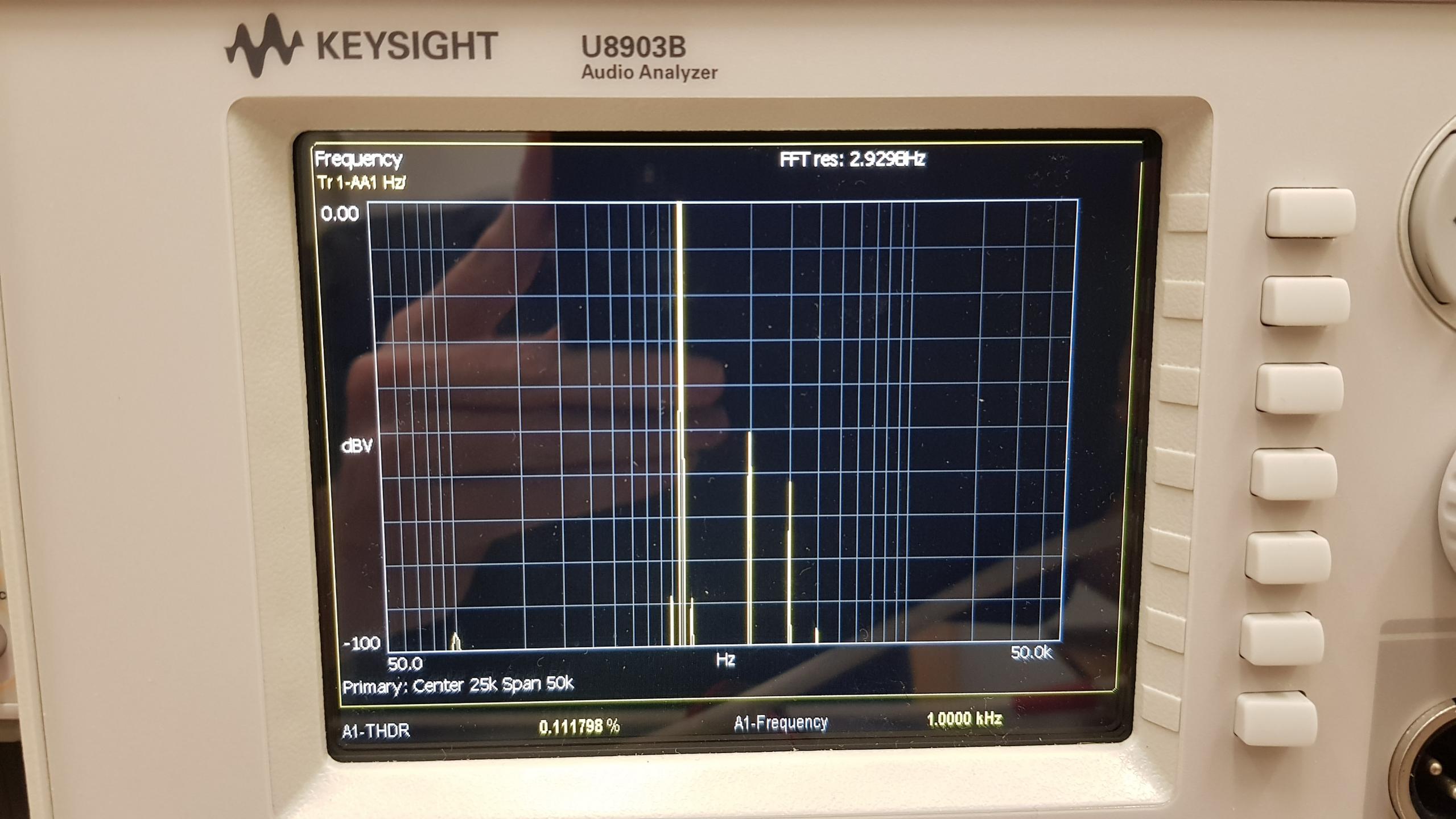

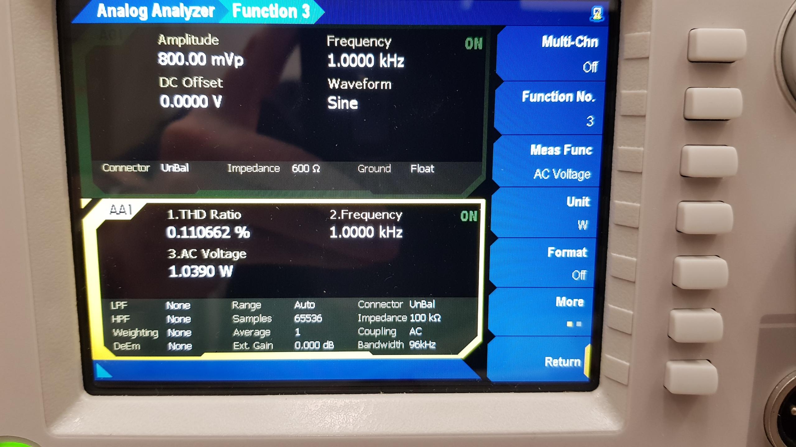

Distortion, and Power Supply Measurements
Retesting amp with powersupply instead of sissy lab powersupply and the distortion level has dropped from 0.17% to 0.11%.
Maybe the lab supply was causing compression due to current limiting circuit or maybe the lower rail voltages 22V of the lab supply is the reason.
Well the result is pleasing.
Redo FFT next and compare noise on output vs Firstwatt F5.

Noise at output referenced to 2.82V rms (1W) output is around -96dB at 100Hz (rectified 50Hz AC)
Awesome result. I am bloody happy with that.
I can change the y axis and show power supply harmonics below 100dB if people are interested.
I will test Firstwatt F5 for comparison next.

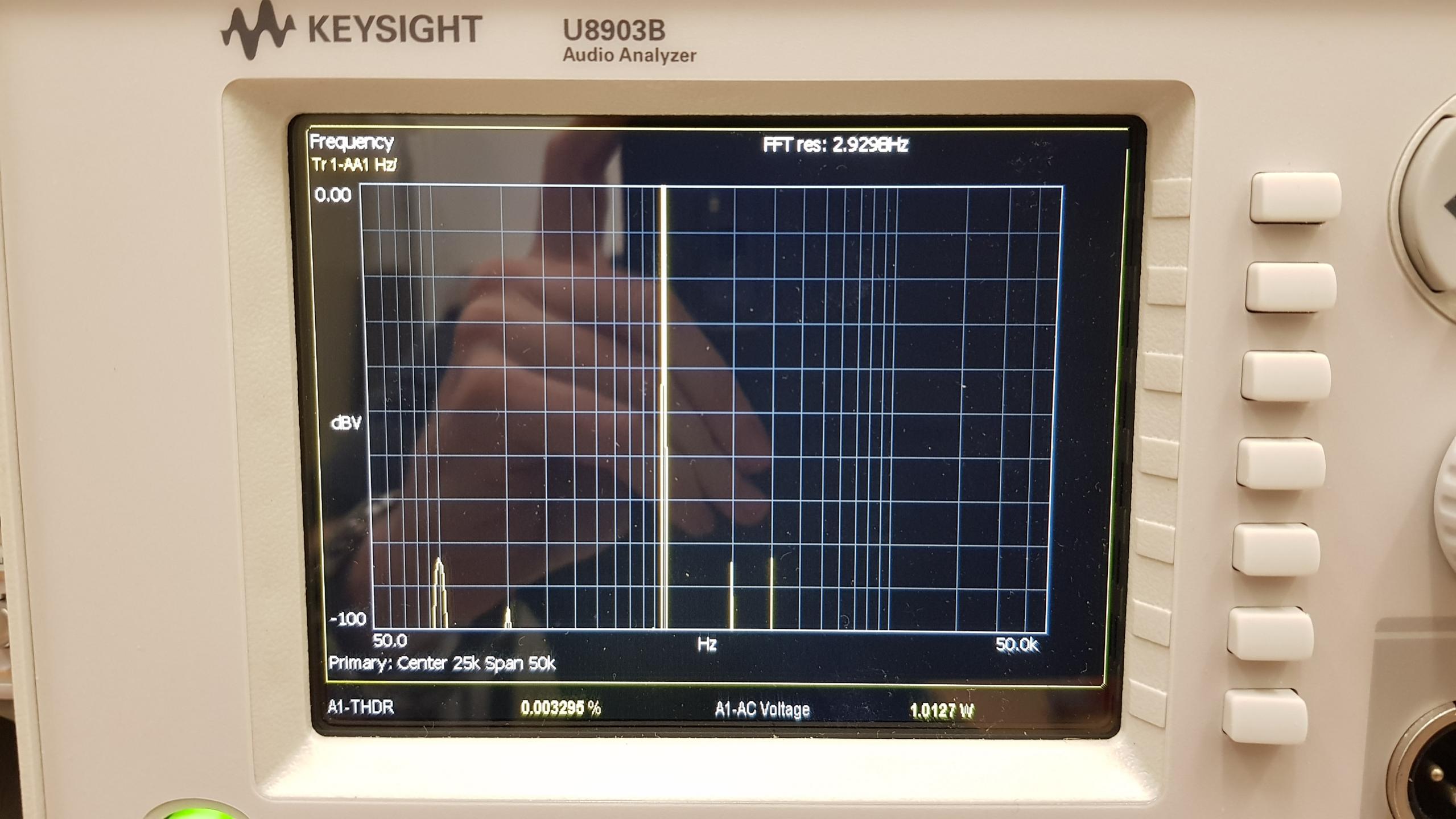

Firstwatt F5
Powersupply noise at output is around -85dB dB down referenced to 2.82V rms (1W)
