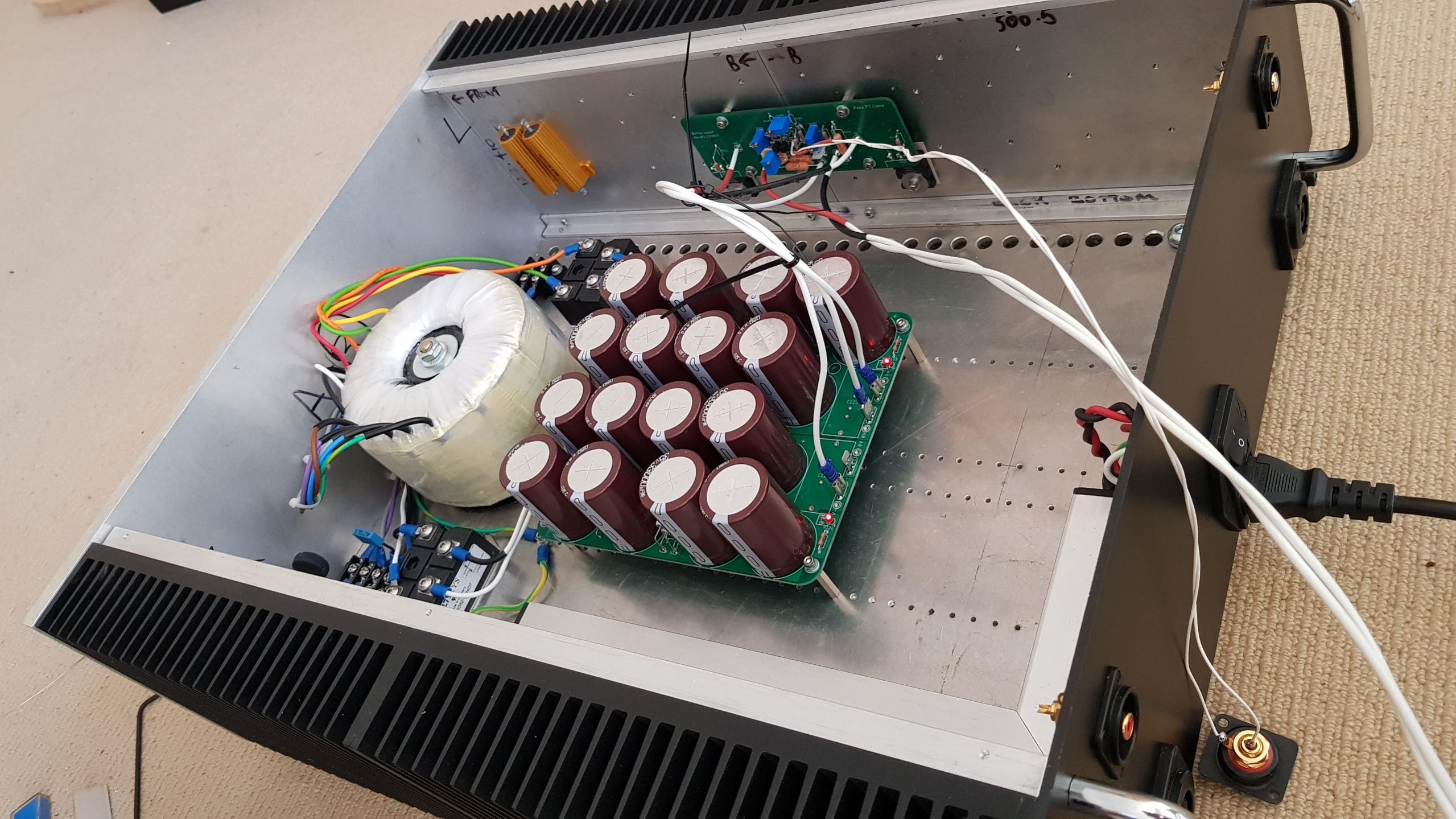

Planning to hookup the amp tomorrow, remeasure loaded supply voltages, maybe listen to some music.
Look at power supply noise on output of amp on FFT on Monday.

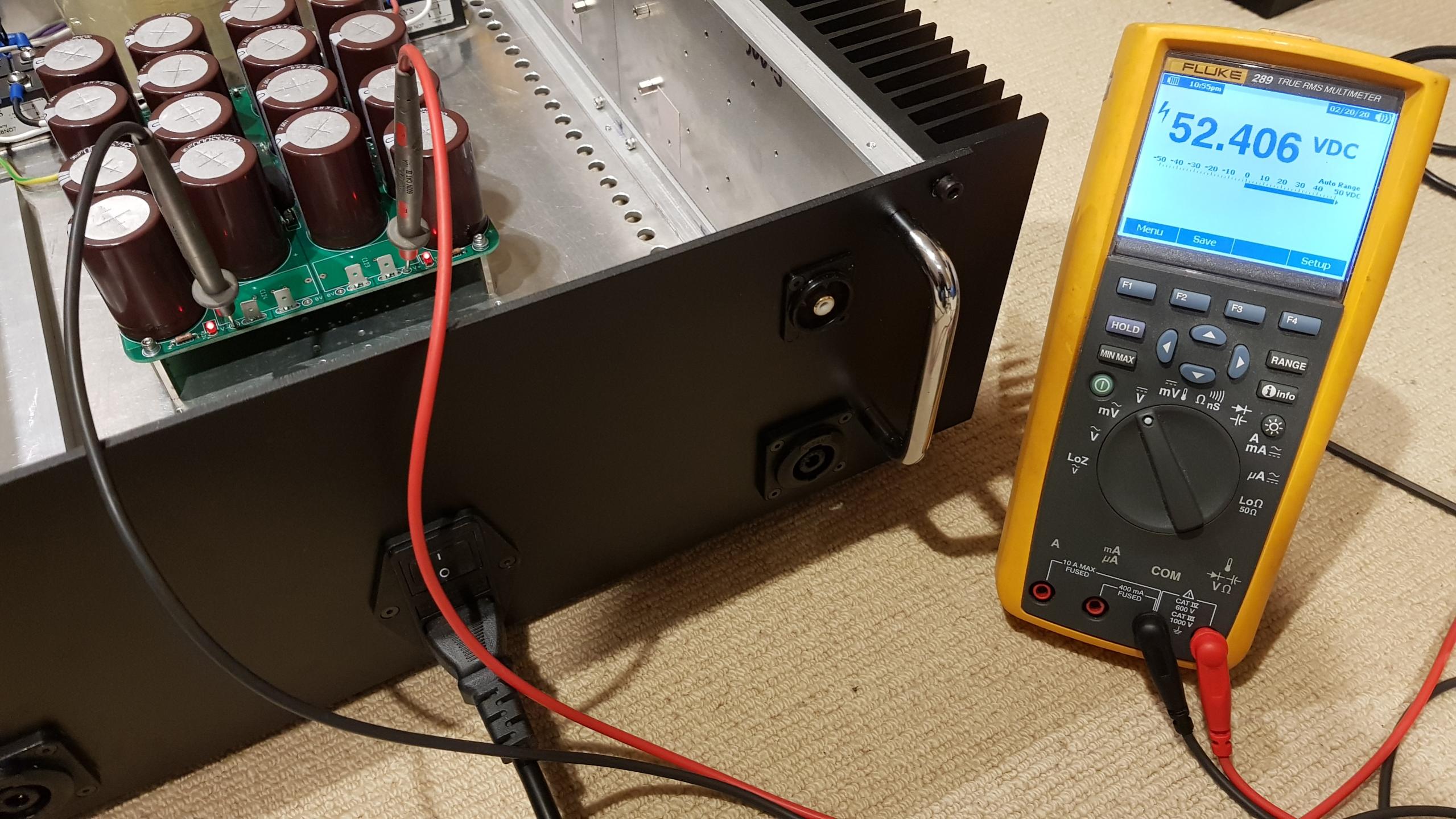

Loaded supply Voltages
48.4 Vpp
Positive Rail 24.2V
Negative Rail: 24.2V
The transformer is dead as a door nail silent. Very happy with it.
48.4 Vpp
Positive Rail 24.2V

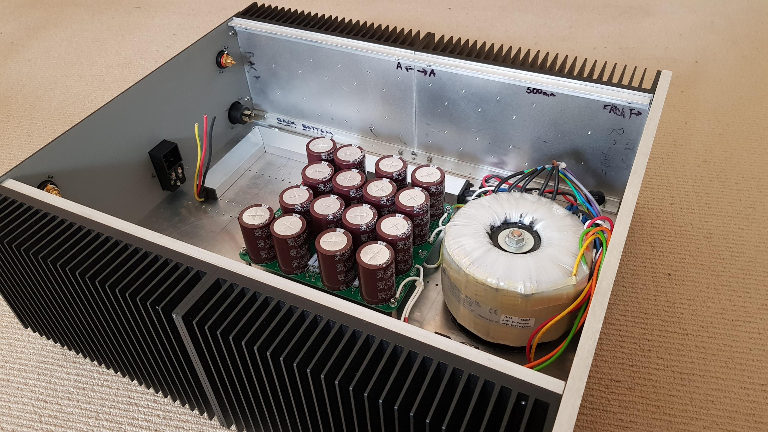

A few more measurements.
AC Mains across primaries: 240.2 V rms
AC drop across ICL thermistor 2.7 V rms
Temperature Measurents
Ambient: 25.1 C
Mosfets: 53.1 C (28 C above ambient)
Max Heatsink Temp: 49.6 C ( 24.5 C above ambient)
Heatsink Temp (centre at top): 42.9 C (17.8 C above ambient)
Transformer: 28.5 C (3.4 C above ambient)
Bridge Rectifiers: 34.2 C (9.1 C above ambient)
Capacitors: 28.1 C (3 C above ambient)
Chassis Base Plate: 34.2 C (9.1 C above ambient)
Measured with lid off.
Ambient: 25.1 C
