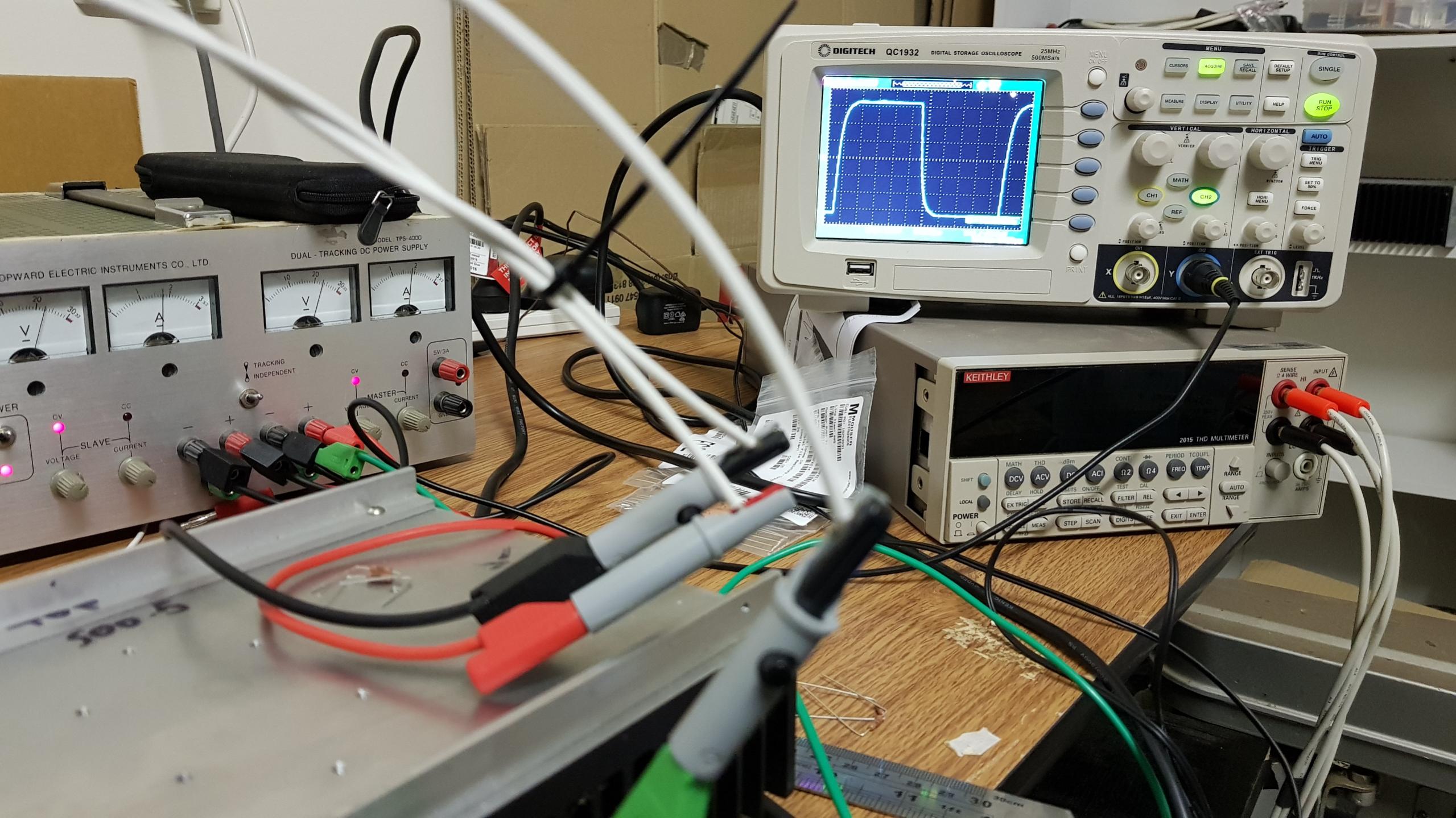

Just measured my speaker cables using 4 wire Keithley Bench Meter.
Resistance is between 5mOhms and 10mOhms.
Adjusted Amp output impedance to get Negative 5 mOhms for near infinite damping.
Hahaha
I will do distortion measurements on Monday and tweak it the way I want.
I have a very small amount of overshoot on square wave but no ringing, I will fix this tonight most likely.
Simulated results are a little off from reality with regards to circuit gain, this is most likely because Id of Jfets is actually higher than the jfets used in simulation resulting in less voltage gain from the first stage.

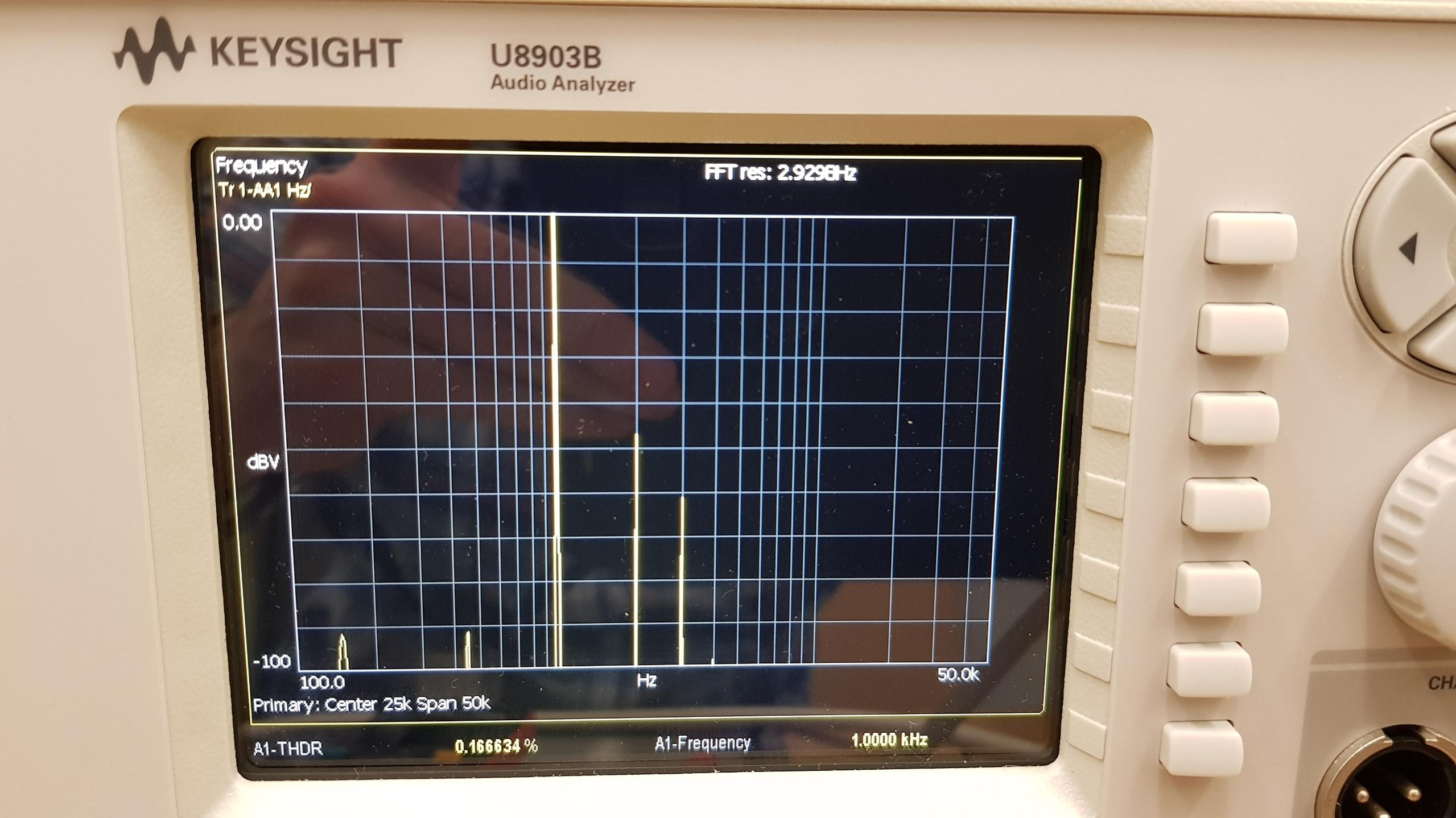

Very first measurement at the original setting of 5/15 Ohms.
Distortion is 0.17%, around SIT3 levels.
2nd harmonic is -46dB and Third harmonic is -61dB, and virtually nothing else.
Hope to get it to around 0.07 to 0.1%, but maybe I will actually prefer it higher.
I will try some other jfet source resistance settings.
I have throne away 6dB in negative feedback to get the damping factor where I want it so that probably explains the higher values of distortion.
