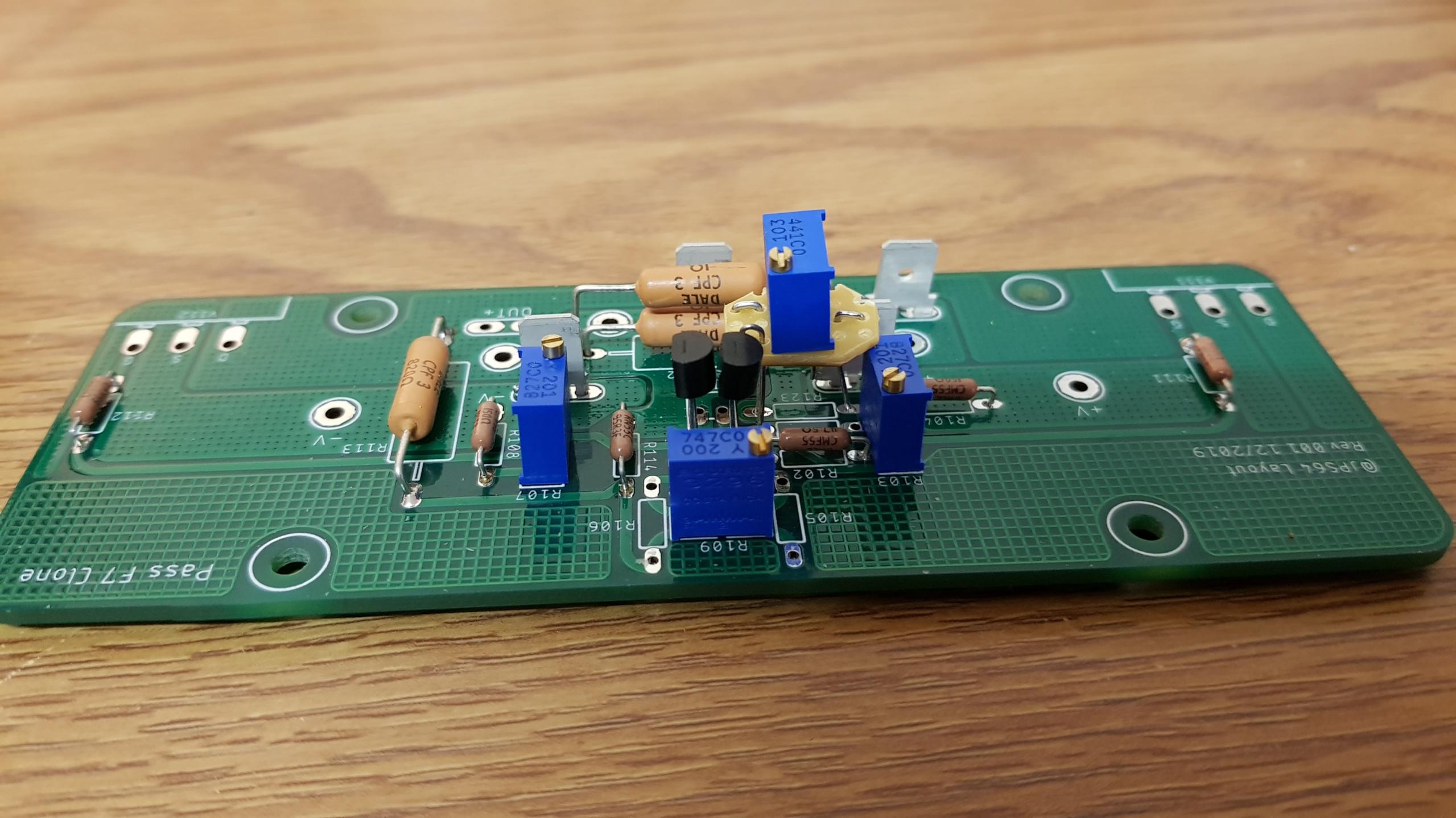

Probably going to set the source trimpot at 16 Ohms, 4 Ohms, for 2sk170/2sj74 respectively, as a starting point.
Using Jfets with Idss of around 7mA for 2sj74 and 10mA for 2sk170.
Once I have confirmed source trimpot values, I may replace with fixed resistors. I have catered for the use of either a trimpot or through hole resistors in that position.

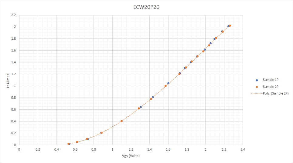

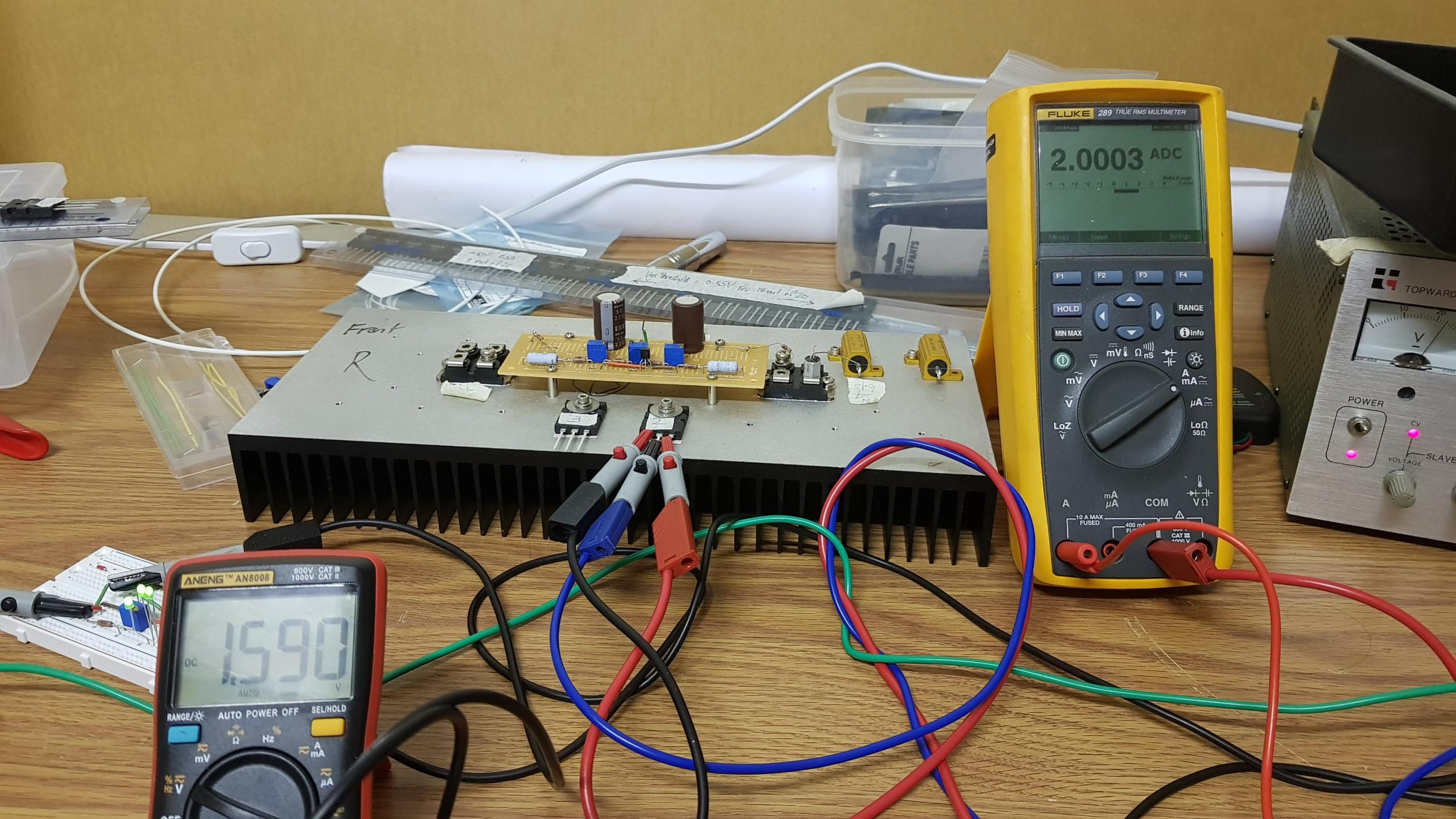

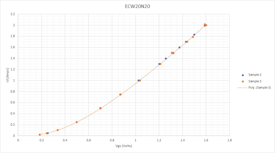

Mosfets measured for amp.
Maybe I should comment about some of this.
1) You will see the lateral mosfets are excellent matching parts. I didn't test 10 parts to get this level of matching, all of them in the tube match this well. These are just the first two of each that I measured.
2) Looking at the curves - In order to hit 2A on each part, I need 1.6V and 2.25V at the gates of the N channel and P Channel parts respectively.
3) Based on my previous jfet testing of Id vs Degeneration, with a 16/4 Ohms setting on the trimpot, we have an Id current of roughly 6mA for each jfet (probably closer to 6.5mA on 2sk170). In order to reach a max bias of 2A, using the previous Vgs values (see [2] above) we need R = 2.25/0.006 = 375 Ohms at the drain of 2sk170 to bias up the P Channel Mosfet (we need less for the N Channel mosfet).
I will therefore use a 200 Ohm trimpot in series with a 200 Ohm resistor. Depending how I feel, I may use a 150 Ohm resistor instead.

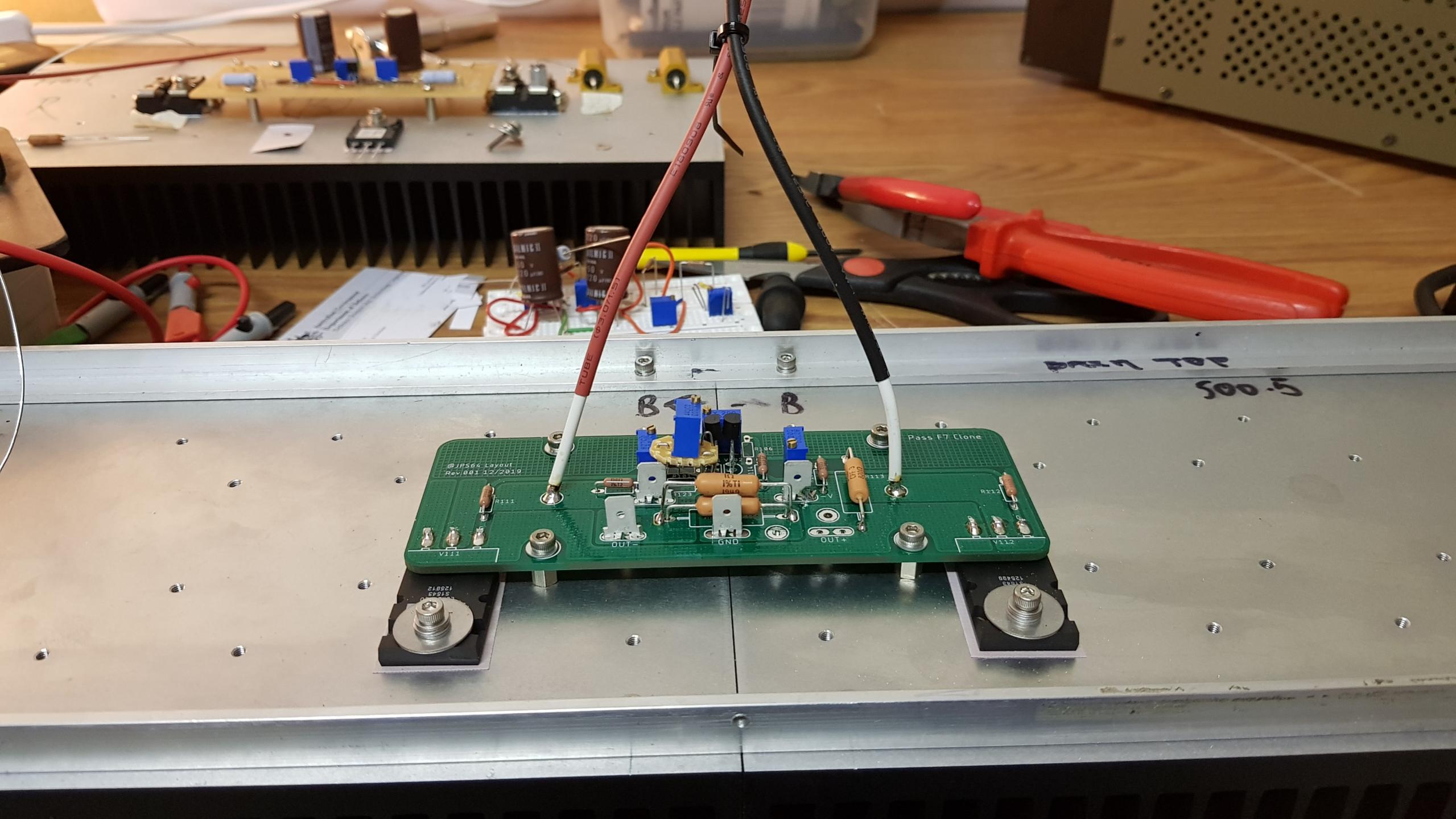

Trimpot operation
Bias Control
Anticlockwise increases bias current
Jfet source resistance
Clockwise: reduces source resistance at 2sj74.
Bias Control
