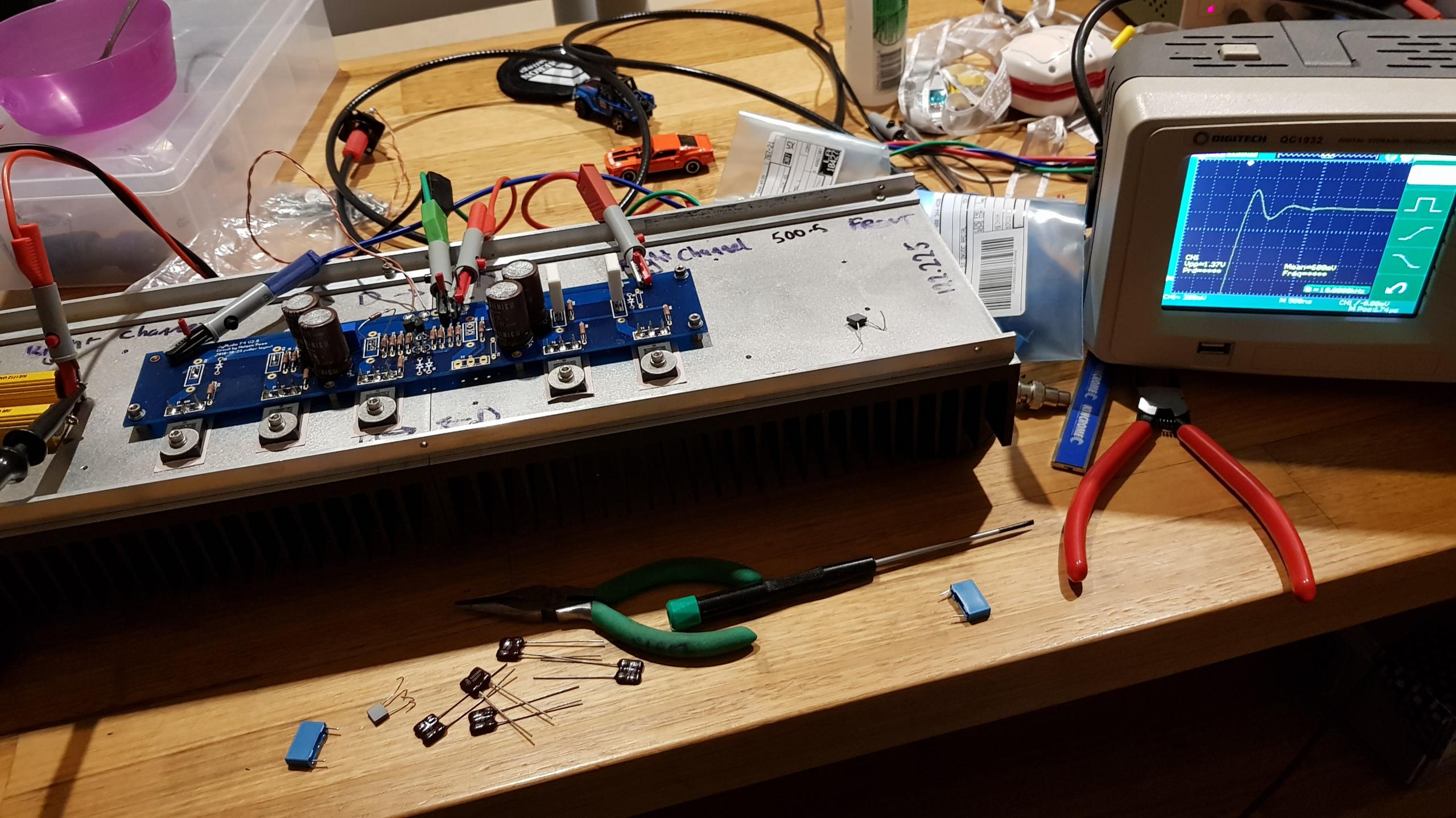

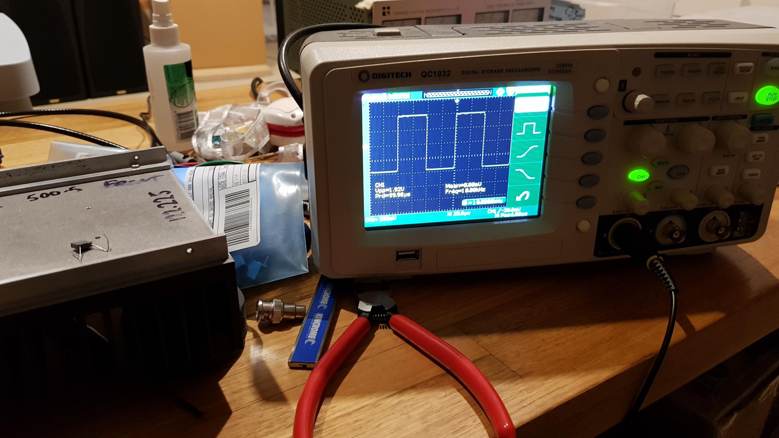

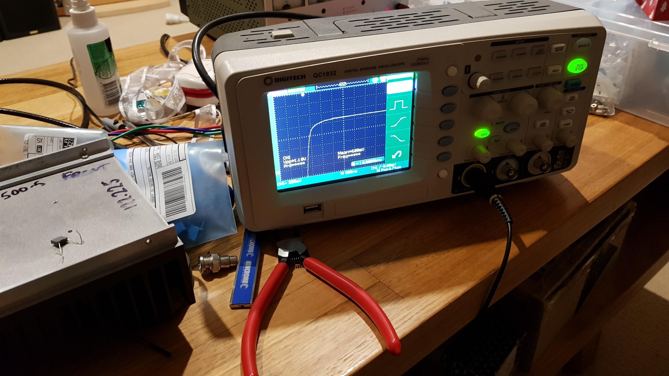

Testing an F4 beast variation. 10kHz square wave.

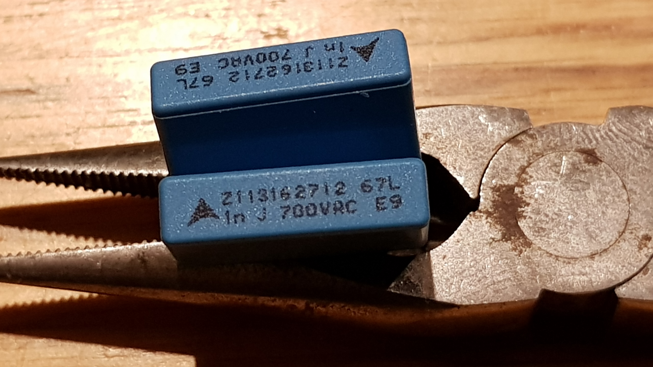

If you have a very small amount of overshoot with your F4, then placing 1000pF across R24, and R25 completely cleans it up to perfection.
Don't do more than 1000pF though. You could possibly try 500pF (I haven't tried it ).
I tried 200pF but it wasn't enough, and 22nF didn't work anywhere near as well.

What's the function of R24 and R25? Are they a bootstrap to overcome the rail voltage loss of R22 and R5?

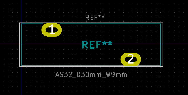

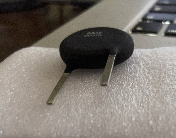

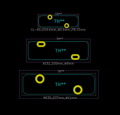

Got my AS32-20010s from Mouser. The leads are indeed oval (well, flat really). They measure 0.8mm x 2.4mm.
I made a Kicad footprint for them, if anyone's interested.
got my MS35-20010 from Bruder Generg
didn't made Eagle footprint , yet
disclaimer - accent is on Bruder Generg , ook MS35
Hey ZM, I also did a Kicad footprint for the AS35, but not having one in hand I wasn't able to verify the leads.
Are they round and 2.5mm in diameter?
Thanks,
Jeff.
Thanks,
Jeff.
