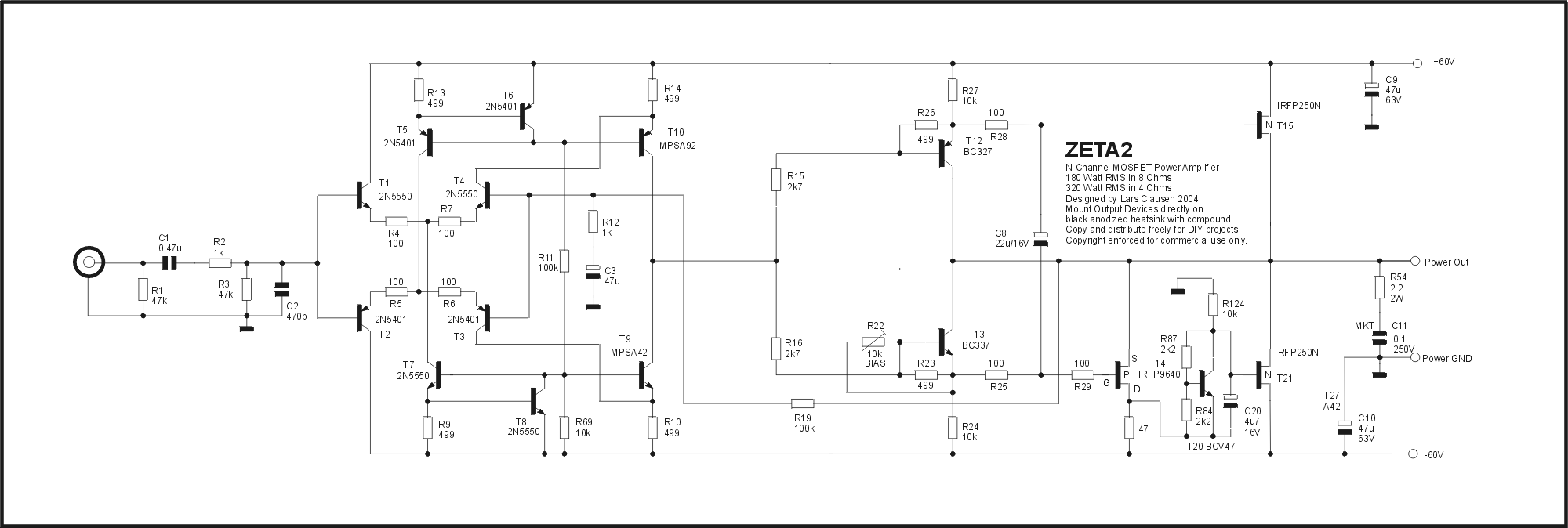

Yeah jfets on front end.
Then laterals without degeneration
Then source follower buffer laterals without degeneration
Then quasi output stage.
If we bias up laterals on 2nd gain stage without degeneration say 100mA we can do away with buffer driver stage.
Edit: You can see I have to try and simplify everything.

I can't quite figure out T5/T6/T10.
T5/T6 looks like a CCS feeding the lower LTP. But then T10 has a common base with T5, making it a current mirror?
Is it just a way to do a CCS for the lower LTP and a current mirror for the upper LTP with one less transistor?
Don't worry, with jfets we will turn it into a much simpler folded cascode front end.
