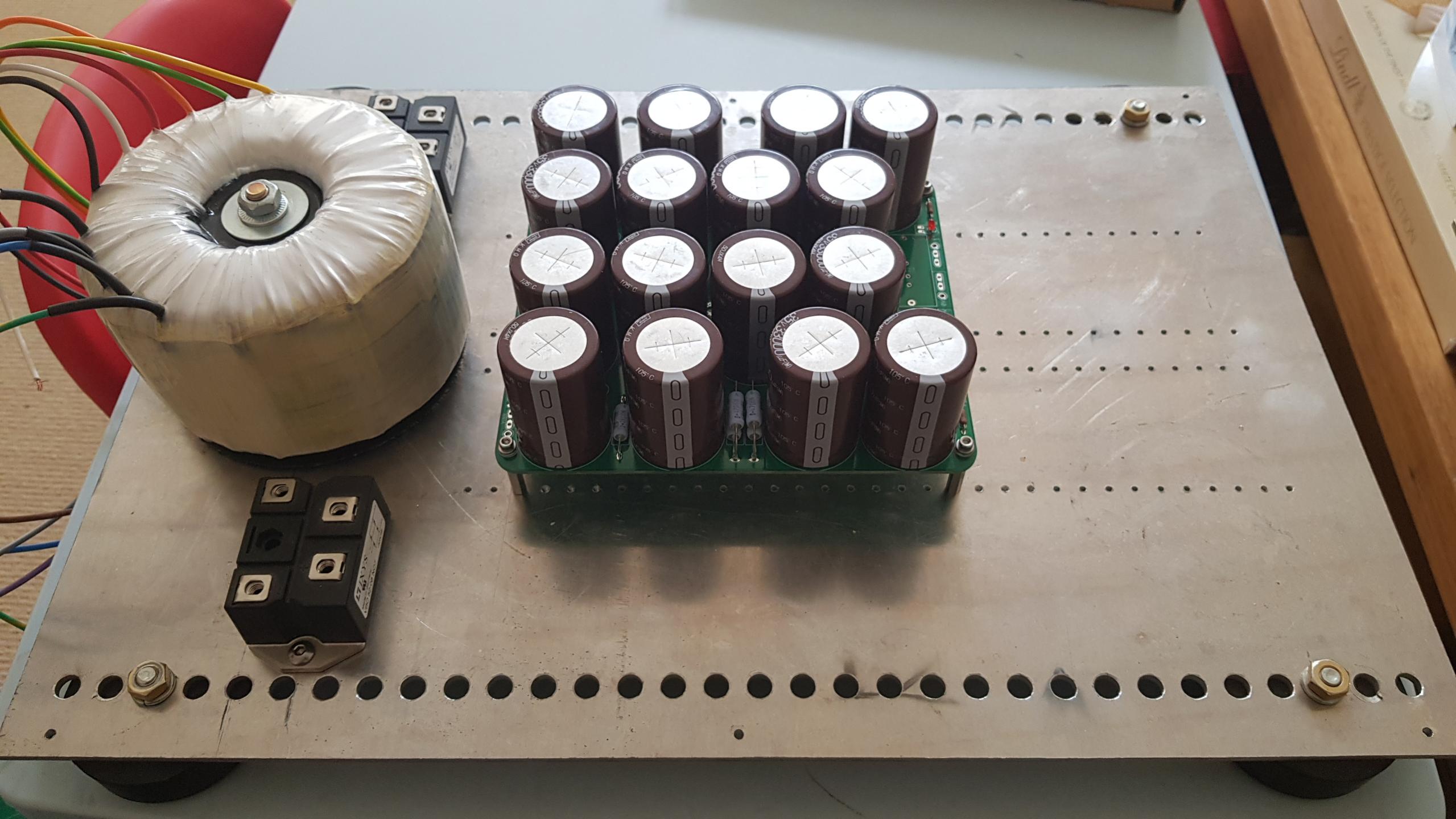

I'm adding this here just to bloody remind myself.
Pri A: 0—120v (BLUE—GREY) 50/60Hz
Pri B: 0—120v (VIOLET-BROWN) 50/60Hz
----------- SCREEN ------- (GRN/YEL) -----------
Sec 1: 0—19v—25v (BLACK-WHITE-RED) rated at 10.0A rms.
Sec 2: 0—19v—25v (ORANGE-GREEN-YELLOW) rated at 10.0A rms.
---------- MUMETAL BAND ------------------------
Resin Filled Centre = M8 Hole / M8 x 130mm Bolt Supplied.
Total Rating: 500VA.

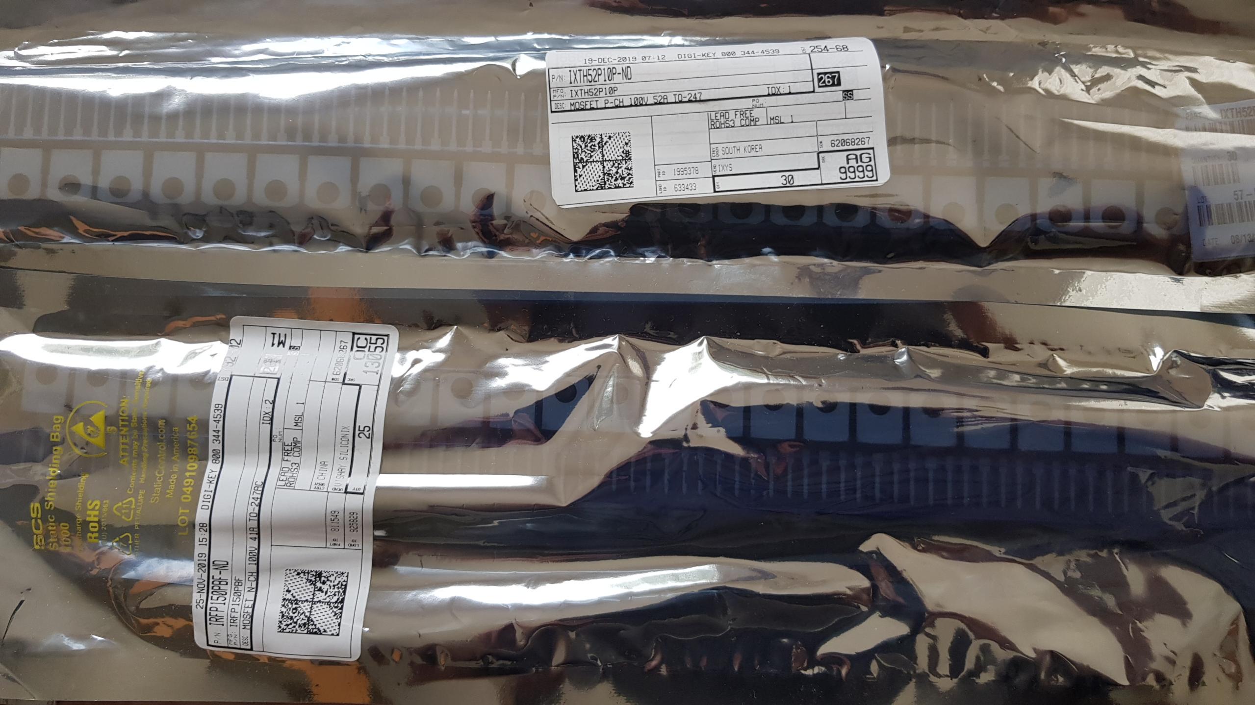

Some more eye candy.
These are virtually perfect matching devices, at least according to Id vs Vgs curves on data sheet.
I will measure up later.
Ixys IXTH52P10P
Vishay IRFP150 (Has to be Vishay for closest matching specs)
https://m.littelfuse.com/~/media/el...osfets_p-channel_ixt_52p10p_datasheet.pdf.pdf
https://www.vishay.com/docs/91203/91203.pdf
Ixys IXTH52P10P
