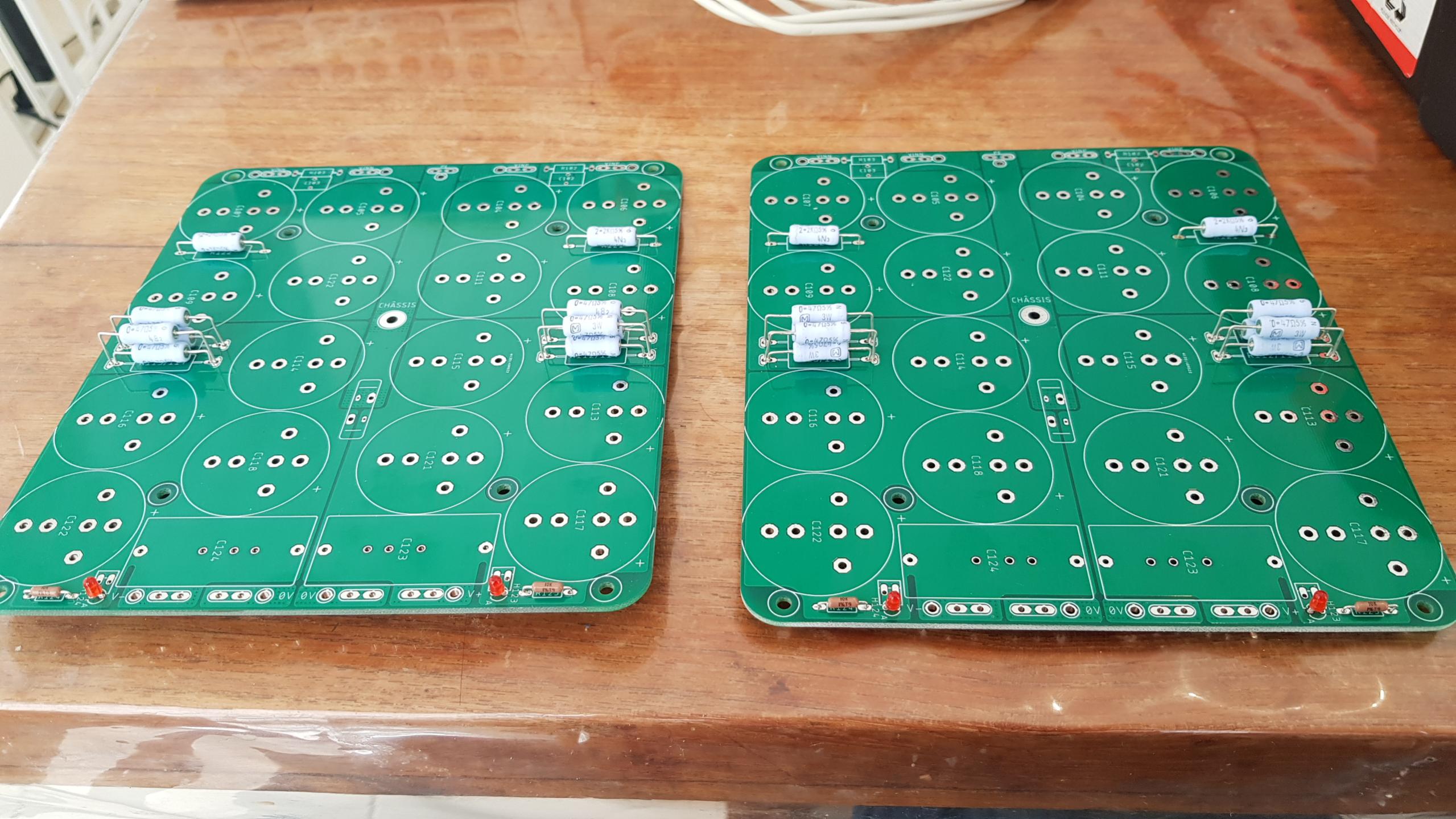

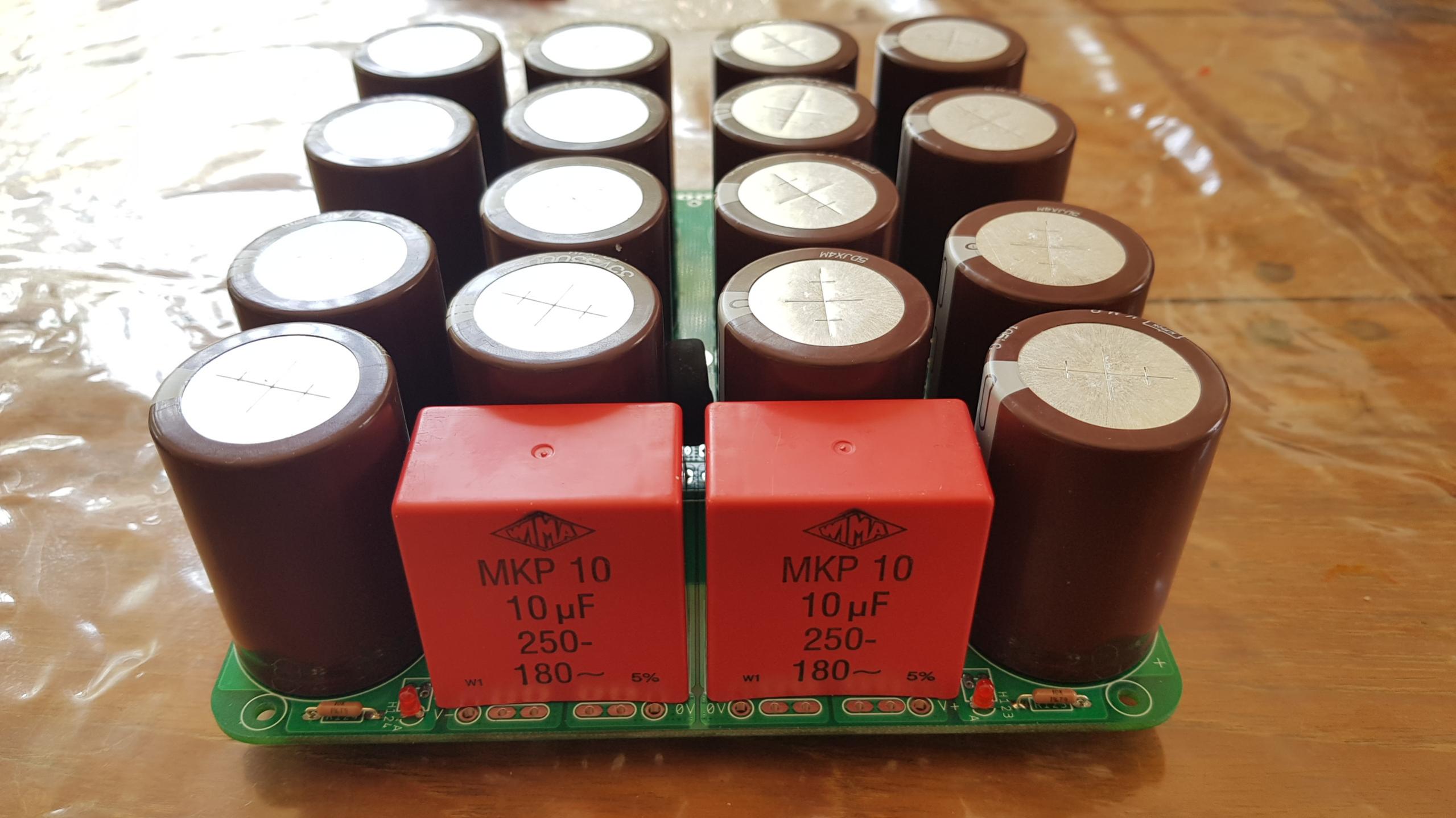

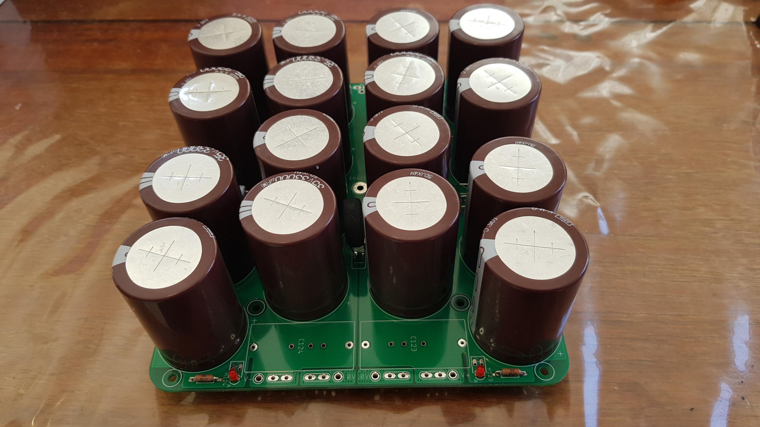

Some progress.
Debating whether to actually insert polypropylene caps on the board (c123, c124) or not worry about them.
Edit: I will run without, and maybe add later.
Looks like you are staying with the standard FirstWatt power supply voltages. Bleeder resistors are only 2.2k 😉
I have 2 x 500VA transformers that have dual 19V and 25V taps on the secondaries.
On one channel going with 19V taps, that should give me around 25V rails, on the other channel I will use the 25V tap and maybe go regulated or cap multiplier, rail voltages to be decided depending on whether I go regulated or cap multiplier.
Then compare the two.

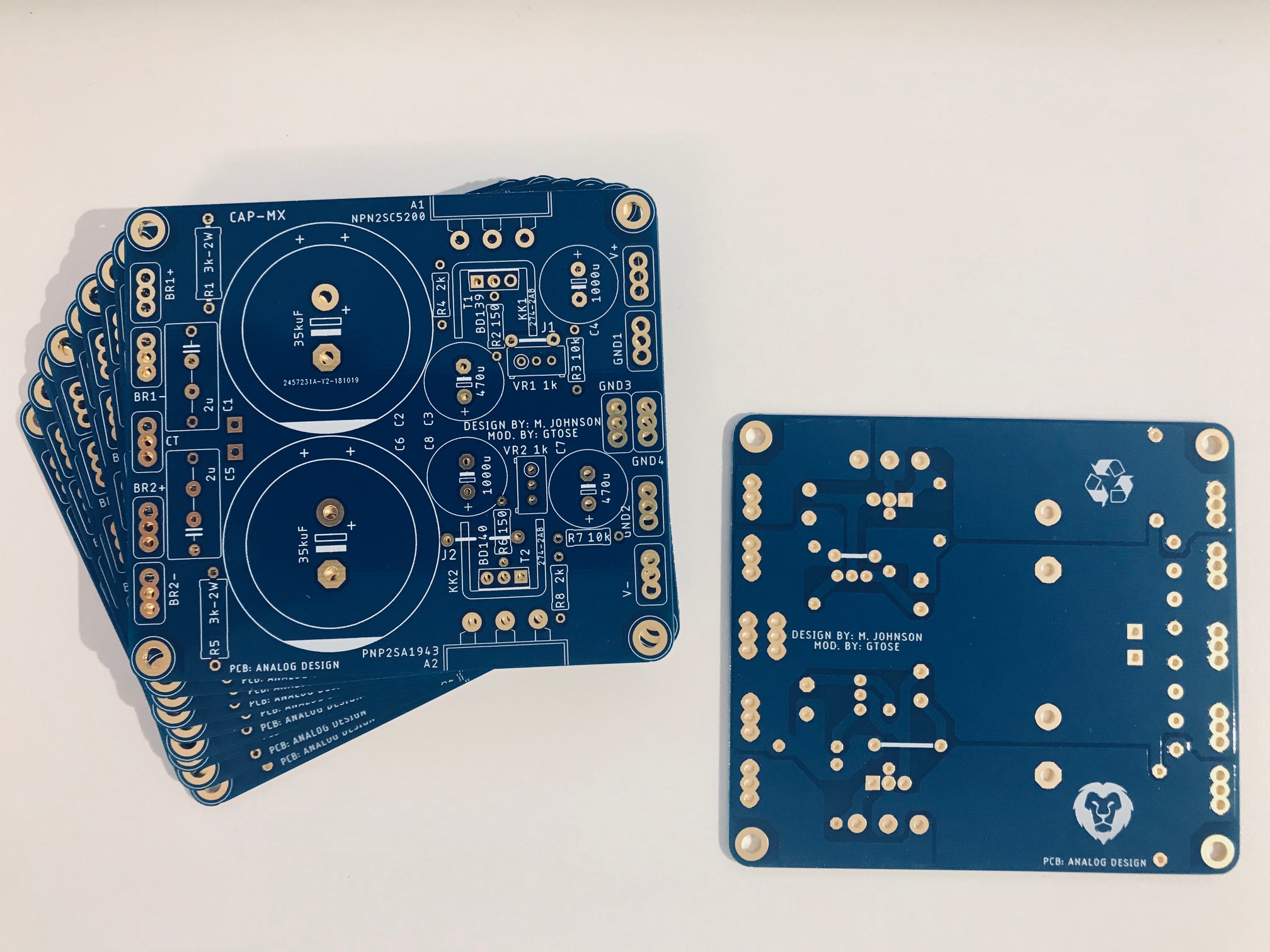

For cap multiplier I can highly recommend the simple boards that Prasi did with the gtose/mark johnson design. I'm using those on an F7 "clone" right now. ZERO noise or hum. Transformers are Antek 200VA 22V. I'm getting +/- 24.5V DC after the cap multipliers with the amp turned on.

Experimenting is the name of the game.
I will be doing my own regulator or cap multiplier.
