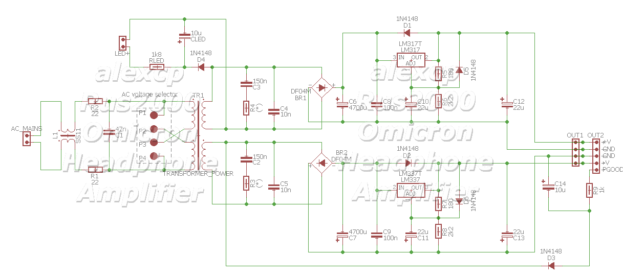

I would not expect any problems with a single power supply. One NE5532 normally draw about 10mA, so eight of them will draw an additional 80 mA on each rail. The power supply board accommodates transformers up to 25/30VA (depending on construction), which is sufficient for up to 600mA rails. Those trafos won't fit into 1U enclosure, but 50mm and taller will be enough.It will require 6 to 8 op-amps (probably NE5532) on top of the balanced line receiver. Considering I want to drive Focal Clears, which are 60 ohms (342 at their resonance) & 104 dB for 1 mW, will the power supply be able to drive the active electronics in parallel also or should I add a second one ?

For the power supply, as I envision something with a big knob (like JDS Labs EL-AMP) and a few switches readily accessible, on my desk (maybe integrated in the furniture), I can totally put the power supply in another box under the desk.

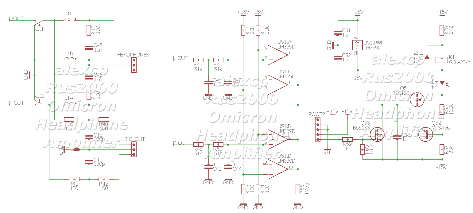

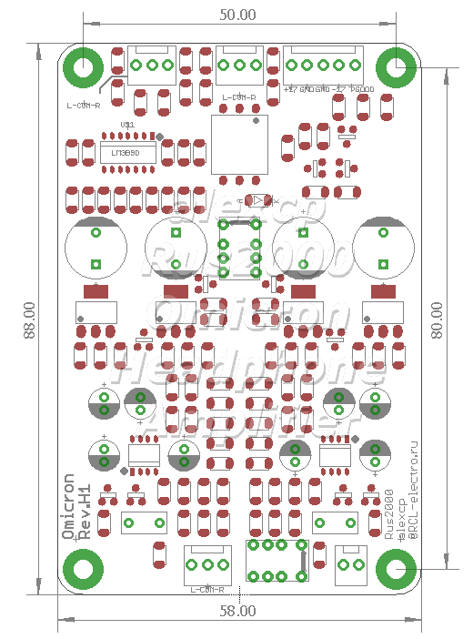

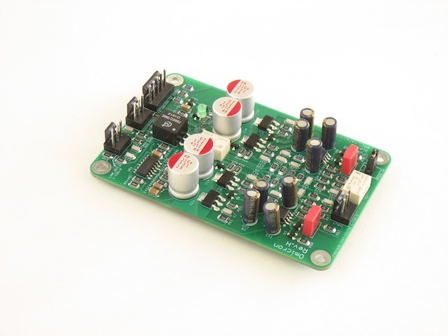

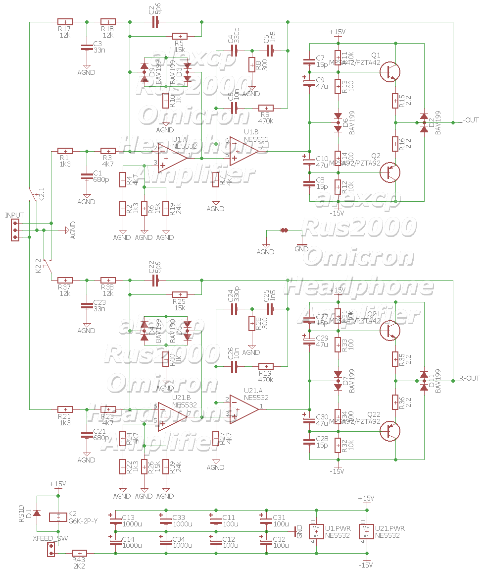

Besides using mostly SMT components, Omicron's SMT board:
adds a couple of extras to the schematic:. First, the crossfeed is switchable at runtime by a relay (K2):
Shorting the XFEED_SW connector connects the crossfeed.
Second, there is a line output with a separate RCR T-filter:
The output filter for headphones is based on the original idea by Nazar Shtybel and was discussed above.

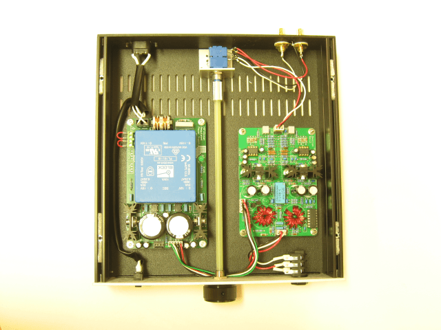

The board is about 88×58mm with two layers and serves as the heatsink:
As mentioned above, the smallest SMT packages are 1206 for passive components and SOT-23 for diodes and transistors, so the board is quite solderable by hand.

- I didn't notice in the thread any mention of why the relay selectable cross-feed was not included in the through-hole version. I'm certainly not questioning it's exclusion, and I could build one with and one without, but is there any insight you could offer? Note - I fully realize that it was part of the design intent, but it's on the SMT version.
- I will need volume pots for all the builds. You also mention that the input impedance (post #67) could be raised depending on the source, and that seems to be a recommendation at this point, correct? If I use a 10k linear pot as described in post #2, I would assume, but I am not sure, that I would not need to 'alter' the components from the 'original' schematic correct? The pot would now be the overriding component in determining input impedance? Would going to a 20k (or higher) value have any meaningful negative effect? I ask b/c at least one of the amplifiers would be for high-sensitivity IEMs, and (I think) the higher maximum impedance may be a benefit at lower listening levels, particularly with a linear profile and trying to get past the general channel mis-match found with some pots at high attenuation. However, I could be completely off-base. Admittedly some of this flies right past me.
- Based on posts #67 and #2, along with the schematics I have a few questions.
- For SMD (BoM not yet released, but schematic posted). R17, R18, and C3 in post #67 correspond to C37, C38, and C23 in the posted build schematics accordingly, and the values match. (12k, 12k, and 33n). If adding a 10k pot, would you recommend using the 'original' values of 3k9, 4k3, and 100n?
- For Through-hole (BoM and schematic posted). The equivalent parts identifiers on the schematics are the same as noted above. However, in the full schematic, C37, C38, and C23 are 3k9, 4k3, and 100n accordingly. However, the BoM posted has the 'updated' values. I got the schematic from post #42 linked from post #1, and the BoM from post #155. Would you recommend the 'updated' 12k, 12k, 33n configuration in addition to the pot or leaving it as 3k9, 4k3, 100n?

1. The story with switchable crossfeed: the SMT board has it because it also has a line output - presumably you wouldn't want crossfeed for anything except headphones. The through-hole board has no line output, so the crossfeed is permanent (or permanently absent, that's the builder's choice). The fun of switching crossfeed on and off while listening to Pink Floyd was unintended and discovered accidentally. My own SMT board with headphones connected has crossfeed permanently on.

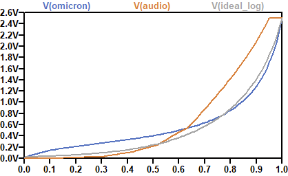

2. With an inverting amplifier like Omicron, a volume control with good angle-to-gain law is a linear pot with resistance between 5 and 10 times the input impedance of the amplifier. For example, 10k or 20k pot for the original version with 2k input impedance and 20k to 50k pot for the 6k input impedance option. Withn these values, the law closely resembles an ideal log characteristic: (blue is Omicron 6k + 50k pot, gray is an ideal log pot, orange is a typical "audio" taper pot):
An additional benefit of using a linear (vs. audio taper) pot is that they often have better matching between gangs.
So yes, if your source is able to drive a 1-2kOm without distortion, go ahead and use a 10k linear pot with other values as per post #2 schematic - this configuration runs in my build. A pot with a higher resistance (e.g. 20k) will give you a slower volume increase at low volume.
If you use the higher impedance option from the BOM, you'd be, in principle, better off with a linear 25k or 50k pot - but 10k also seems to work ok, so this isn't so critical.
By the way, the names of the same parts in the TH and SMT verisions are identical. On both boards, R17 R18 C3 corresponds to R37 R38 C23 in the other channel.

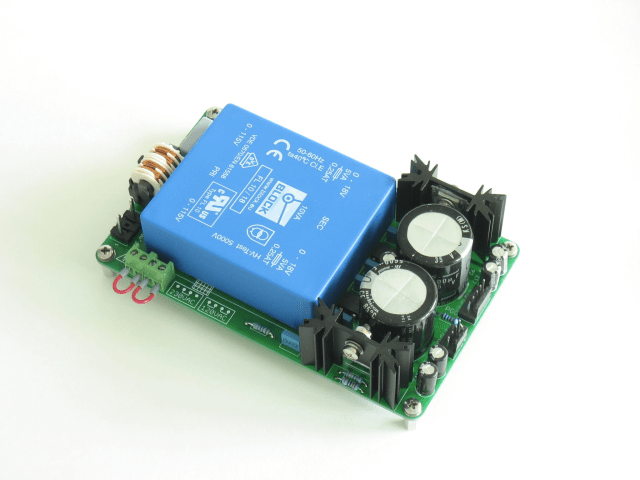

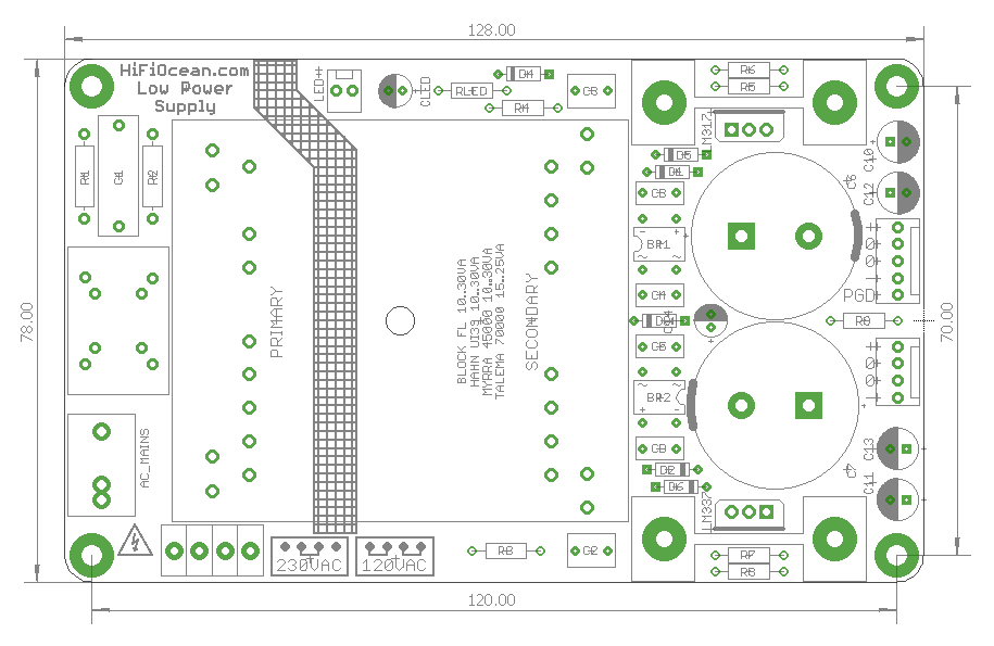

Omicron's power supply:
is built on a two layer 128x78mm PCB with four mounting holes in the corners of a 120x70mm rectangle:
The board carries a PCB-mounted power transformer, two regulators (LM317/LM337 based), a power loss detector that works with Omicron's protection circuit, and an optional separate small rectifier for a power-on indication:
The power supply includes an LRC filter on the transformer's primary side and CRC snubbers on the secondary (see Mark Johnson's excellent topic on snubbers and his Quasimodo jig for details). The rest of the circuit is straightforward.
The board is designed to accommodate low-profile PCB mounted transformers such as Talema's 7005xK (15VA) 7006xK (25VA) toroids - they share the same footprint but have different heights - or, preferably, BLOCK FL series (10 to 30VA versions also share the same footprint but differ in height). Talema 15VA and BLOCK FL 10VA and 14VA (and maybe 18VA) transformers will fit into a 1U enclosure.
There are similar transformers from other manufacturers (HAHN, Myrra, etc.) that may fit the board, but their pinouts may be different and must be verified first.
Since all the recommended transformers have dual primary windings (115V+115V), the board includes a simple primary voltage selector (115VAC/230VAC).
When selecting a transformer for this board, keep in mind that some voltage will drop on the LRC filter in the primary circuit - the more the better, as long as the regulators do not drop out of regulation. A practical approach is to select R1 and R2 on the schematic above so that under full load current, the DC voltage at the input of each regulator is 3V higher than the output voltage (e.g. 20V for 17V rails). The resistors' value will depend on your primary voltage, too.

parts list for the PSU
Qty | Value | Device | Package | Parts | Example P/N |
2 | 10uF 50V | Aluminum electrolytic capacitor | Radial D=5mm | C14, CLED | EEUFC1H100L |
4 | 22u 50V | Aluminum electrolytic capacitor | Radial D=6.3mm | C10, C11, C12, C13 | EEUFC1H220 |
2 | 4700u 25V | Aluminum electrolytic capacitor | Snap-in D=25mm | C6, C7 | B41231B7478M000 |
4 | 150nF | Ceramic or MKS/MKT film capacitor | Radial LS=5mm | C2, C3, C8, C9 | MKP2F021501B00KSSD |
2 | 10nF | Ceramic or MKS/MKT film capacitor | Radial LS=5mm | C4, C5 | MKS2G021001A00MSSD |
1 | 10mH | Common mode choke | LS=7x8 or 10x13mm | L1 | SU9VD |
1 | 2-way | Connector | 0.1in contact spacing | LED | 22-23-2021 |
1 | 2-way | Connector | 0.312in or 0.4in contact spacing | AC_MAINS | See text |
1 | 5-way | Connector | 0.1in contact spacing | OUT2 | 22-23-2051 |
6 | 1N4148 | Diode | DO35 | D1, D2, D3, D4, D5, D6 | 1N4148-T26A |
2 | DB104 | Diode bridge | DIP4 | BR1, BR2 | DB104 |
2 | 1in tall | Heatsink | Aavid 531x02 | 531002B02500G | |
1 | LM317T | LM317T | TO220 | LM317 | LM317T |
1 | LM337T | LM337T | TO220 | LM337 | LM337T |
1 | 2x18V | Power transformer | BLOCK FL 10VA, Talema 15VA | TR1 | See post #174 |
2 | TBD | Resistor 0.25W | D=2.5mm L=6.3mm | R3, R4 | See text |
1 | 1k | Resistor 0.25W | D=2.5mm L=6.3mm | R9 | MFR-25FBF52-1K |
1 | 1k8 | Resistor 0.25W | D=2.5mm L=6.3mm | RLED | MFR-25FBF52-1K8 |
2 | 22 | Resistor 1W | D=2.8mm L=9.0mm | R1, R2 | ROX1SJ22R |
2 | 160 | Resistor metal film 0.25W | D=2.5mm L=6.3mm | R5, R7 | MFR-25FBF52-160R |
2 | 2k | Resistor metal film 0.25W | D=2.5mm L=6.3mm | R6, R8 | MFR-25FBF52-2K |
1 | 47n | X2 safety capacitor | Radial LS=15mm | C1 | 890324025009CS |
4 | n/a | TO220 thermal pad | n/a | LM317, LM337 | 43-77-9G |
2 | n/a | M3x8 round head screw | n/a | LM317, LM337 | n/a |
2 | n/a | M3 nut | n/a | LM317, LM337 | n/a |
4 | n/a | M3 washer | n/a | LM317, LM337 | n/a |
2 | n/a | M3 spring washer | n/a | LM317, LM337 | n/a |
- The height of the assembled power supply board depends on the height of the transformer (see post #174), two heatsinks, and two large electrolytic capacitors (C6 C7). It makes sense to choose all these parts with approximately the same height, e.g. 1 inch / 25mm. Note that C6 and C7 have max allowable diameter 25mm.
- The common mode choke (L1) can be just about any of the many similar parts with inductance between 2 and 22mH. The PCB accepts chokes with pins in 10x13mm or 7x8mm rectangle.
- The AC input connector can be either a Molex KK396 or KK508 3-way header with middle pin removed, or a three-way 0.2 in pitch terminal block without its middle contact. Of course, soldering bare wire to the PCB is also possible.
- Only one output connector (the 5-way OUT2) is needed for Omicron.
- As noted above, the value of R1 R2 can be adjusted between 10 and 100 ohm should the voltage drop on the regulators under full load is too small or too big.
- The value of the snubber resistors R3 R4 should be chosen based on the transformer used, e.g. with the help of Mark Johnson's Quasimodo test jig. To give you an example, I found the optimal value was 39 ohm for AMVECO 70064K toroidal transformer and 470 ohm for BLOCK FL10/18 UI type.
- Resistors R5 R6 R7 R8 set the output voltage for the regulators, The value shown in the table set 17V rails. Should you want lower voltage, you need to choose these resistors accordingly. Some popular values would be R5=R7=150 ohm, R6=R8=1.3 kOhm for 12V and R5=R7=200 ohm, R6=R8=2.2 kOhm for 15V,
- Thermal pads are optional as the heatsinks are not connected to anything on the board.
