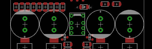

I spotted an error in the BOM for the SMT board - I am sorry about this.
The BOM (post #172) says that C13, C14, C33, C34 can be up to 13mm diameter and gives an example part number that is 12.5mm, which is incorrect - the smaller SMT board was designed for the large caps 10mm in diameter, and an appropriate part number from the Panasonic FC series is the taller (30mm tall) EEU-FC1E102L. Should you not want such a tall part on the board, you can choose e.g. 680uF part such as EEU-FC1E681. Both parts are currently available at Mouser, and other caps with 10mm diameter can be used.
If you already own or ordered 13mm caps, you may still be able to fit them, as the lead spacing is the same (5mm), but perhaps they would need to be installed a couple of mm above the board to allow for nearby surface mounted parts - I will be able to verify this early next week.
I apologize for the inconvenience.
