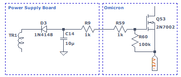

The fast turn-off disengages the protection relay quickly when AC power disappears. In is not necessary - Omicron switches on and off silently. Yet, I added it for purely aesthetic reasons - just as I wanted the power-on LEDs turn off quickly instead of fading over few seconds, I wanted the relay to turn off immediately when the power is off.
The fast turn-off circuit is super simple:
The power supply board carries a separate small rectifier (D3) that charges a capacitor (C14). When the AC power disappears, C14 discharges faster than the bulk capacitors in the power rails, the gate of Q53 goes less negative compared to its source, and it causes the relay to disconnect the load (see also post #53 for the explanation of how this works).
Except that there is nothing to discharge C14! In the first version of the power supply board (see post #35), it was the power-on LED that discharged the capacitor. I received some comments that this creates an unwanted dependency - should there be no LED connected, there would be no fast turn off. So I added a separate rectified for the LED - but forgot to add a discharge circuit for C14. My bad. The circuit was not needed in the first place, so I paid least attention to it and made a mistake.
There are a few options to deal with the problem:
1. Do nothing. Omicron switches off silently, so there is no practical need in fast turn off. You can build the power supply board as is, or you can omit the whole fast-turn off circuit altogether. The relay will disengage a few seconds after the power is removed, that's all.

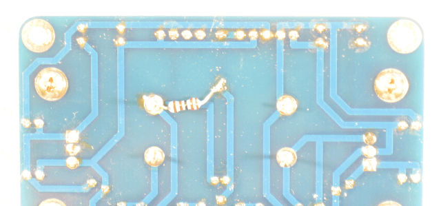

2. Solder a 1kOhm to 4.7kOhm (not critical) resistor on the bottom of the power supply board that will discharge C14:
Here, the resistor is 2.2kOhm. This makes the whole thing work as expected.

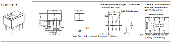

Indeed. It was available when I was posting the BOM for the through hole board. Thankfully, the footprint of RY24W-K is quite common, so substitutes are available from e.g. Omron, KEMET or TE/AXICOM. Just remember to adjust R58 if the coil resistance is different from 2880 ohm.

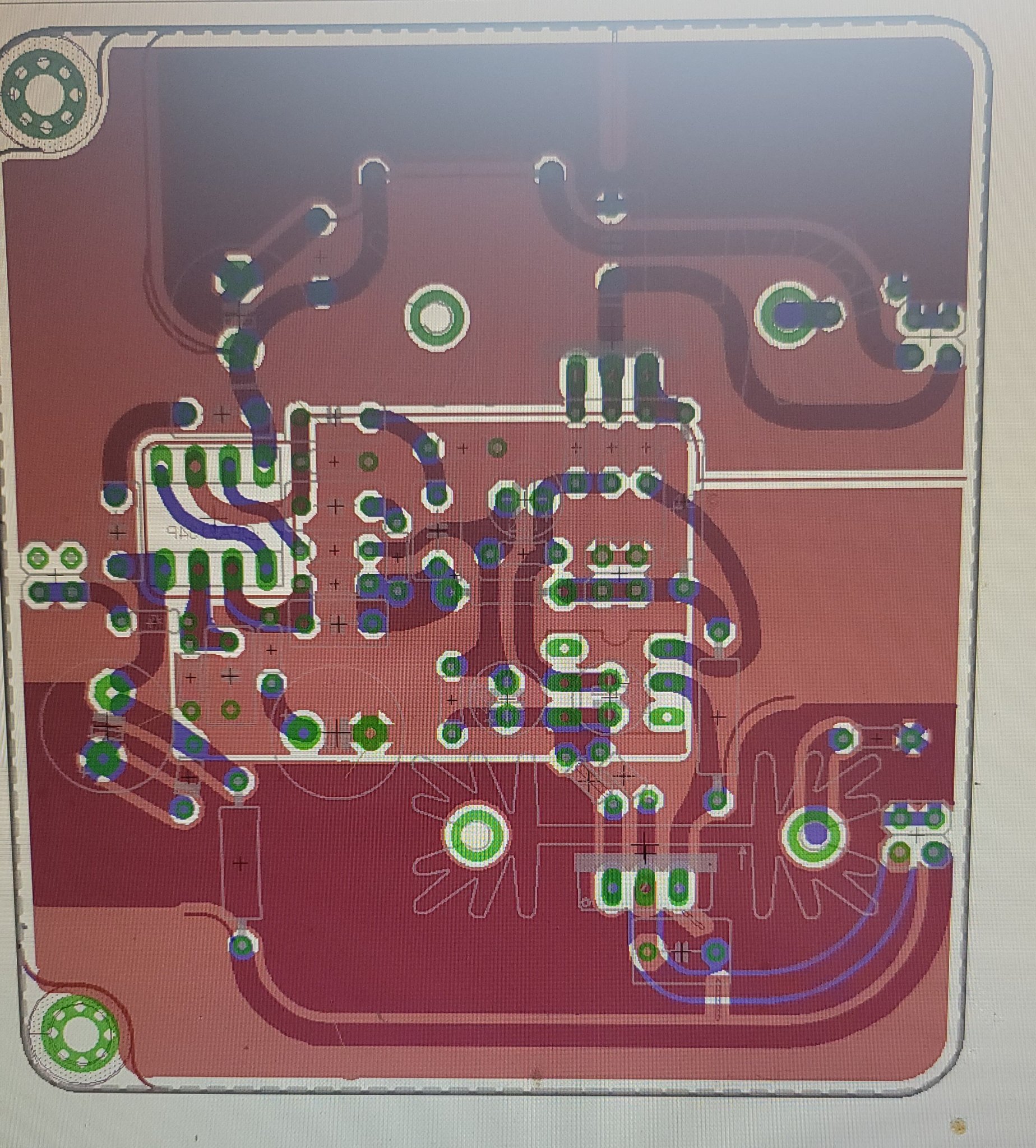

So the idea i voiced ealier, combining whammy output and omicron, i went and built it and it doesnt work. 1v output offset, crazy oscillation.
The layout was a crude first attempt. The opamp is meant to go on the underside of the board so the pinout is reversed.
When i bypass the 2nd opamp and turn the circuit into a regular whammy it works, so its either layout, comp values or else. The circuit connection seem error free tho.
Also im attaching a crude pasting of my schematic.
Any help will be appreciated. Thanks.
