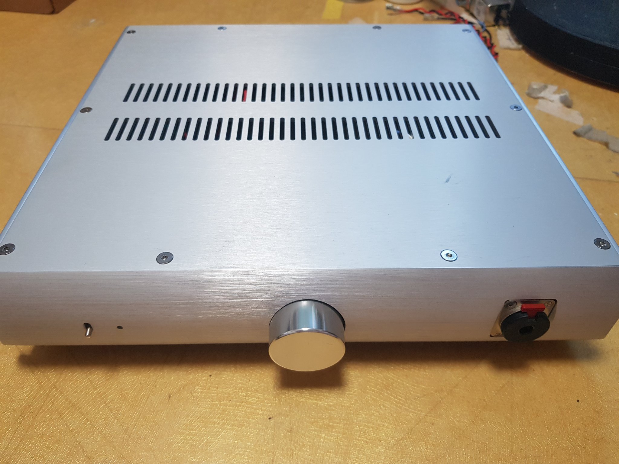

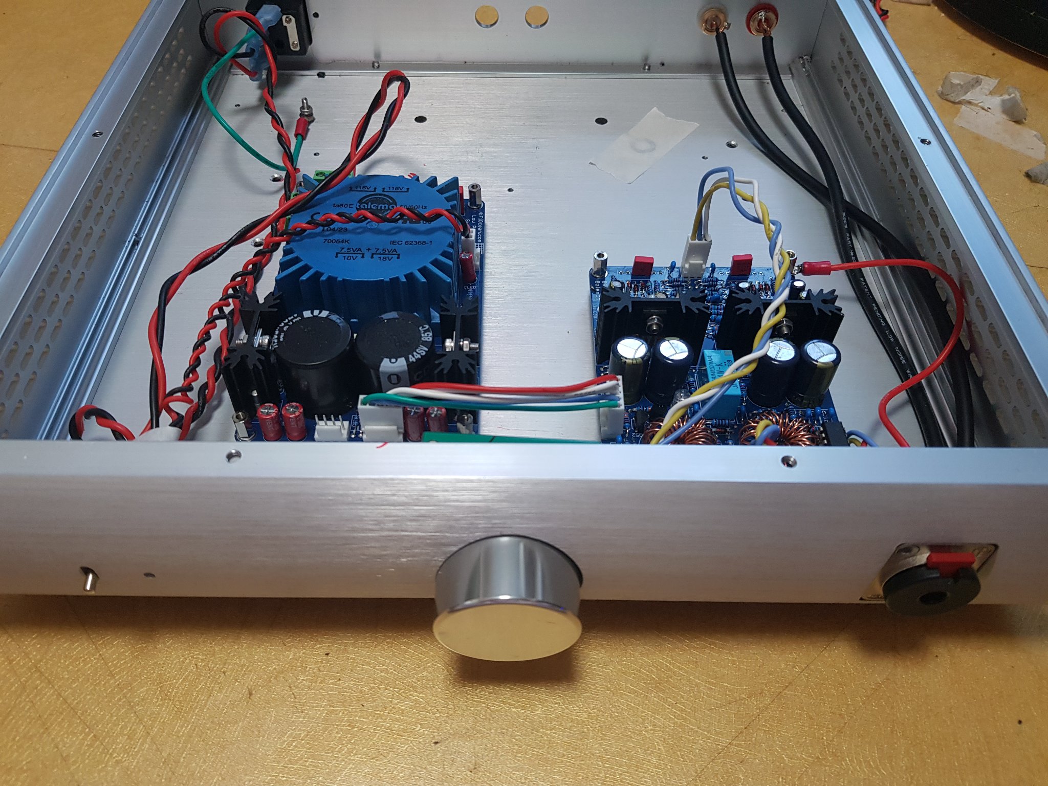

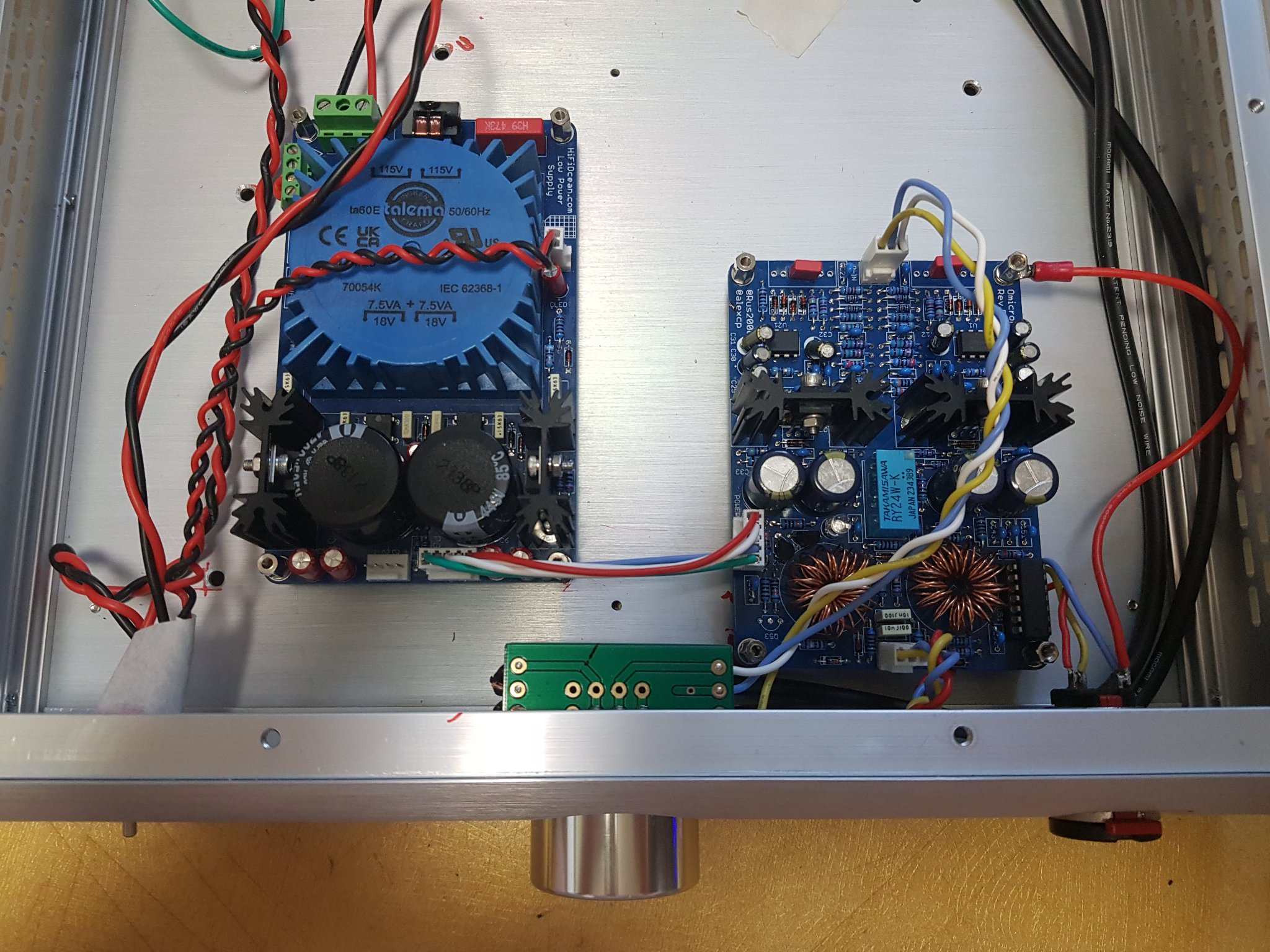

I finally made this THT amp.
Special thank to @alexcp !
He really helped me solve many problems.
It made a little hum ... so I connected ground of headphone adapter to earth ground then hum gone.
I connected my Audeze LCD 2C to this amp.
This is a very powerful and easy listening headphone amp.

Hi Alex,
Would there be any point in having separate ground returns to the power supply ground for the four electrolytic caps (2×100uF and 2x1000uF) and the input and feedback resistors just to keep the last ground return cleaner? I know the currents are relatively small but it is to my knowledge practice in power amps. It could in theory be potentially beneficial but would it make a difference in your design? Also thanks you for your blogs on feedback and others. Makes for intersting reading.
I had a look your power supply and noticed how you wired up the amp pcb. Creative not seen before. That explains your commemts earlier on in the forum that how groundwiring is done on the pcb is critical for ultimate performance. That makes my question irrelevant and I ll retract it.
Reactions: alexcp
Thank you 🙂
For the benefit of others who may be reading this: feedback must be taken from the same points where the load is connected. This idea is mainstream for the "hot" (= actively driven) point. The same requirement applies to the "cold" end. However, in the context of a single-ended connection, where the "cold" end is grounded, the concept of "the same point" becomes confusing, as two ends of a ground wire or PCB trace may or may not be "the same point". The terms "clean ground" and "dirty ground" mean "pretty much the same point" and "not quite the same point", respectively. Should you take the feedback network to the power supply, you would need to take the load there, too - and vice versa. On our boards, this issue has been taken care of, so no extra wiring is required.
