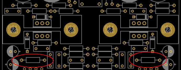

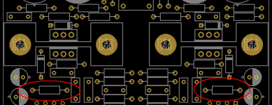

where are R14, R34.

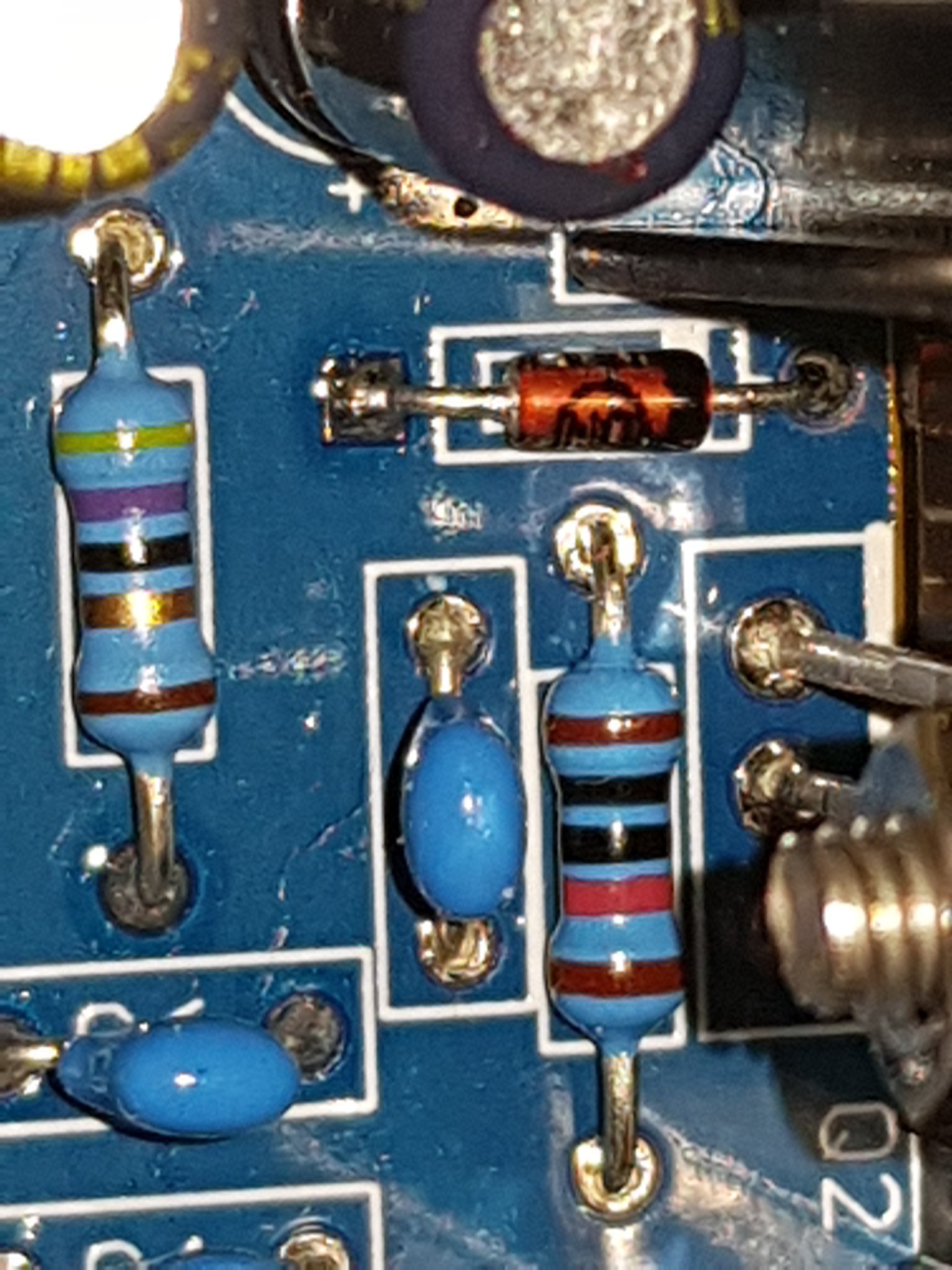

At this point, I suspect that D7 or D8 may be defective (open), or D7 is soldered in the other way around (it is not visible in the photo). The voltage drop of 620mV across each of R15 R16 means the current of about 300mA, which means that all the current from R11 (or R12) flows into the base of Q1 (Q2), instead of into D7 and R13 (R8 and R14). The other transistor is then kept open by the feedback loop, which strives to zero the DC at the output. Please check the voltage across D7 D8 D27 D28, too.
Which one did you use
It doesn't matter. You can use any 5532 model, or the model of any of many other opamps that work in Omicron, e.g. the OPA1642 from TI.
The voltage drop across D7 is way too small - should be about one Vbe (about 0.6V). It goes with the voltage drop across R13 is about zero. 🤔
Let's check Q1. With power off, check both junctions and collector-emitter, each both ways, with a DMM in diode-voltage-drop mode. B-E, B-C should read on Vbe when forward biased and infinity when reverse biased. CE should measure as one Vbe both ways (when the transistor is mounted on this board).
Also, please check the underside of the board around Q1 and its biasing network (R11 R13 R15 D4 C7 C9) for problems.

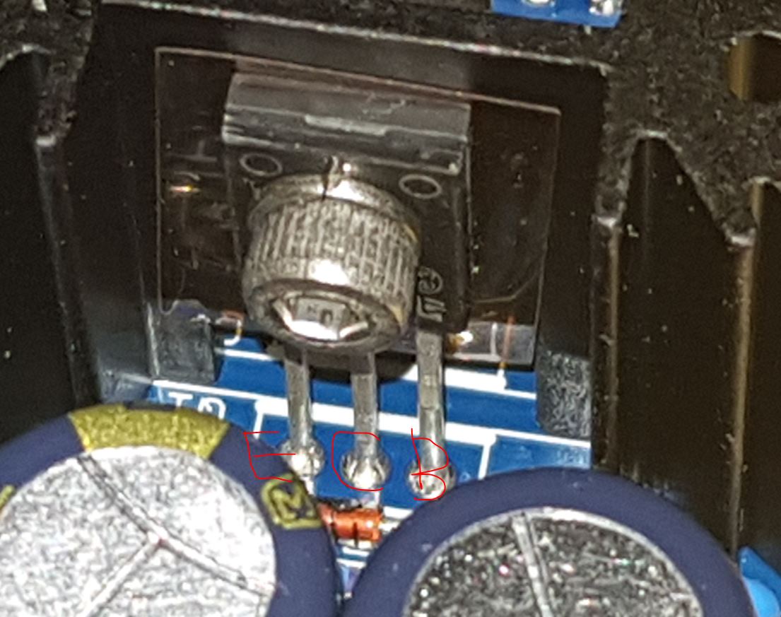

I've reflowed almost of all components of the malfunctioning channel ... but nothing changed.
I made my multimeter in diode mode and checked B-C, B-E, C-E of Q1, Q2 in both ways.
I don't know well I checked these in proper way.🤔
Q2
B-C 0.625 / 1.966
B-E 0,629 / 1.986 -> 1 (changed immediately)
C-E 0.634 / 0.839
Q1
B-C 0.624 / 1.965
B-E 0,628 / 1.926 -> 1 (changed immediately)
C-E 0.628 / 0.838

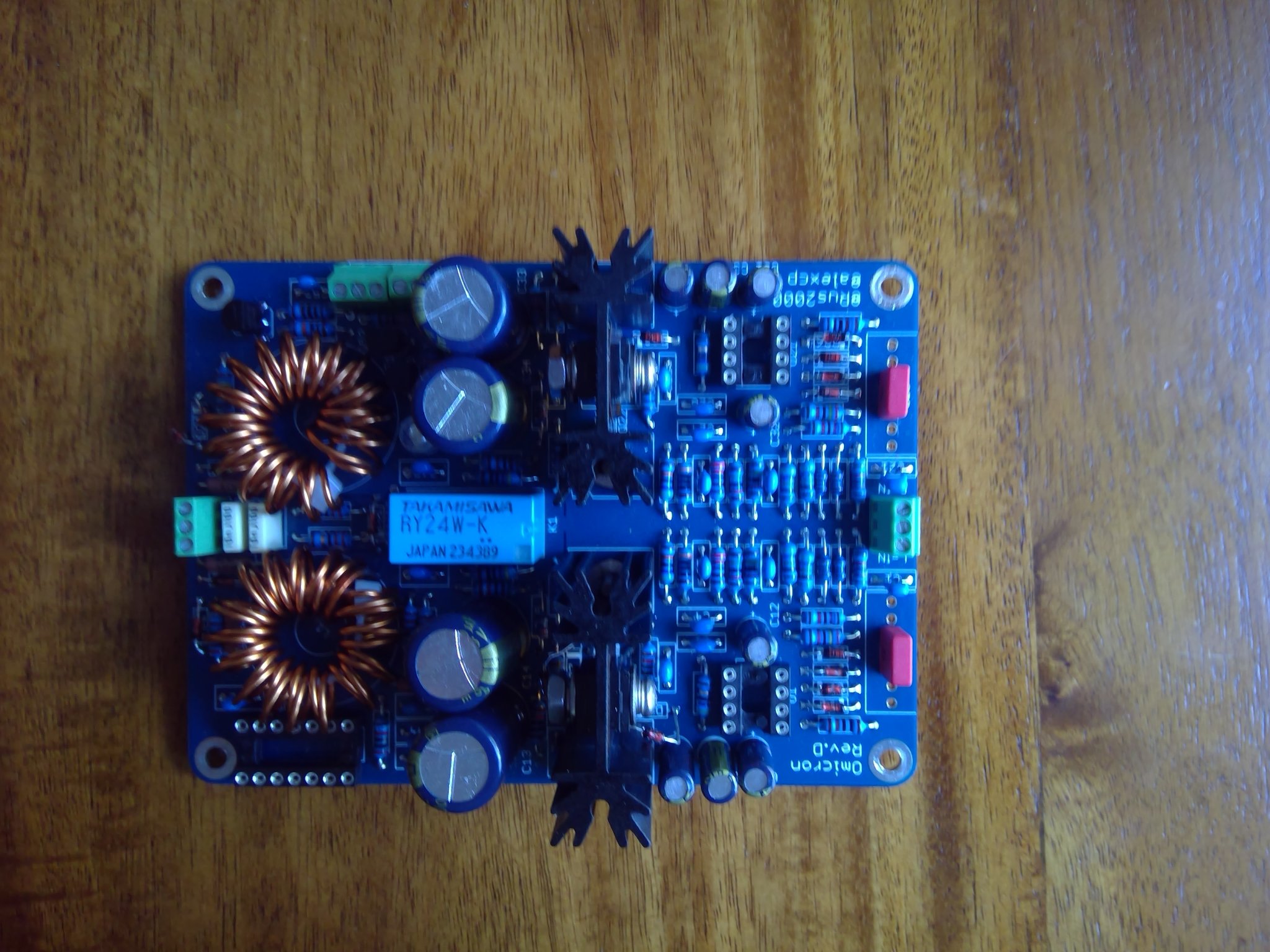

Hoping I might get a bit of help. The negative rail on my through hole Omicron board is shorting to ground. I have gone over the board with a magnifying glass and everything seems to be okay. The diodes and capacitors are installed correctly, as are the transistors and mosfets. I broke D21 while probing around the board checking for continuity. The opamps and comparator have not been installed yet. Any suggestions on where to look?
Thanks in advance.
Dan
It's not easy to see from your photos, but if you haven't checked this already, make sure you have no continuity between the output transistor (Q1, Q2, Q21, Q22) collectors and the heatsink which is earthed. Test both the mounting bolt and pin 2 on each device; if one has shorted, it will short that rail to ground.
