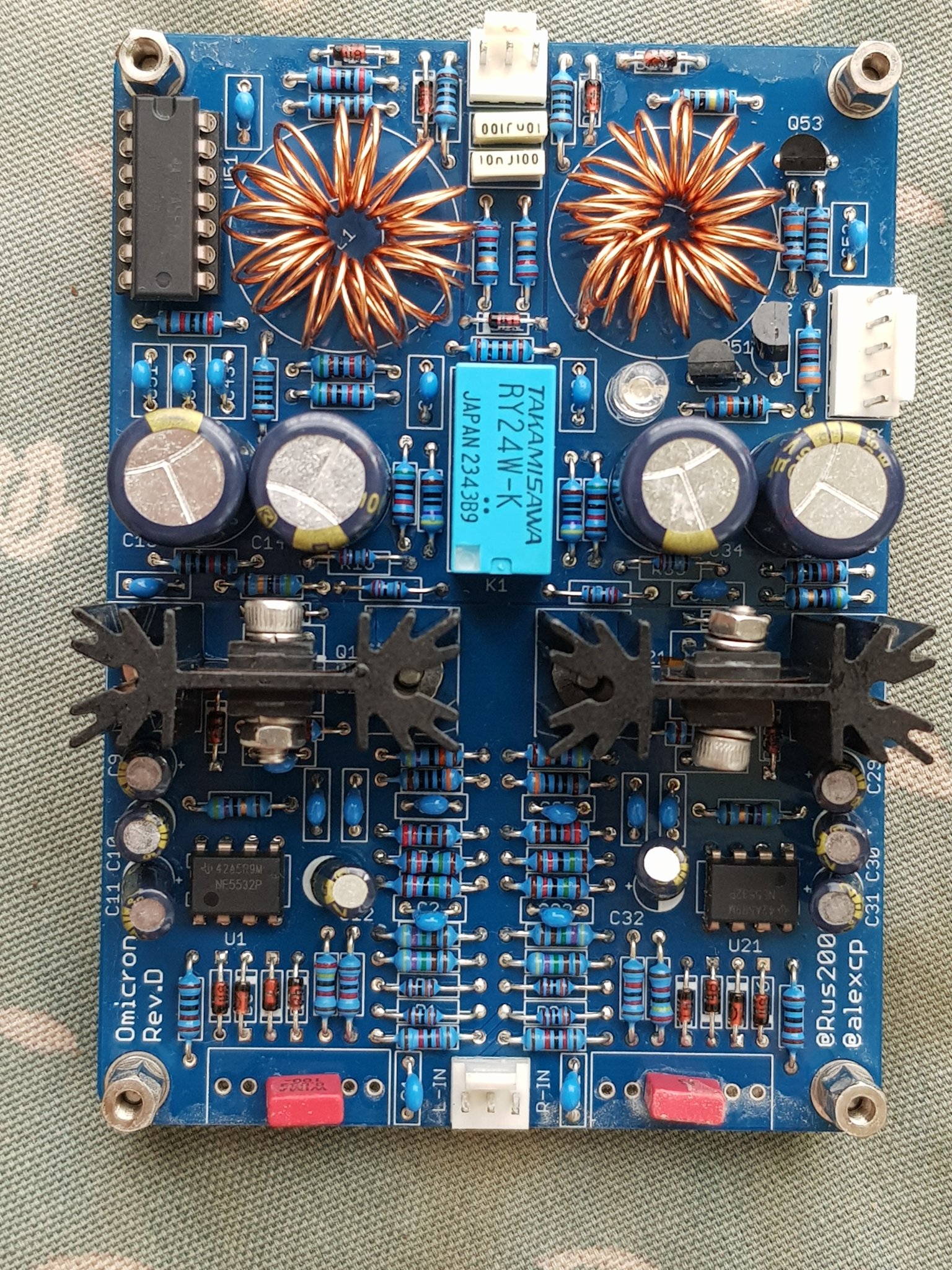

I have assembled my smt and power supply boards, but not tested yet. The power supply's common choke's ferrite was little cracked when I got it but now I found out it is fully cracked. Can I test with it or should I find new one before?

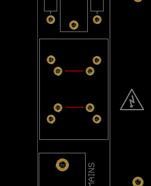

About silk screen of each connectors and led polarity.
I've soldered THT board and Power board without taking photos.
I want to know wiring between power board and dc protection board .. as you know the dc protection board has 5 pin power connector and the power board has 4 pin aux connector.
...and want to know wiring of 'ground connect' pin of dc protection board.

The power supply board, Omicron board and the protection board all have the same pinout of the 5-pin power connector: +V, GND, GND, -V, /PWR_GOOD. The second output connector on the power supply board doesn'e have the /PWR_GOOD pin, but the other four pins are in the same order as on the other connector +V, GND, GND, -V.
If using the power supply board with Omicron, just connect the 5-pin connectors on each board together, pin to pin.
If using Omicron's power supply and protection board with another headamp, connect connect the 5-pin connectors on power supply board to the 5-pin connector on the protection board, and use the 4-pin output on the power supply to power your other headamp. The GROUND CONNECT jumper on the protection board should be left open. Short it only in the unlikely scenario when the headamp and the protection use power supplies with separate grounds.

okdc offet - 3~4mV
10x what it should beR15, R16 - 610~620mV
a bit low but okR35, R36 - 40mV
way too highC13, C14, Q1, Q2 - about 100 ℃
a bit high but okC33, C34, Q21, Q22 - about 50 ℃
Can you please check the voltage across each of R11 R12 R13 R14 and R31 R32 R33 R34?
