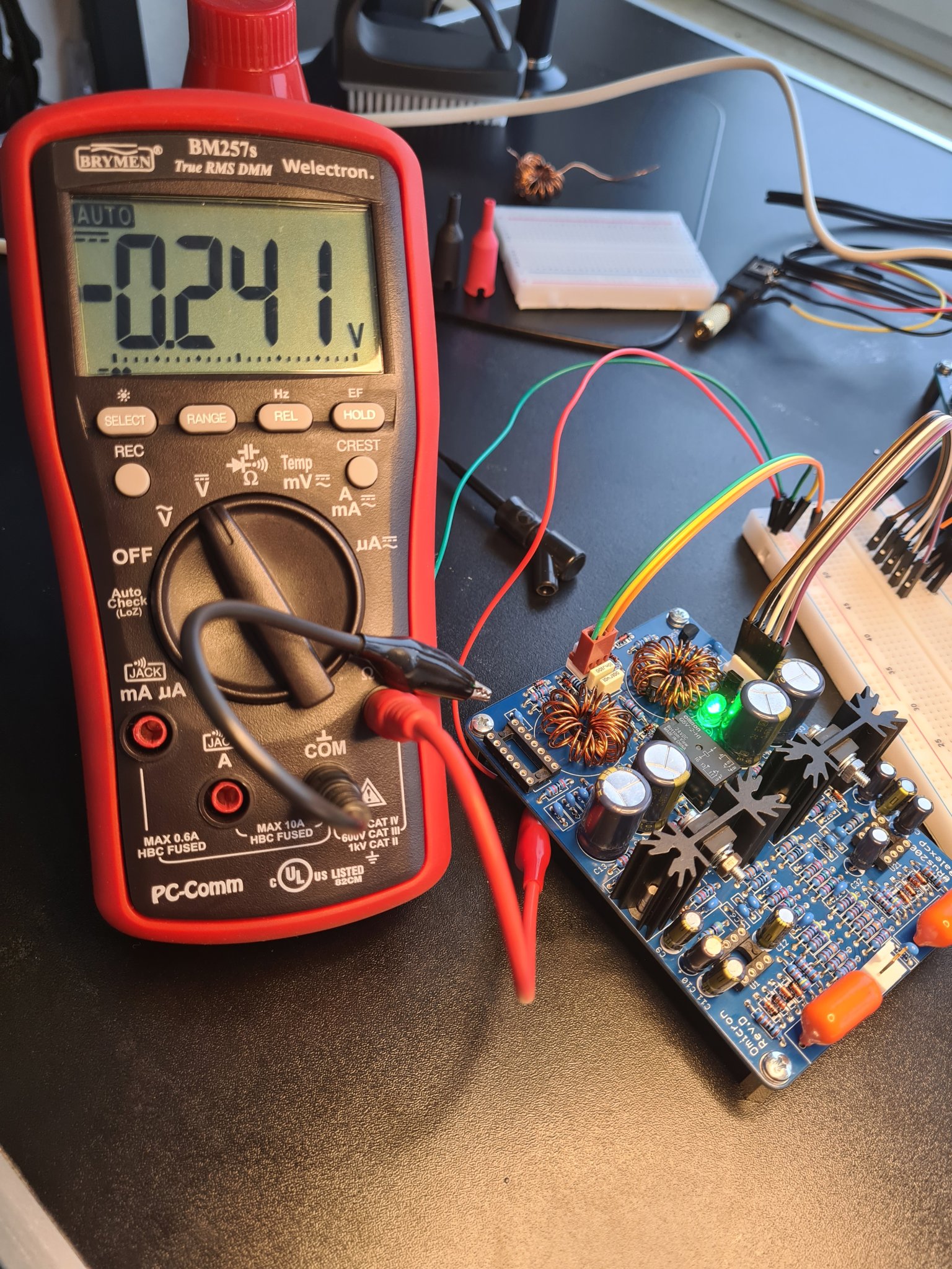

Hello alexcp, after way to much time I finally had enough to buy to get my last missing parts as well and meet the minimum order for free shipping and could "finish" building my omicron. I followed the assembly guide, but I am stuck here:
I think I have problem, I have a constant very high offset of ~240mv at the output which triggeres (rightly) the LM339 when seated.
I measured R15,R16,R35,R36 and they are all at 42mV, which is a bit lower than it should be.
Do you have any Idea where I can start investigating? (I have an oscilloscope)
- Check the offset voltage at the output of the amplifier. It should be close to zero (typically within +/-50mV) even without the opamps.

Don't worry and go ahead with the guide. 240mV is a little on the high side from what we've seen, but it is sufficiently "close to zero".
The deviation of the output voltage from zero without the opamp is due to the NPN and PNP transistors not being perfect complements, and is quite normal. With the opamp in place, the feedback loop will take care of this slight un-symmetry of the output stage.
