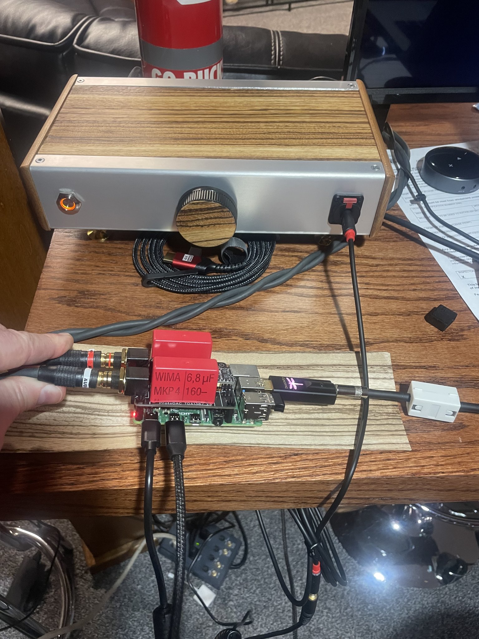

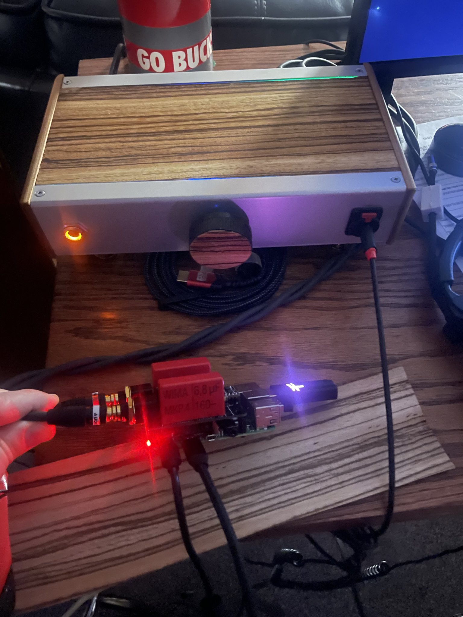

Another Omicron up and running! Unlike many of my builds that remain "unchassis'ed" (part lazy, part lack of skill, part "on to the next thing"......!) I went ahead and buttoned this one up. Sounds really good! Dead quite! Just started messing with Raspberry Pi, DAC HAT (ProtoDac) and streaming. THANK YOU to Alexcp for sharing and making boards available! I post even less than I fully finish projects (diy thing I guess?) so hopefully I have not screwed anything up? High time to participate and more importantly THANK the greater diyaudio community for all the knowledge, willingness to share, help, and inspire! Not possible without this community! THANK YOU!
Ed

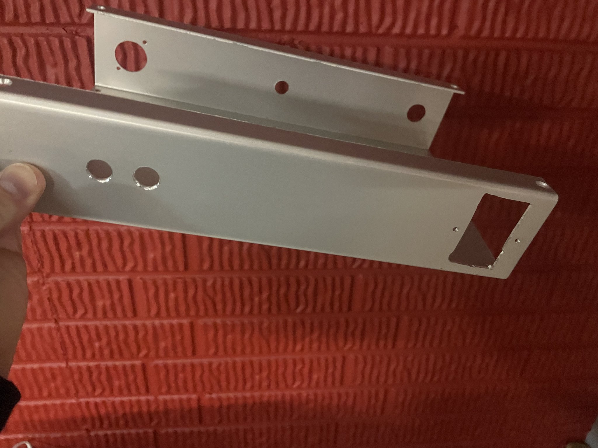

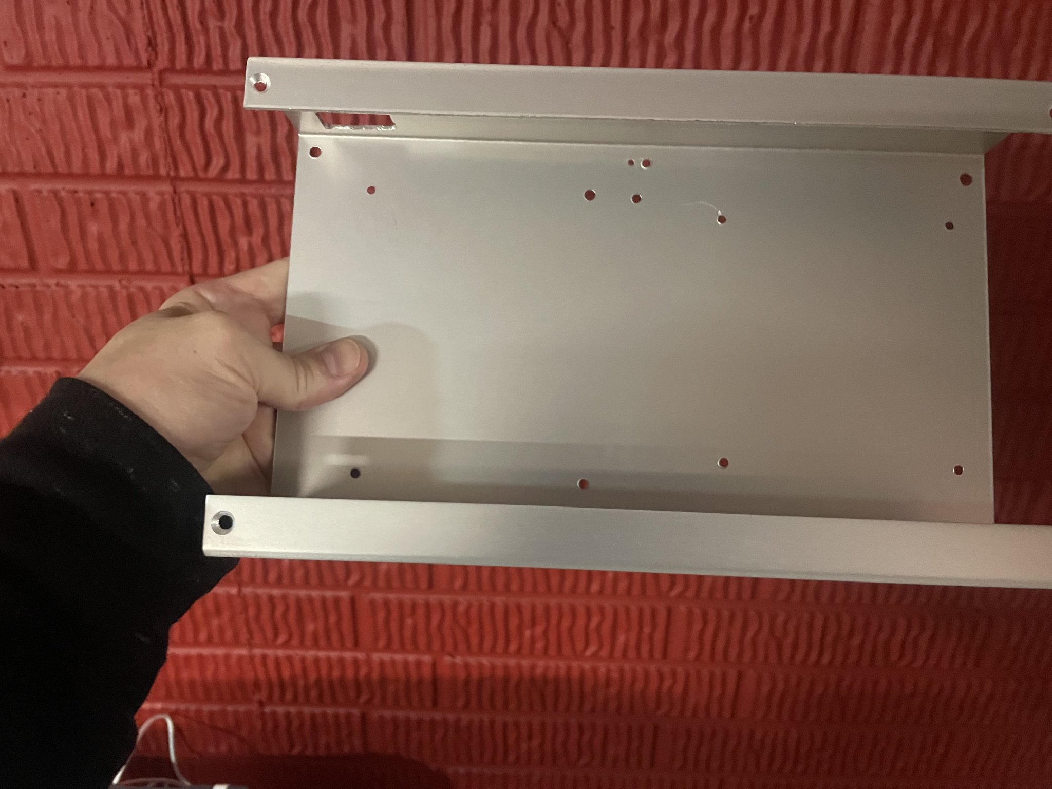

Ed,
I really like your case, I was going to use the same technique. I am glad you did it and it works, and looks great. How did you bend the aluminum? Last time I bent it I had to cut a groove on the backside, was a little difficult to get table saw depth just right.

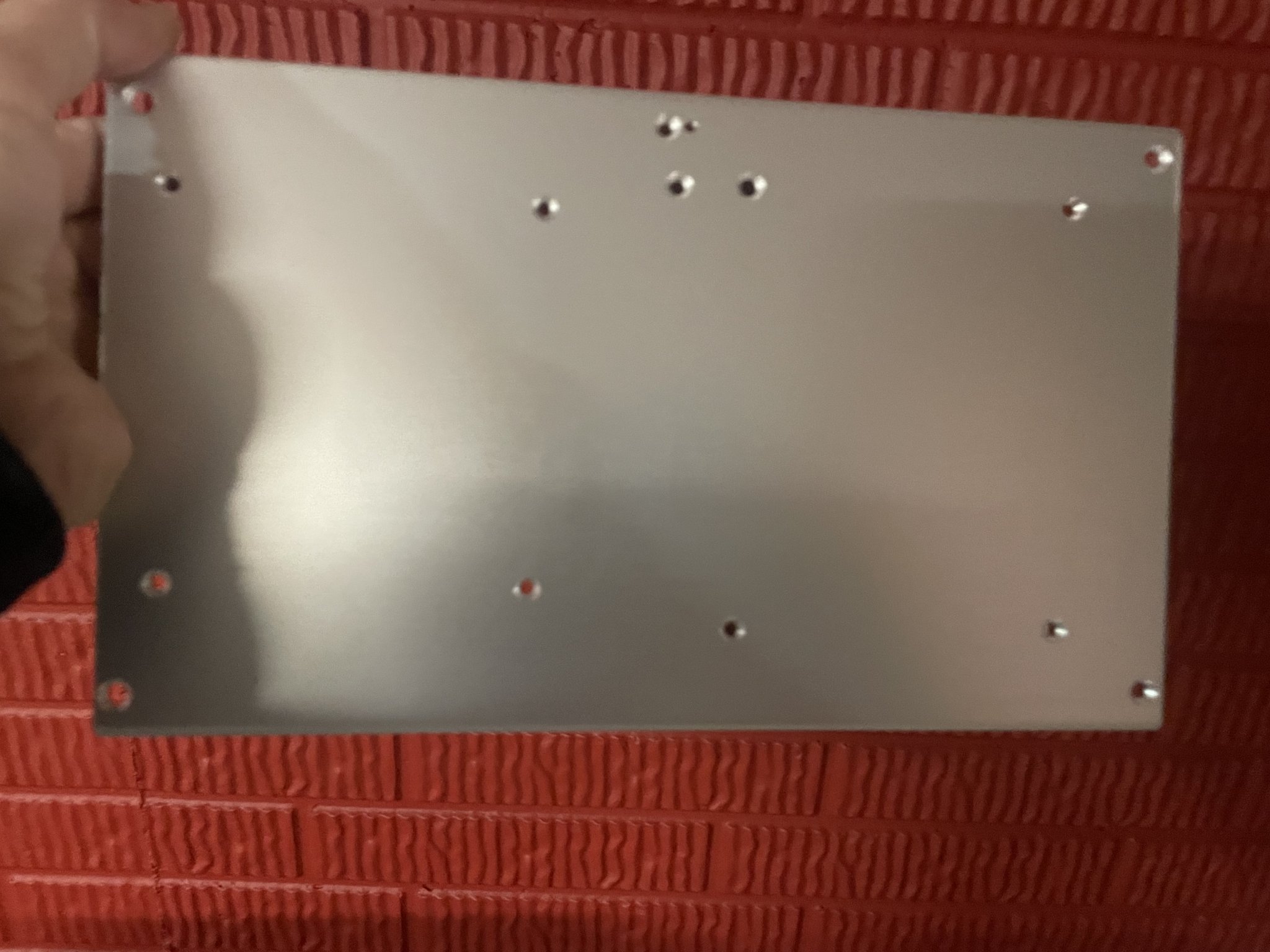

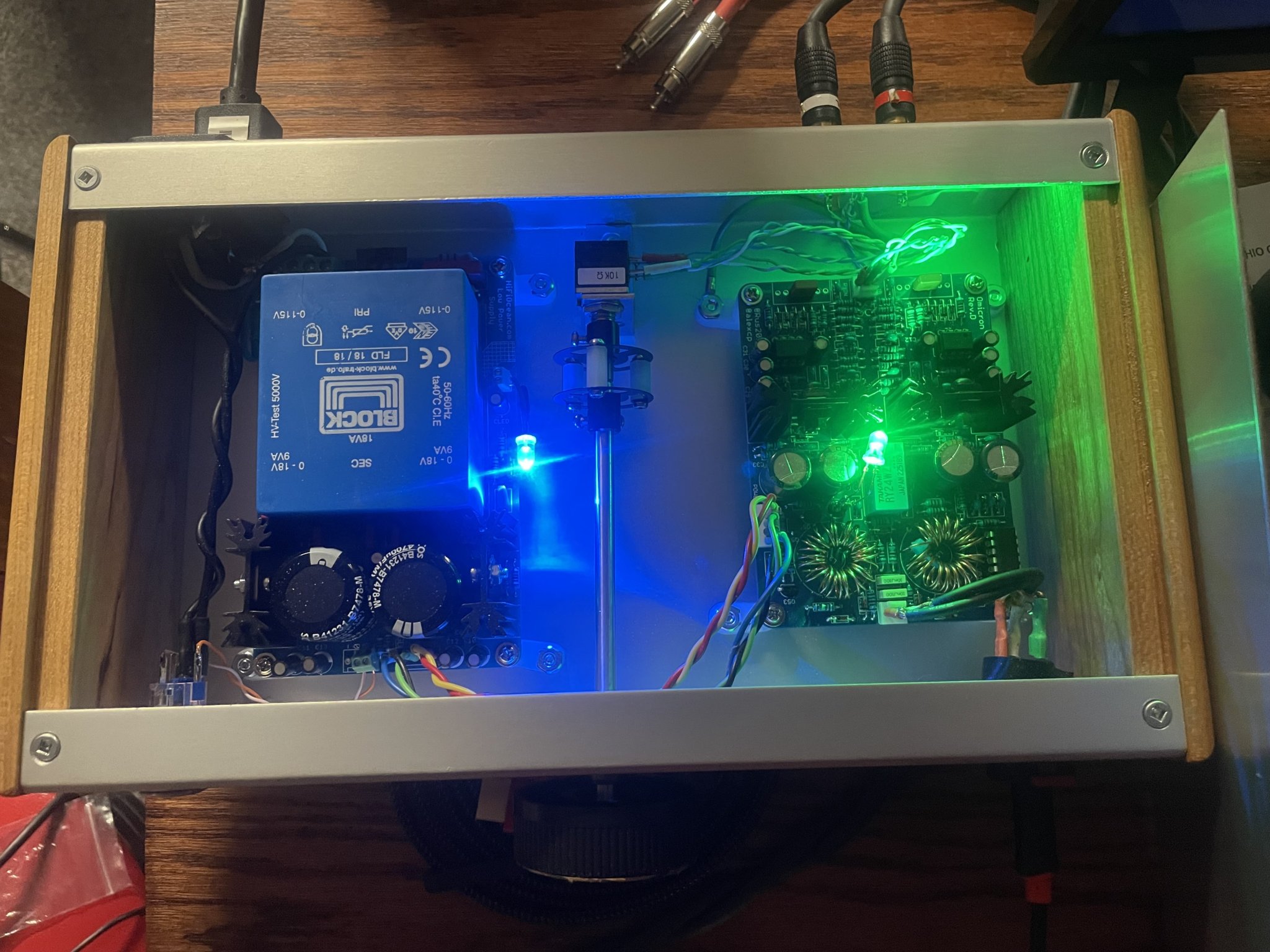

Thanks Bill!

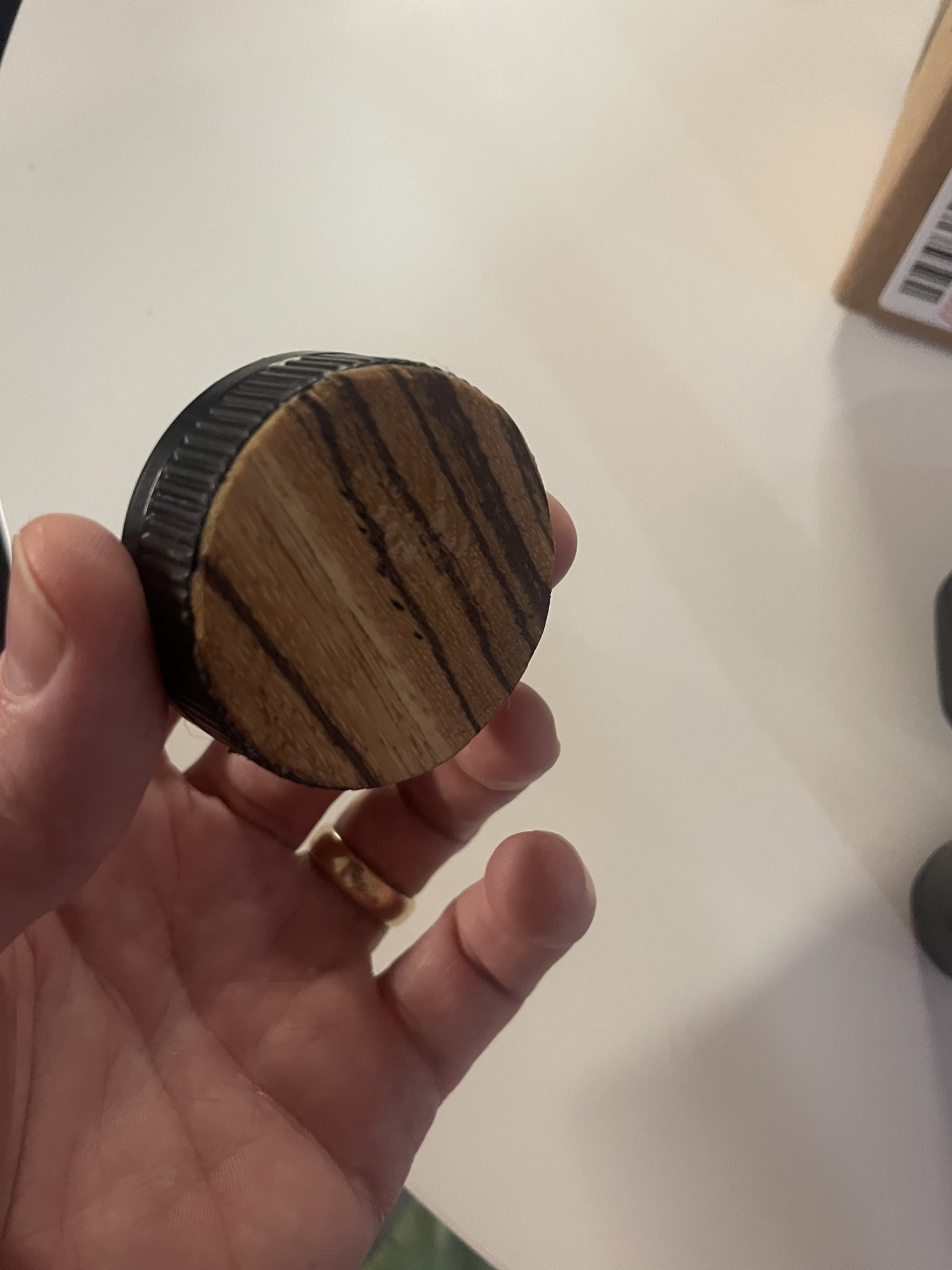

Full disclosure...............I cheated! Here!

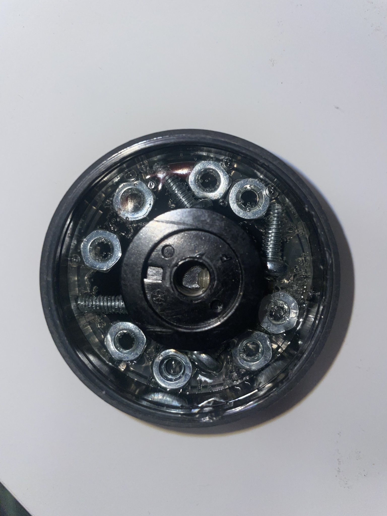

I thought it was a fair price for the the amount of time and effort for sourcing, bending, cutting, and potentially/unnecessarily screwing that part of it up. Fit and finish of the pieces/parts as arrived were fantastic. I did my best not to butcher my part. It was very easy to cut, drill (stepped bit for larger holes), counter sink and it is built like a tank. The bottom/top plate I had to cut length-wise to fit into the recess as it overlapped the width? I didn't like the look of just all aluminum top so I veneered with some scrap I had laying around. My cut was not perfect so there is just a slight gap but it allows some of the LED light from under the hood the shine through and I think that is cool? Volume knob is a "ribbed" juice bottle lid that I epoxied in a traditional volume knob. Drilled a small hole for the set screw access and epoxied in nuts and bolts to add weight. Added the matching veneer and now it almost looks legit.....don't tell anyone it is a cheap juice bottle lid!
Ed
