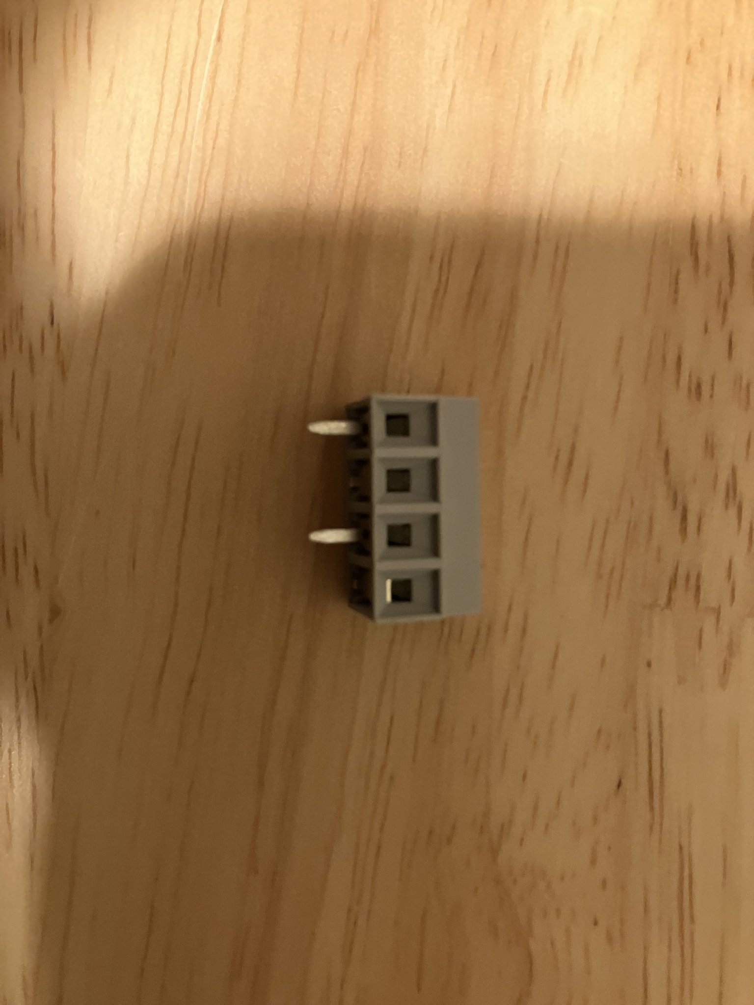

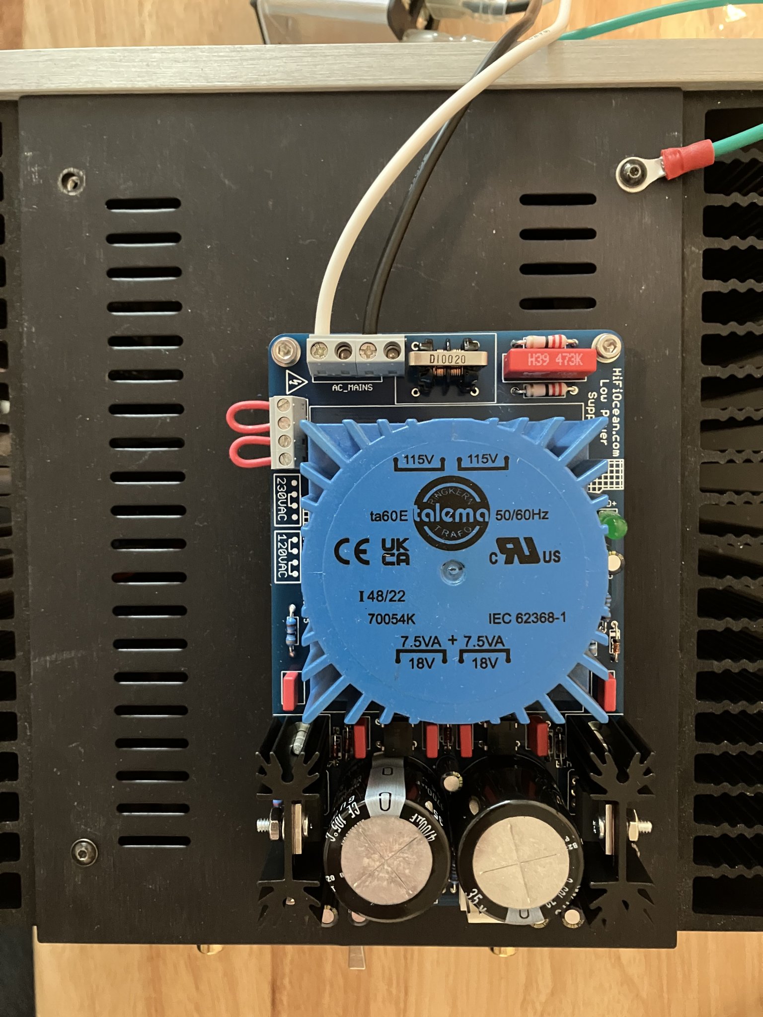

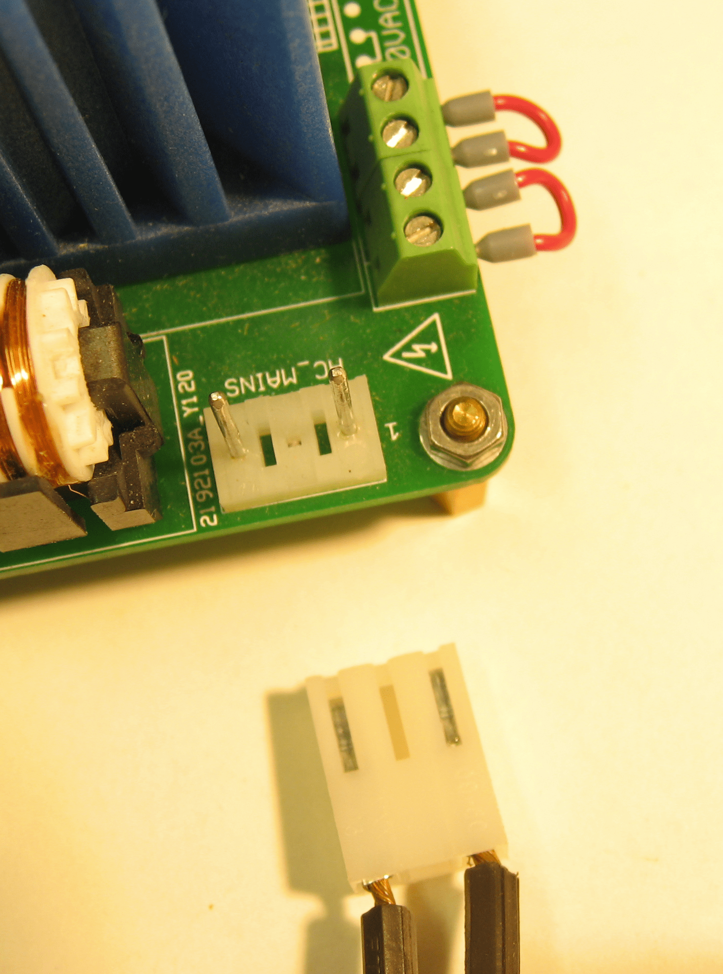

This should be self-explanatory:
It doesn't matter which pin in "N" and which is "L", either way is good. Three holes/pads on the board are to accommodate both 2x 3.96mm and 2x 5.08mm connectors, and the two overlapping pads on the right on your photo are (obviously) internally connected.
Do not omit/forget the jumpers that set the mains voltage. On this photo, two red jumpers set 120VAC. For 240VAC, there should be one jumper between the two middle contacts on the green (gray on your board) terminal block - the while silkscreen next to the terminal block, partially visible on your photo, shows the correct connection.
I moved on to finish up the amp board and forgot about the pin sockets for U1 and U21, I soldered them directly to the board. How much trouble is that going to cause?
I'm not an expert, but I would assume the bulb didn't light up because the PSU is low current, especially with no load. For the amp board, some might argue that directly soldered opamps are superior to sockets, you are fine to solder them directly to the board, but will have more difficulty in the future should you decide to try a different opamp.

The bulb lights up if the transformer's primary draws a large current. This usually indicates that the (power) amp draws lots of current from the secondary winding, or, in the case of a single flash on power-on, that the bulk filter capacitors are being charged. Unlike a power amp's, this power supply is (a) low current, as @bloqhed pointed out, and (b) doesn't have large inrush current because of the small (=relatively high impedance) transformer and the two filter resistors in the primary circuit. So the bulb would light up only if the primary winding is miswired, which is unlikely because it's all on the PCB.the led did light up, but the dim bulb never did
@bloqhed is right - nothing bad happens, just rolling opamps may be difficult. Desoldering an 8-pin package from a plated-through board is fairly easy with a hot air gun, but hard with a soldering iron.forgot about the pin sockets for U1 and U21

Thank you for the explanation @alexcp, I’ll leave things as is. I think I’ve spent almost as much in shipping costs as actual parts! Living and learning and enjoying this build.
