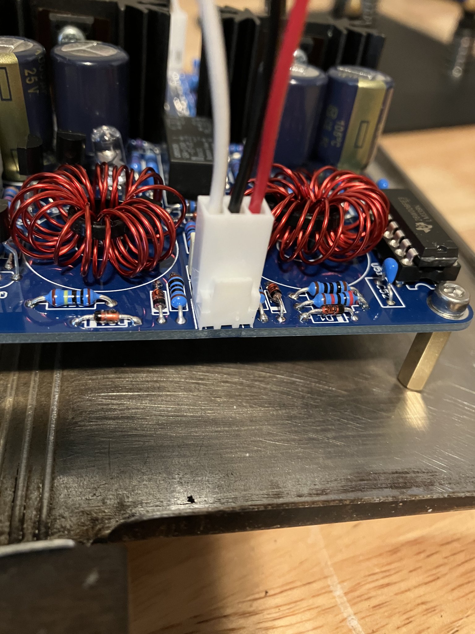

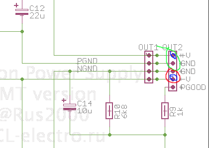

National Electrical Code doesn't apply here, so anyone can choose whatever colors. All wires of the same color would work, as would all the same color except first pin (V+). I use red for positive, white or blue for negative, black for ground, and green for PGOOD, but that's mostly driven by the colors of the wire I have at hand, as well as by the desire to minimize wiring errors when debugging, tweaking, and characterizing the board, which involves many plug-ins and plug-outs.
BTW Molex makes ready-to-use KK254 cable assemblies which might save you from some crimping - with all black wires.
That cable would have saved my finger tips!

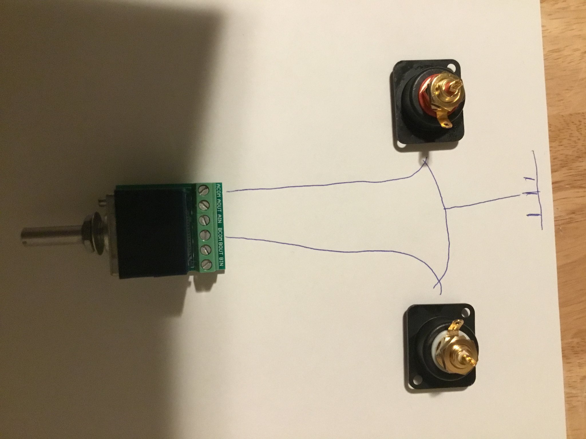

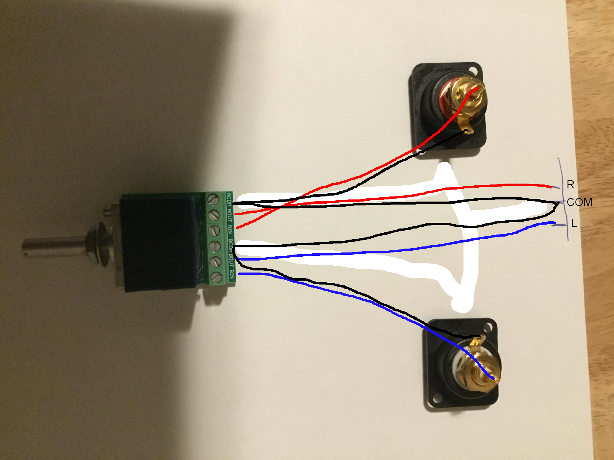

I do need some help on the volume pot wiring. I have the alps 10k with the breakout pcb. I think it goes like this.
ain = center pin from a rca
aout = right in on amp board
bin = center pin from b rca
bout = left in on amp board
Not sure about the a and b com.

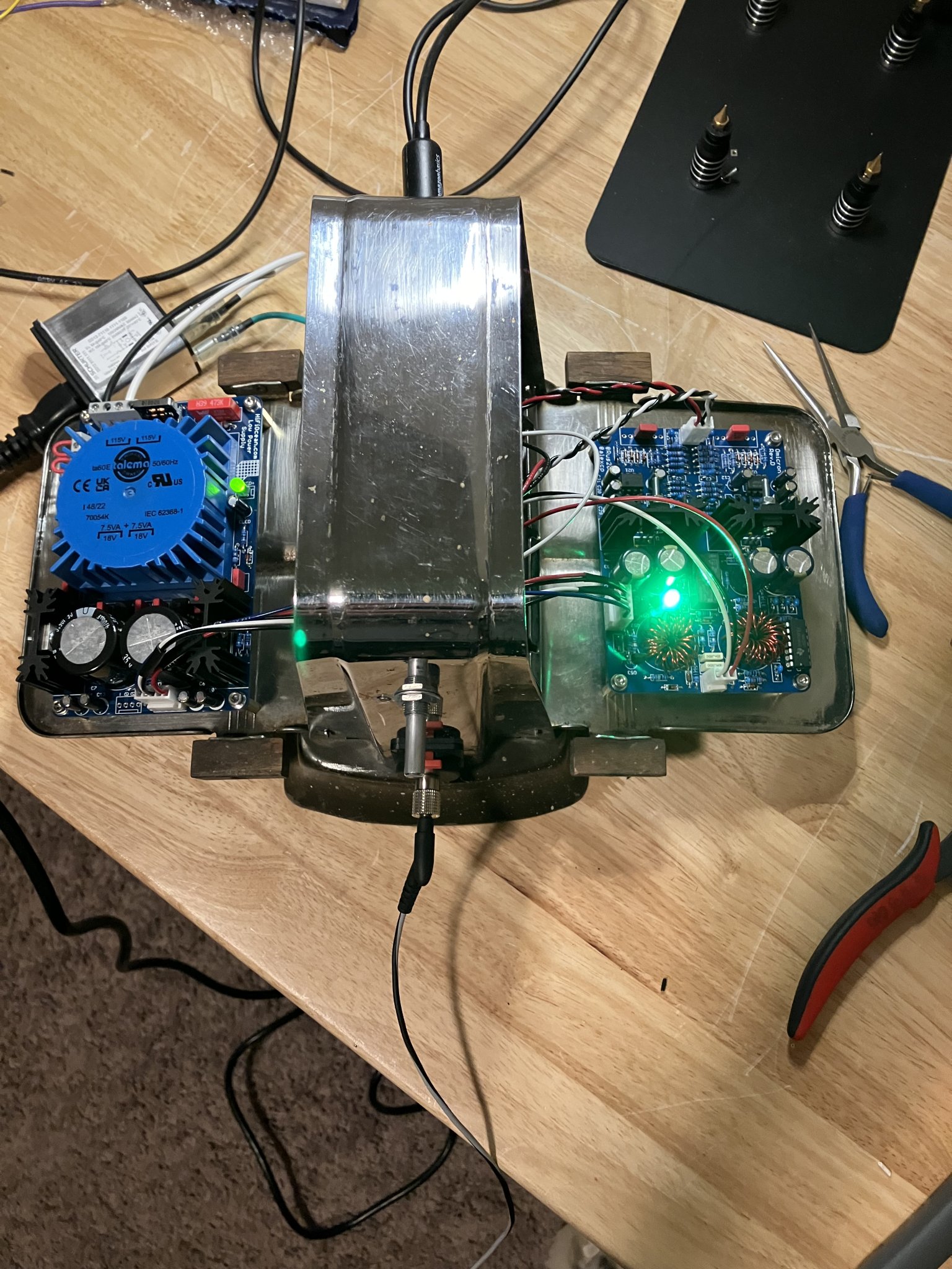

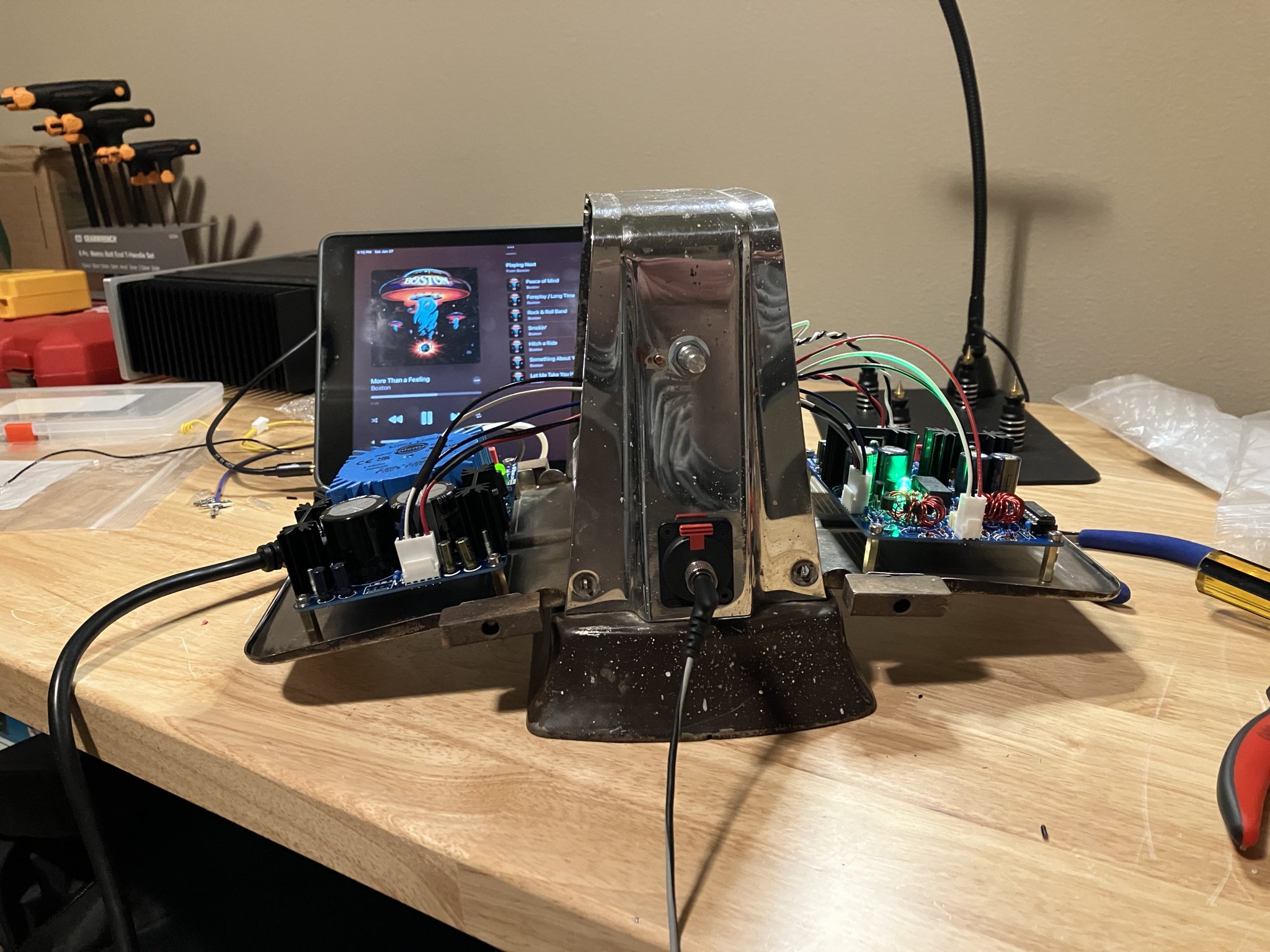

I thought this old $3 toaster would be a good chassis but it‘s not quite wide enough for the flaps to close. At least I know everything works and sounds great. I’ll clean up the wiring once I get a more permanent chassis. And I have to (get to) buy some decent headphones.
Thanks to @alexcp for this great project and all your help and @bloqhed too for jumping in with some much needed help.

I realize I’m not fully moved in and soldered to everything yet. What would cause a grounding hum, but goes away when the headphone jack ground is also grounded to the chassis? I have no other issues, everything works perfectly and sounds great. I’m using an old 1/4“ adapter I scrounged up, with some cheap earbud.
This is how it’s connected from the board to the headphone jack. White to TIP, black to GR, red to RI. I followed alexcp guide he posted above for the volume pot. I’ll try to work up a quick sketch, I must have missed something somewhere. I have a jumper wire from the jack ground to chassis and it’s totally quiet.
