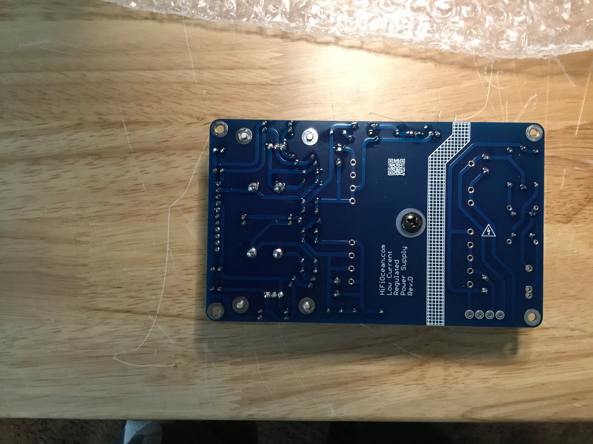

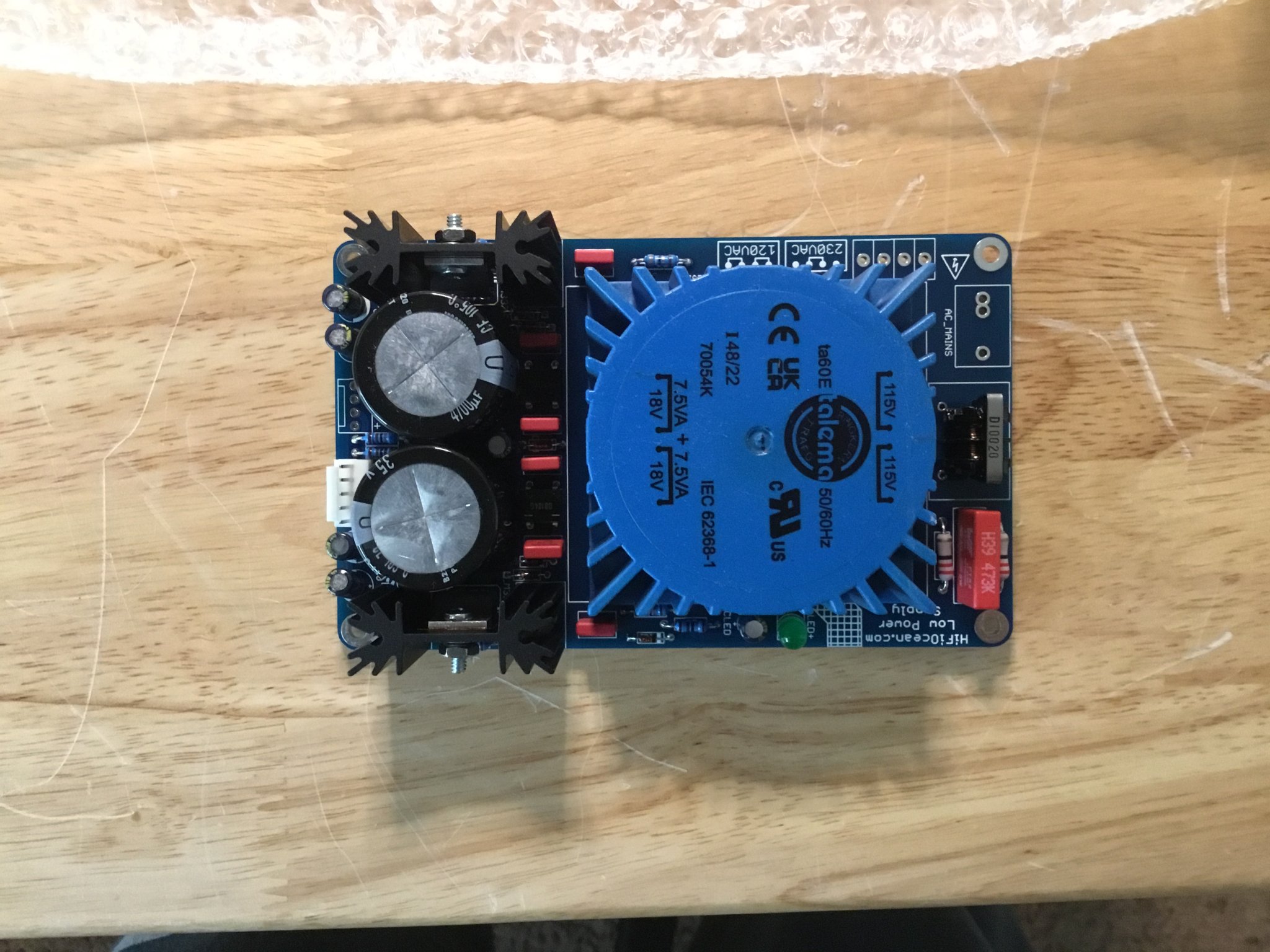

Is it best to screw down the transformer? I’m guessing yes because of the weight? Do I need to use a special washer? Anything between the board and the underside of the transformer?
I don't bother, but in principle, yes, you may want to screw it down to reduce the mechanical stress on the soldered pins. The board has a center hole for Talema/AMVECO 70054 or 70064. Just use an M4 metric screw of appropriate length, perhaps with a normal flat washer. I don't think any special hardware is needed.

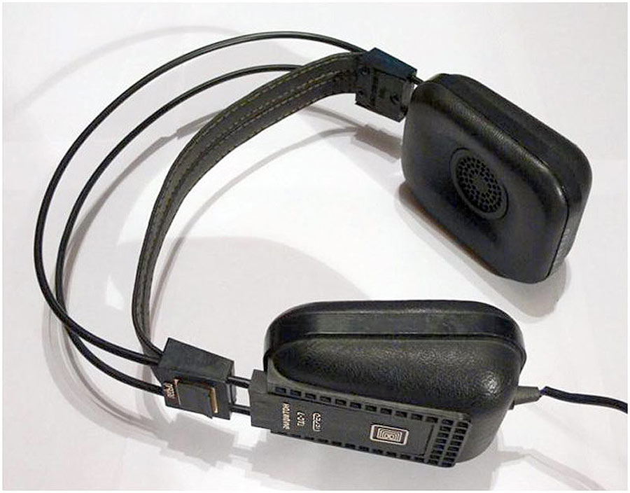

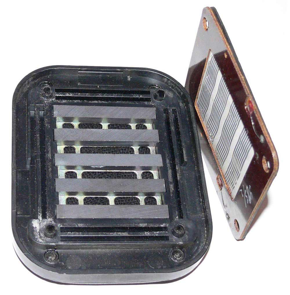

Having said that, I used to own these 8ohm, 91dB/mW planars back in the 1980s:

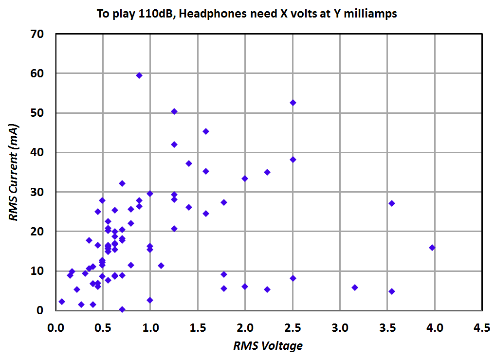

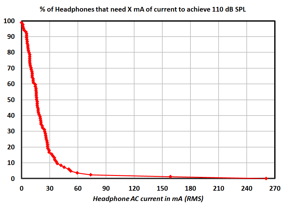

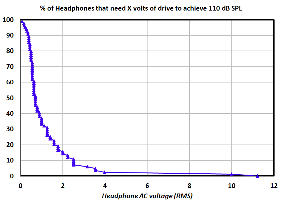

I extracted the data from (this article) and made a scatter plot and cumulative distribution plots. In my opinion, 110 dB Sound Pressure Level is very loud (too loud), but that's the reference he chose.
HOW TO READ THE PLOTS
The red curve passes through the point (30mA on the horizontal axis) , (17% on the vertical axis). This means 17% of all headphones in the survey, required 30mA RMS or more, to play at 110 dB SPL. Therefore it also means that 83% of all headphones required 30mA or less, to play at 110 db SPL.
The blue curve passes through the point (2V on the horizontal axis) , (14% on the vertical axis). This means 14% of all headphones in the survey, required 2V RMS or more, to play at 110 dB SPL. Therefore it also means that 86% of all headphones required 2V RMS or less, to play at 110 dB SPL.
I prefer this approach because it completely discards the unhelpful datasheet specifications named "impedance" and "sensitivity". Instead it focuses upon exactly those quantities a headphone amplifier designer cares about: output voltage and output current.

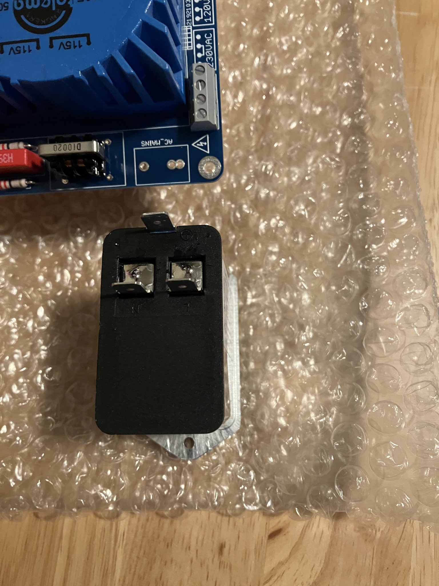

Hey Alex, do you have a part number for the 4 position ac voltage selector? I ordered some phoenix terminal blocks, 277-1238-ND but the pin separation distance is too wide. I can’t seem to figure out how to find one with the correct spacing.
This one from Phoenix should work, and there are quite a few suitable parts with 3.81mm pitch (obviously you'd need one 4-position or two 2-position).
No real reason. Even though I had the Omicron chassis machined, I recall not having much material left after drilling/sawing one manually, so this time I tried the external fuse. I think if I redid the build I would go for an IEC inlet with fuse, convenient as you point out, but not sure of any differences in noise performance.
