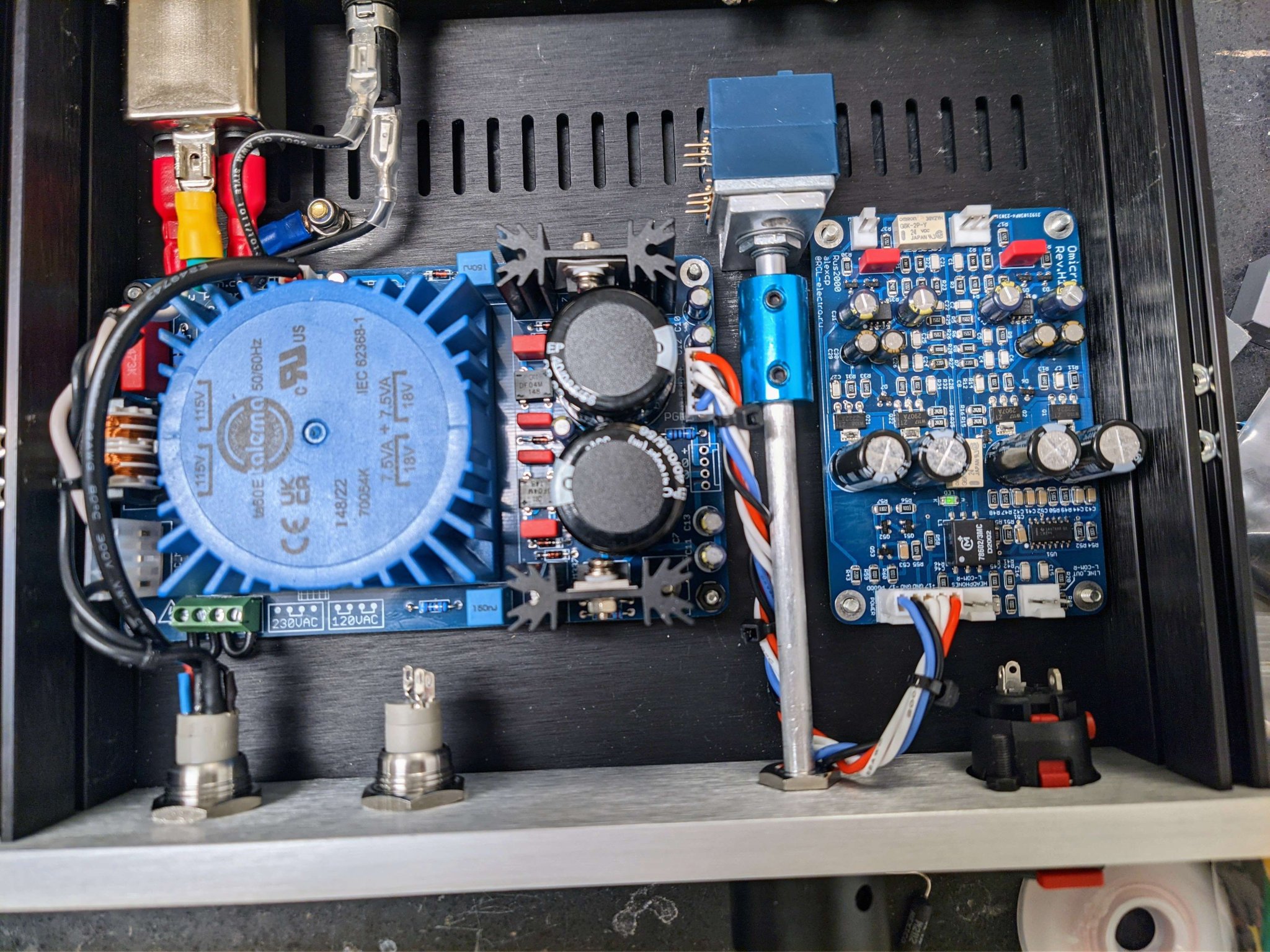

Both boards show the same thing. Here's some pictures so you can see what I am working with. It seems the problem is with the comparator, with both boards behaving the same way I guess it will be the same problem on both.

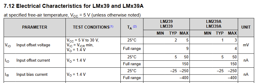

Since the LM339 has PNP inputs, the output will be active LOW if any of the inverting inputs float.
and the relay does not turn ON.
Isn't the 4th pin of U51 LM339 floating?
If pin 4 floats, the non-inverting input, pin 5, will have a bias current that can pull up the 3mV output offset to 8mV.

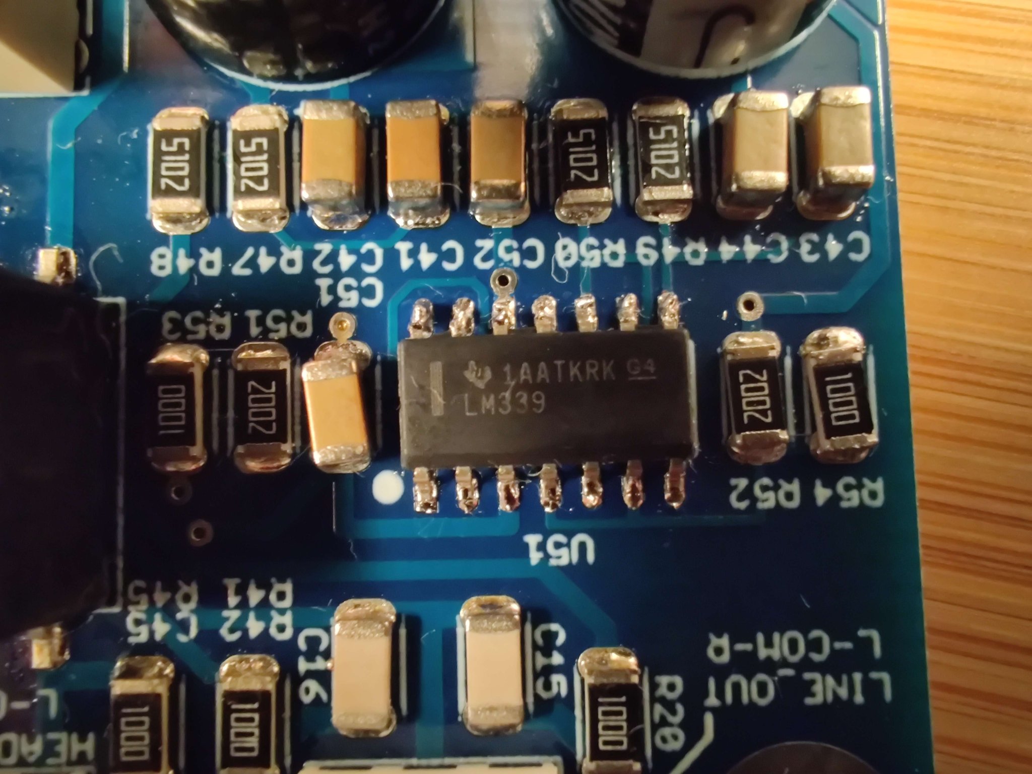

Looking at the photo of #244, the LM339 looks a little slanted. Also, the size of the footprint resist is for reflow and seems small for hand soldering.
Maybe - I noticed the difference, too, but it is hard to see from the photo taken at an angle. However, if it was the case, connecting 10kOhm across R55 would not switch on the relay, as the gate of Q51 would be driven to -17V by the comparator. So my conclusion is that the comparator is wired, and working, correctly.

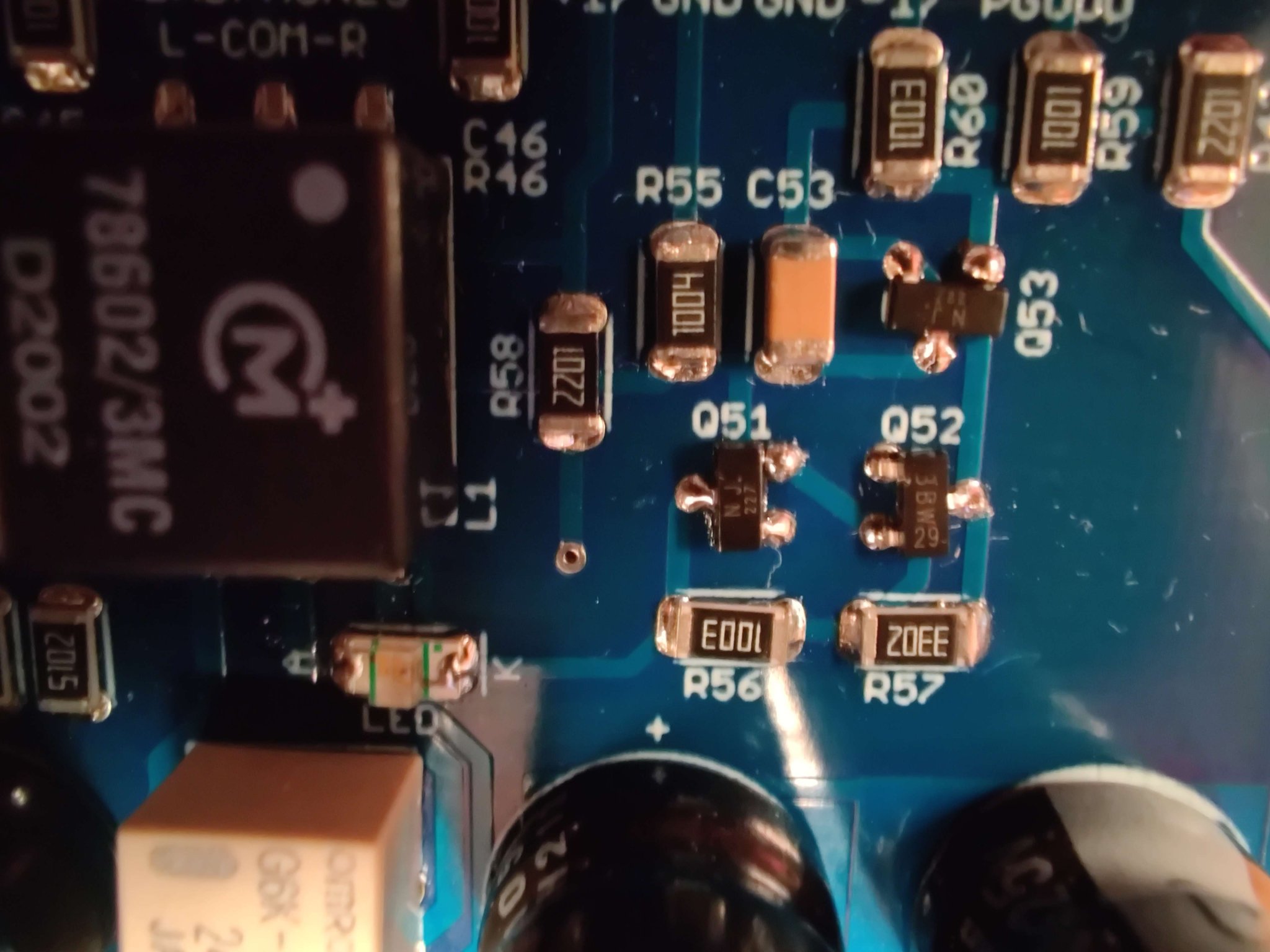

Here's as close up of a picture as I could get of the area around Q53 and R55 after cleaning it up.
@mason_f8 the board was soldered with a hot plate and paste as opposed to hand solder. Here's a picture of the comparator close up too. I wet each pin and re-cleaned prior to taking the picture and testing.
@alexcp same behavior following cleanup and a precautionary wetting of R55 and Q53. I was able to find a steadier hand in placing 10k ohms across R55, the LED stays on, but the relay buzzes as if it's opening and closing quickly, if the LED is blinking I can't tell or it's too rapid. Not sure if that is expected when performing that test but thought I would update.
The lower end of C53 (the one pointing to Q51 Q52) on the photo above appears not to be soldered to the pad under it. Same may be the case with C51 and C52. It is sometimes difficult to solder a taller component like a 1uF capacitor, as solder remains on the capacitor only and does not flow to the pad under it.
